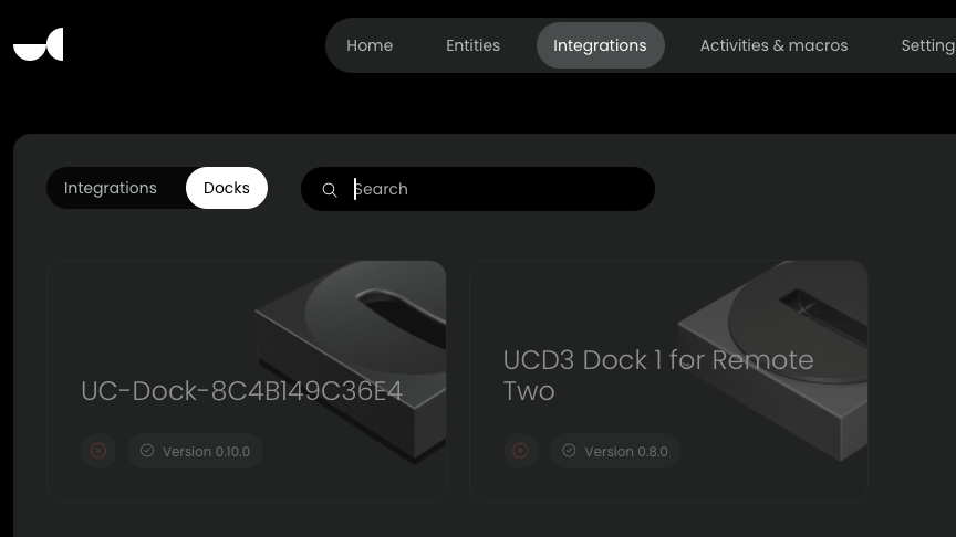

Extender or blaster must be add while the dock is disconnected from power. Did you do that? Do you see the extender or blaster is you open web configurator, integration and docks and then click on the dock. You should see here what is connected.
Hi Ralf, Thanks for the advice and suggestion it is greatly appreciated!
I’m a little red faced here no I did not do that at all times during my learning period. I did do that when first setting up the dock and remote as per the instructions, but at one point I swapped the blasters over between port 1 and port 2 as a fault finding exercise forgetting about the power off requirement - doh!. Following your guidance I checked for the dock on the configurator and can confirm that the dock now only sees the little IR blaster now, not the main one. Swapping ports over did however confirm that it does however recognise which port I connect it to (Power off during the swap overs of course!) so it would appear that the self induced fault lies with the blaster and not the dock (hopefully). Do you know if any 3.5mm IR Blaster is a suitable replacement or is it specific to Unfolded Circle in which case I’ll need to reach out to them to purchase a replacement from them direct, however long that might take?

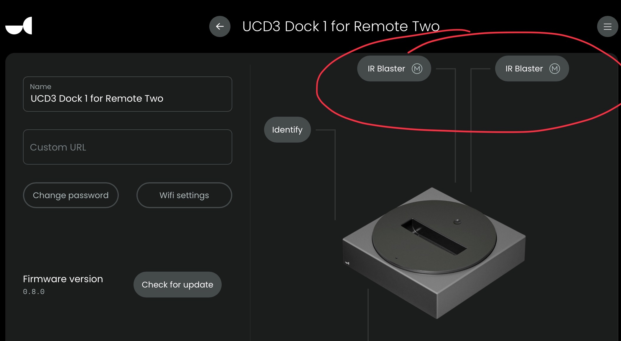

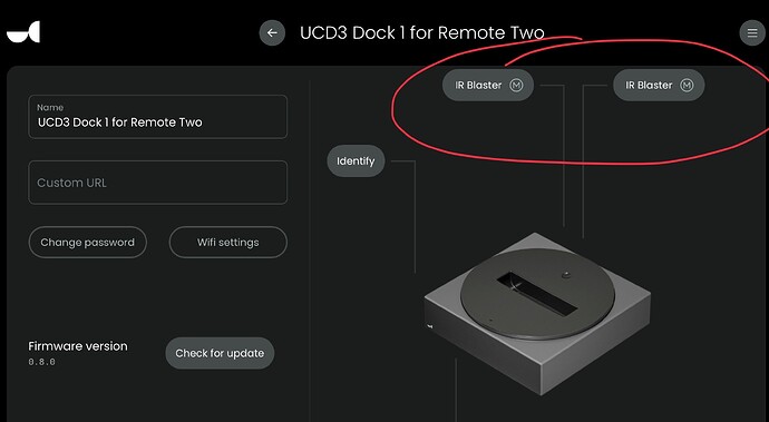

Just to confirm. Is the issue with the IR extenders (the little „eyes“) or the IR blaster (the bigger puck)? As mention by @HarmonyFan, the extenders and the blaster must be connected while the dock is powered off. In the web configurator you can see what is connected to which port of the dock:

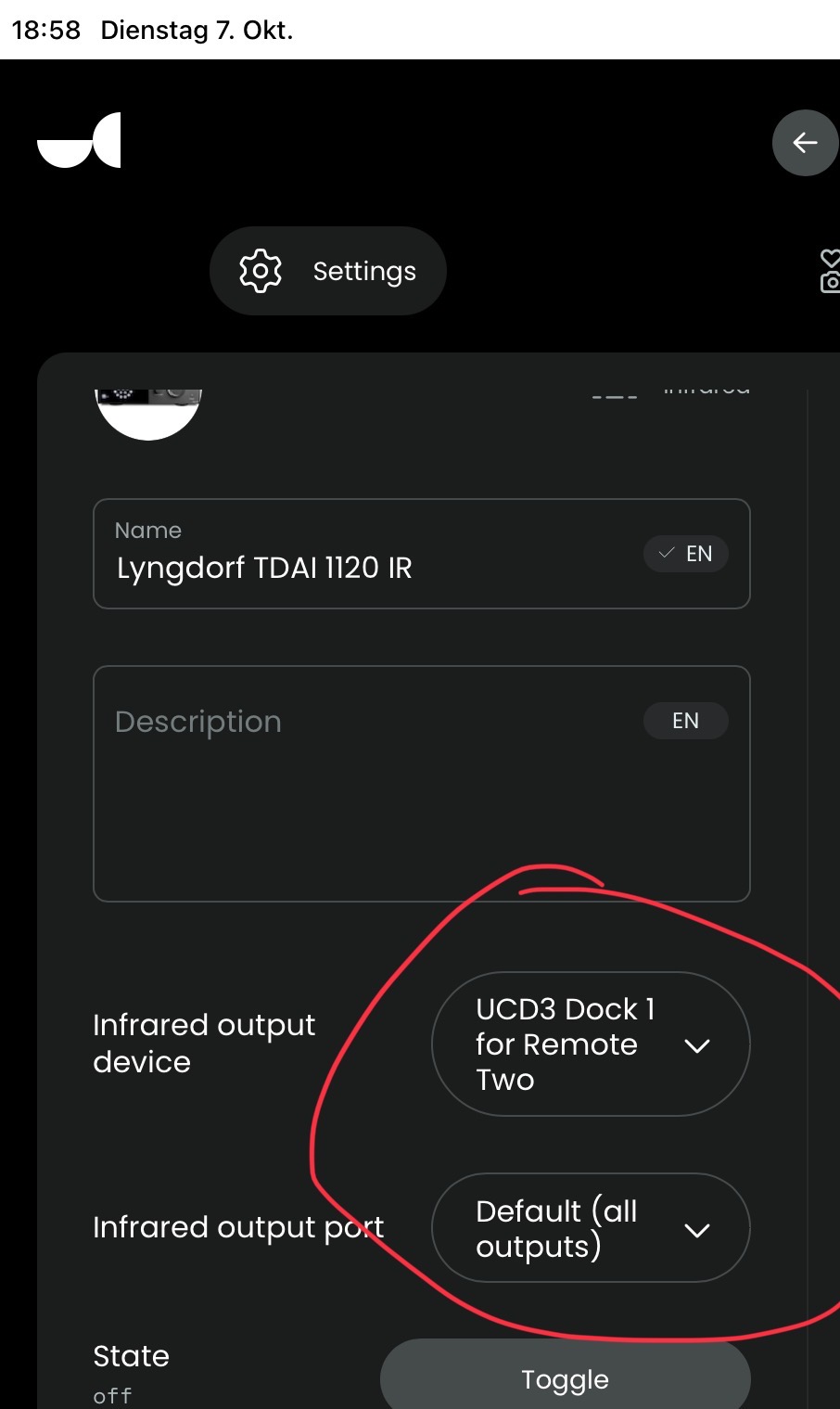

Once that is done, you need to specify for each IR entity which IR outputs should be usedall, dock only, blaster only etc.):

Thanks it did help verify my understanding. It appears to be the puck (the larger of the two wired blasters) which is now not working as it’s not recognised by the dock as being connected. I expect it was my error in unplugging and reconnecting while the dock still had power connected. Lesson learned!

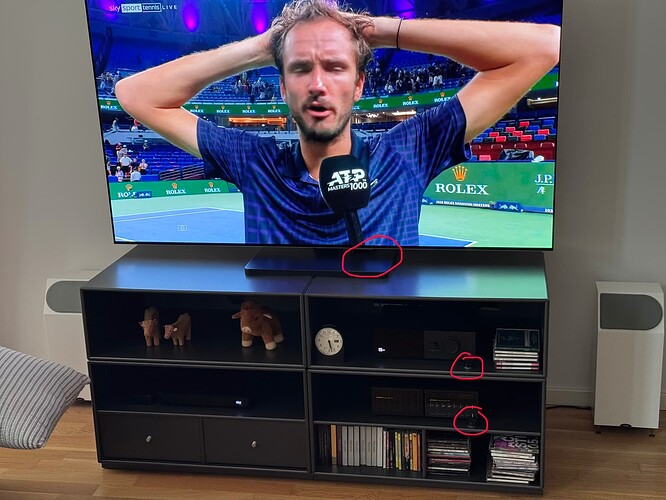

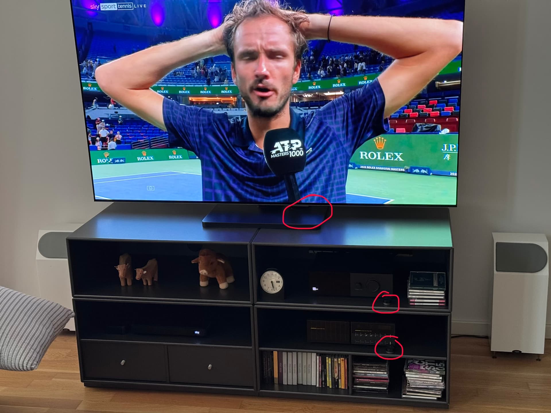

Sure, that is possible. I also have two docks and use one exclusively for charging and the other one is close to the devices (with two blasters attached) that I want to reach via IR.
Depending on where the devices are in the cabinet and how many you have, you will have to play around with the extenders and blasters. The extenders are designed to be really close to the IR receiver of a device while the blaster (as the name suggests) blasts the IR signal in various directions and longer distances. Maybe one blaster is enough for the entire cabinet or try a combination of extenders and blasters. And the dock itself can send IR signals as well, of course. Just make sure, you define the IR outputs (dock, extenders, blaster or a cominbation of them or all) in the settings of the IR devices.
EDIT: My set-up below. The dock is behind the screen on the TV stand and the two blasters are next to the amplifier and CD player. All devices (including the Sky receiver) on the lower left hand side work perfectly with IR. The main reason for this set-up is my over 30 year old CD player which is very fidgety when it comes to IR reception. The other devices would easily be reachable from the second dock (and a blaster) which is on the other side of the room.
