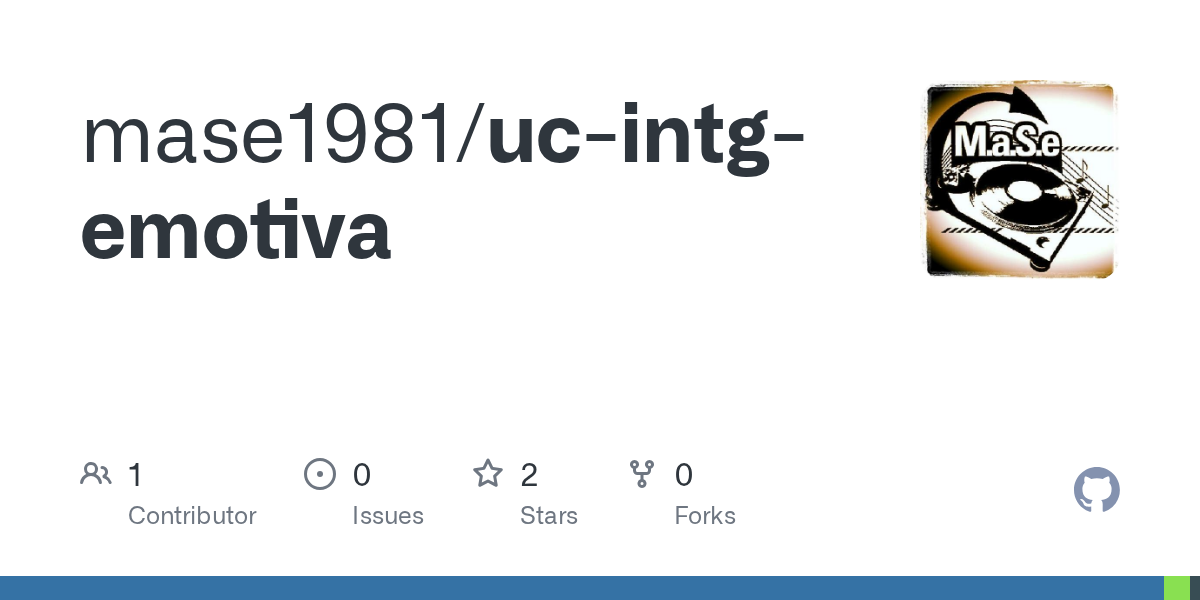

I just downloaded the Emotiva-integration from Github and it was installed without any problem.
Here’s the link:
Klick at v.1.0.8 on “Downloads” (left mouse) and after that klick on the .tar.gz file (left mouse).
Download (save) it and let it as it is.
In Web configurator add it as “own integration”.
