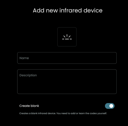

I’m happy to receive my Remote 3 last week and now I’m trying to configure it by the web configurator. Dock 3 and remote are in the same WiFi, that was easy to manage. Now I’m trying to learn commands for two devices, that are not in the manufacturers list (VU+ Duo/Pannde 670). I have read that I have to press “create blank” and to copy the commands from the original remotes via the dock. Sounds easy, but I can’t press “create blank” because the button is not active. What could be the problem for this? Any ideas what to do?

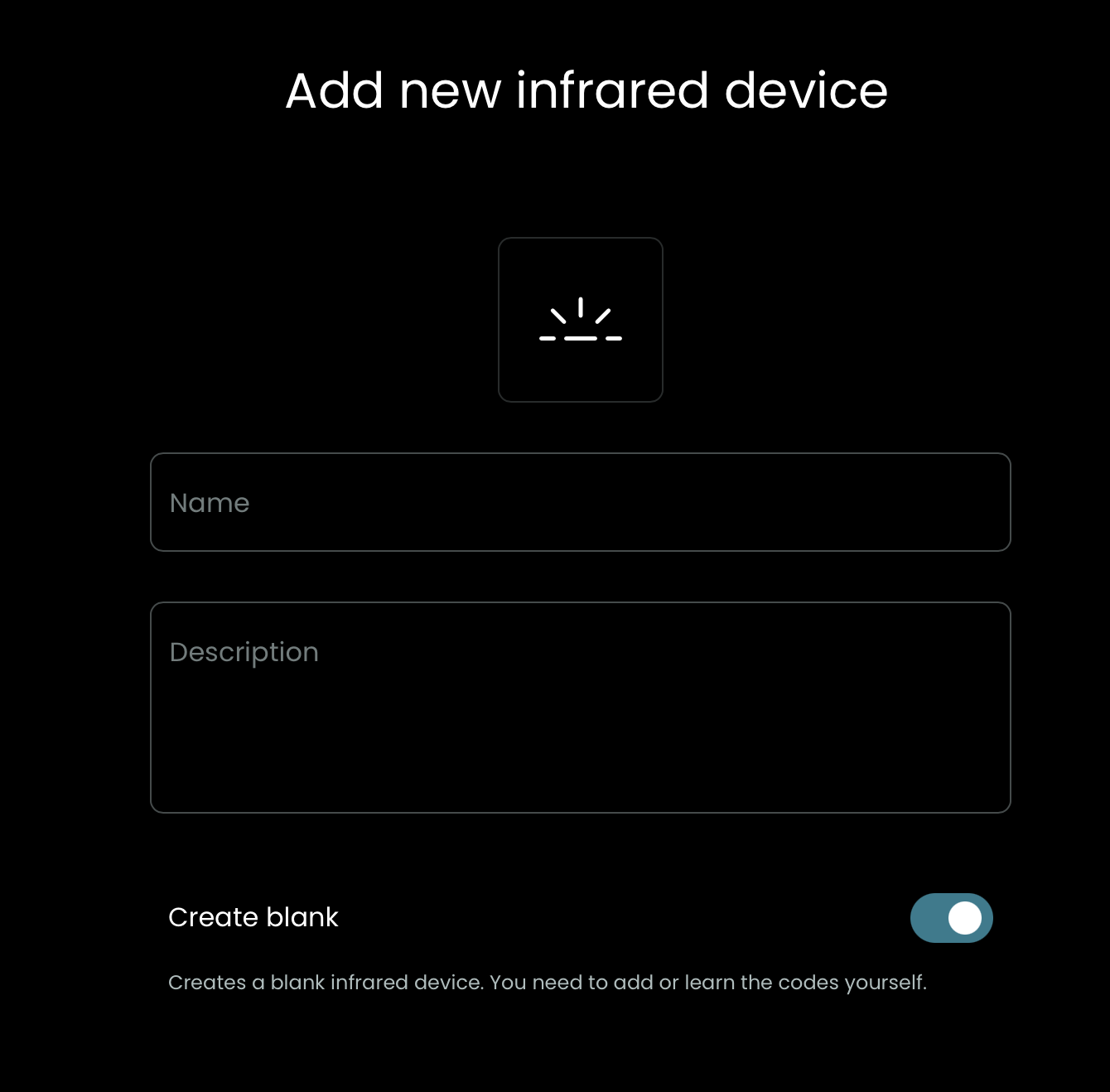

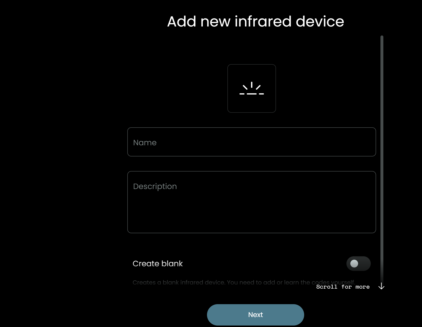

I can reproduce this if I reduce the size of the browser window to a very specific size where the scroll bar has just appeared. Then you’re not able to activate this option even when scrolling down. This is something you can report as a bug on GitHub or via mail to the support.
Unbelievable, that was actually the reason for the error. If I reduce it from 100% to 90%, the checkbox works and everything is fine.

Scrolling doesn’t work in this case. The scroll bar just moves to the top automatically if you scroll down. But it’s just like that with that very specific vertical size of the browser window. Making it just a little bit lager and it works again. And e.g. dropdows like in the Bluetooth menu are not affected.
