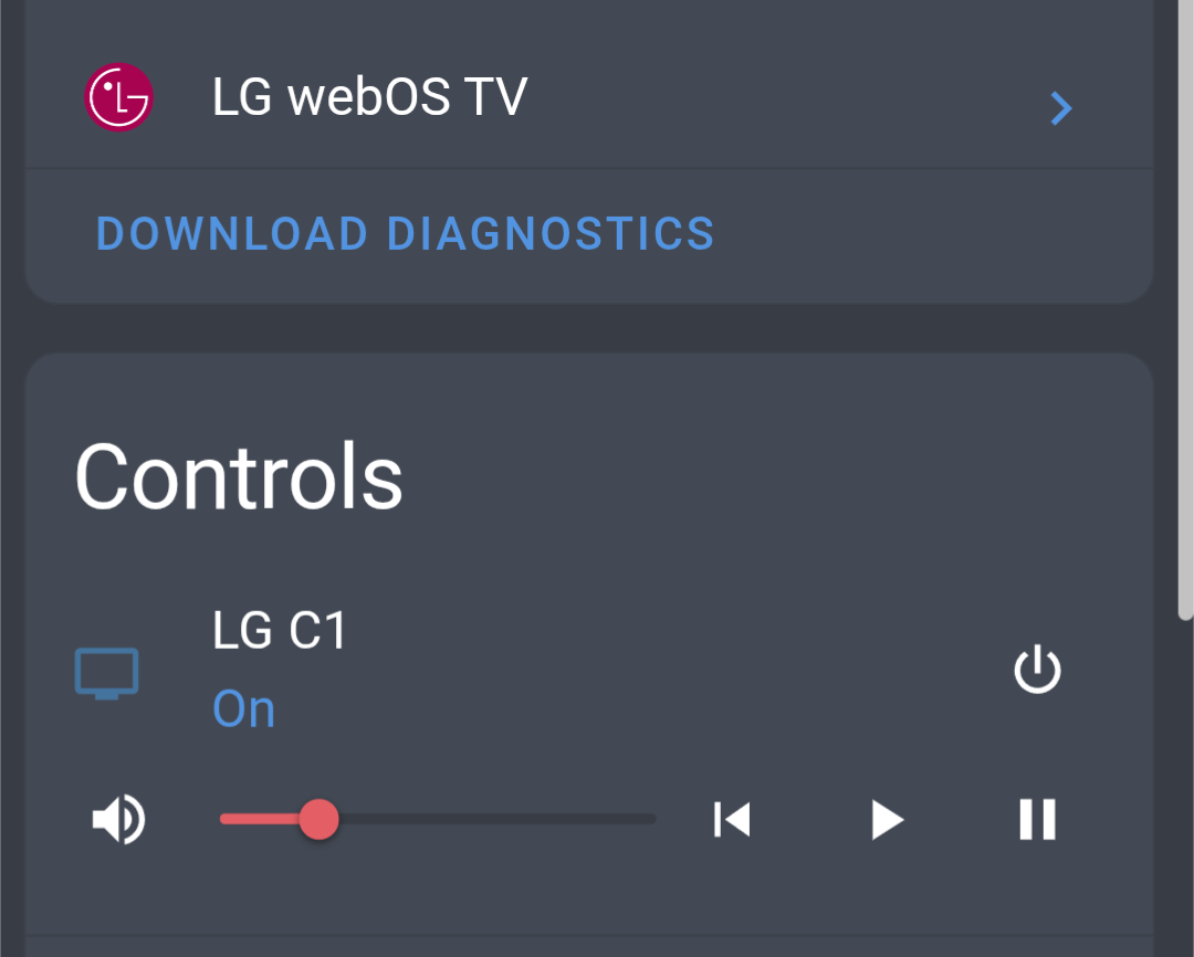

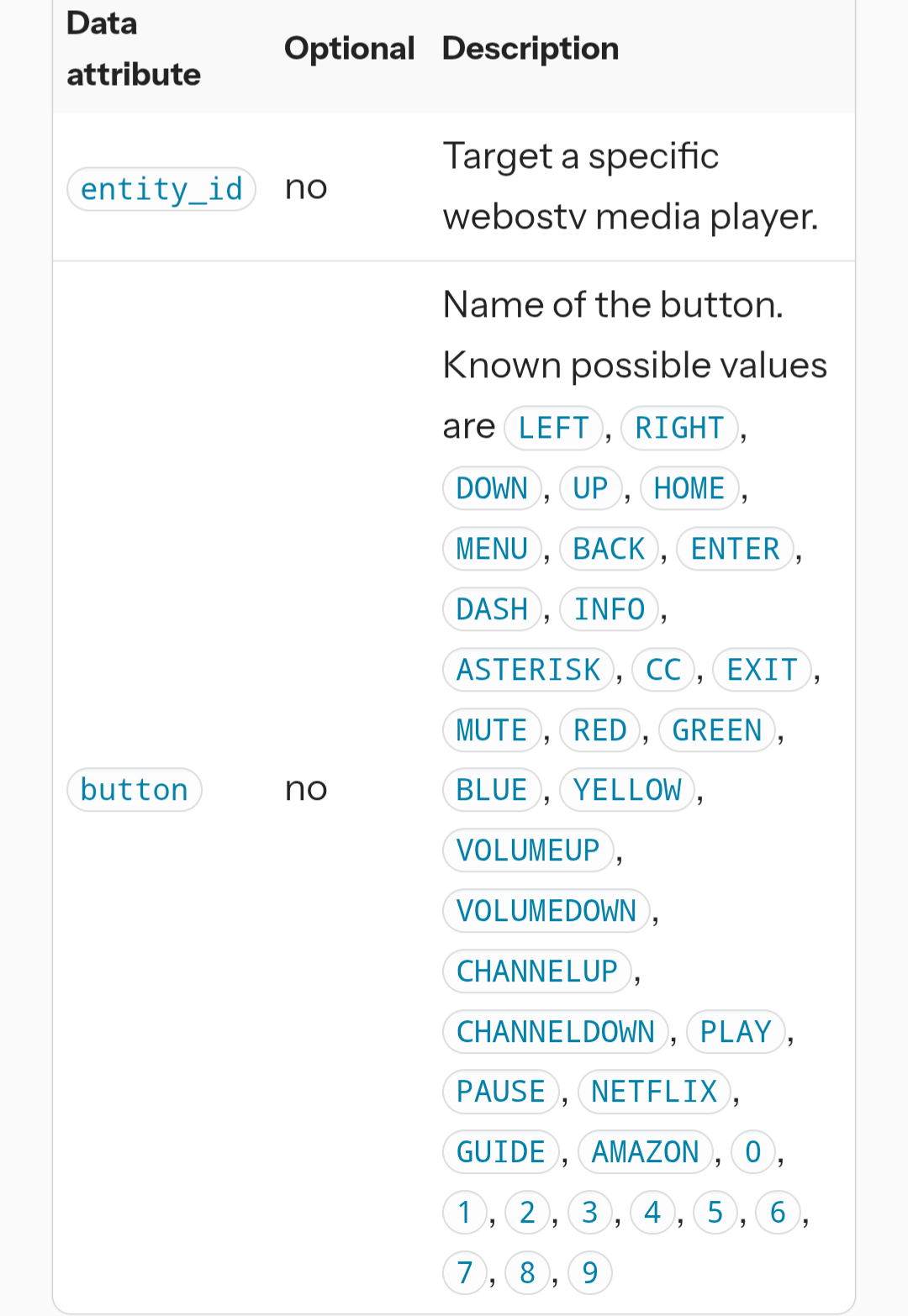

If you’re using Home Assistant I recommend installing the LG WebOS integration. It may not be auto discovered so go to HA settings, devices and integrations and add it manually following the link below. You can slowly move towards it. Better if using Ethernet for latency for not required. Just create some simple scripts for the various commands. It also has a notify service for text based notifications and announcements which I personally like and it also supports WOL.
