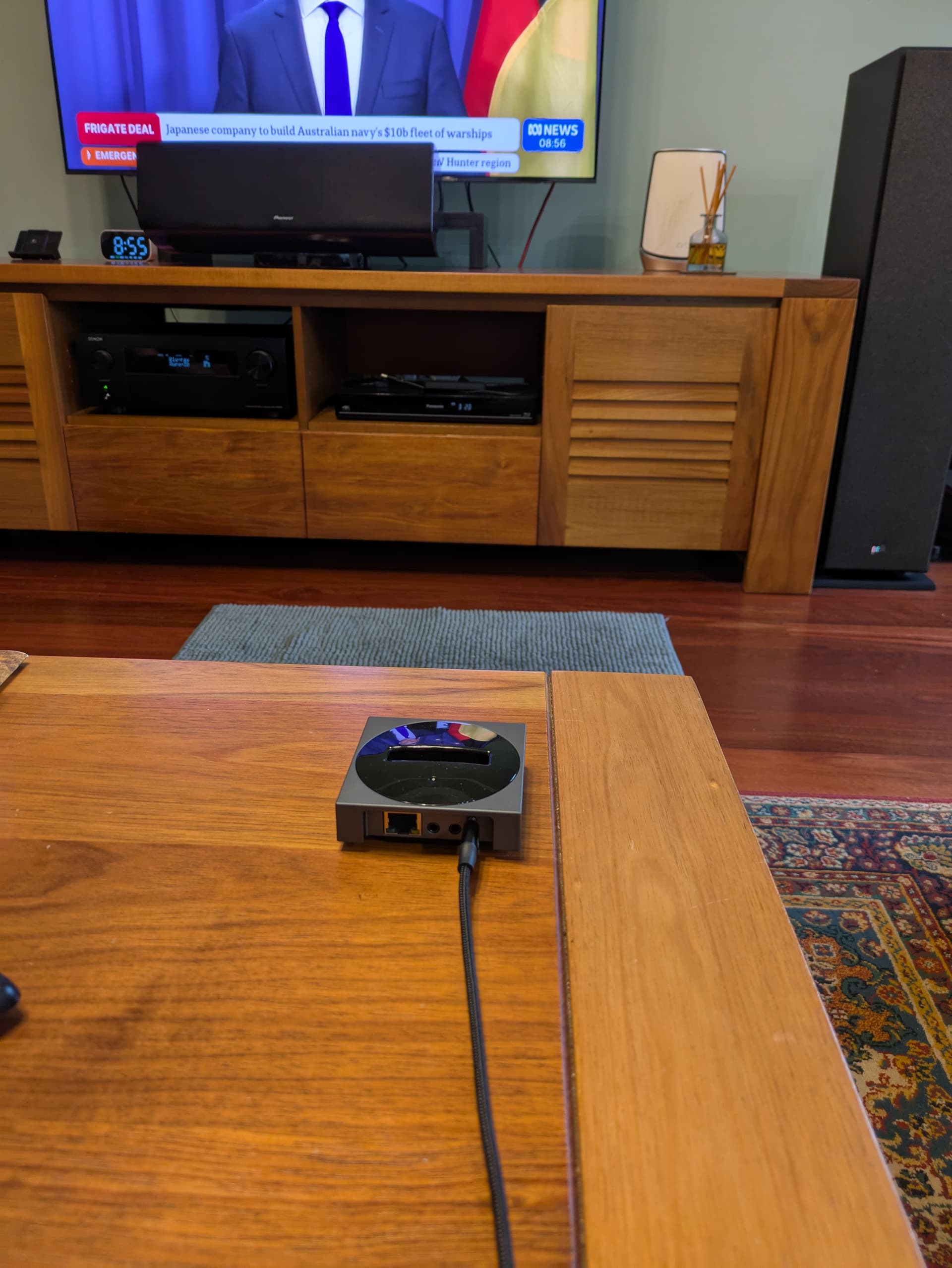

At least the log show that the Watch TV activity has been turned off. Can you check if the activity is shown as off? Maybe it’s just the actvity ui that is not closed automatically
The activity does show as OFF after clicking the PWR button while in the activity. However, everything remains on, I guess due to missing or unreceived/untransmitted IR codes… Then when I tap the Watch TV activity (now showing as OFF), the activity runs the ON sequence again (since it’s in OFF state, but remember that everything is still ON). The devices of course then turn OFF. This of course does make sense since the commands are simple POWER_TOGGLE commands. No distinct ON or OFF commands. SO the ON and the OFF sequences are identical. Now the activity is in the ON state, but the devices are OFF! LOL
After a bit of further testing, it appears to be missing or unreliable IR transmissions from the Dock3, which is about 10 feet away from the equipment, free line of site, no obstructions. I even tried moving the dock and/or blaster closer and closer, or holding it up at eye leve to the devices…
I have also tried setting the entity (device) to just use the dock to transmit, and as well setting it to all devices to transmit. Plugged in the little IR blaster, as well as enabling the Remote 3 as an IR blaster itself also. Doesn’t seem to make any difference in the reliability and the behavior.
I doubled up the POWER_TOGGLE commands on the TV and the receiver for both ON and OFF sequences, and put a small delay in between the two devices just to make sure there aren’t too many IR beams bouncing around.
Now with the doubled up POWER_TOGGLE commands, tapping the activity on the remote “mostly” consistently turns on the devices. As for clicking the power button while in the activity, sometimes it works, and sometimes it doesn’t. Sometimes it will turn one device off but no the other. Sometimes it does nothing to either device. But the Activity does change to OFF. When I tap activity again it of course re-runs the ON sequence (because the activity did change to OFF. And remember that it is identical to the OFF sequence due to POWER_TOGGLE, not distinct ON and OFF commands). This of course then causes inconsitent states between what the remote says, and what state the devices are actually in – Remote now says Activity is ON, but devices are OFF… Oy…
All codes have been learned from the original remotes.
Wow, bit of a vicious circle. So the entire thing seems to be pointing to unreliable IR transmission performance, which then causes inconsitencies of state between remote and what is actually reality.
Sorry for the long post but I hope it is clear at least.
Any ideas or suggestions?

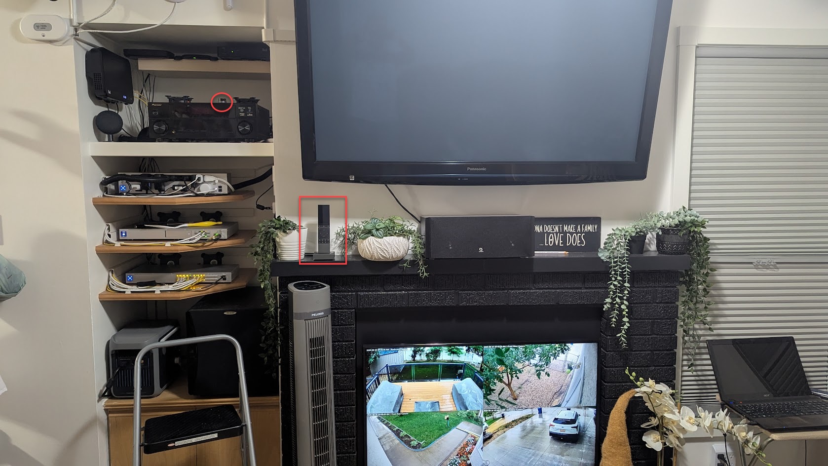

Slaids, I just read your other post, thanks for the info. It seems the issues are “mostly” due to IR. As for the missing IR commands like you mentioned, I haven’t done the camera trick to troubleshoot that yet. But given the experience so far, that seems to also add to the performance inconsistencies.
Kenny’s guideance was also helpful, pointing out that the blasters are not “plug and play”. They need to be plugged in BEFORE the dock is powered up. So that helped as well.
I have now relocared the dock and blaster as in the photo below:
The blaster is where the circle is. I was using the remote’s internal IR blaster too, but I have since turned that off so as not to introduce too many variables in the troubleshooting.
This setup appears to work faily well at the moment. Every so often a button press goes missing. Almost seems like it takes a click or a tap to get the remote to talk to the dock.
I have even managed to get my ARRIS VIP5662W Bell IPTV set top box to work. It uses the PRONTO code format for the IR commands, which seemingly can NOT be learned. You have to paste the codes in.
So here is a summary of what I have done:
  1. Relocate dock and blaster as in the picture.
  2. Turned off the remote’s IR.
  3. Doubled up on the power toggle commands for the TV (the upper one) and the receiver (under the blaster) in both the ON nad OFF sequences for the activity. I did this because of what I mentioned earlier - that it seems it takes a tap/click/command or two for the remote to reconnect to the dock. I suspected this when the TV and the receiver would take turned to turn off and on! So the first command in the sequence went missing, but the second command worked. Bit of a strange behavior….
  4. When creating an entity, in the main settings of that entity, I selected to use ALL outputs to blast the IR out.
  5. I added some quick commands in the user interface of the activity, and of each device, in case a command is missed - such as a device didn’t get powered on/off, or an HDMI input didn’t get set properly.
  6. TIP: Just to help others, remember that the user interface settings (touch screen configs) and button mappings that you configure inside of an activity only work when you are inside that activity or device.
  7. TIP: After making a config change (especially when adding IR codes), give the remote a few minutes to update and settle down, especially if you get the “unknown network error occured” but it looks like the config still took. Maybe even go back in on the change you did and then exit it again.
