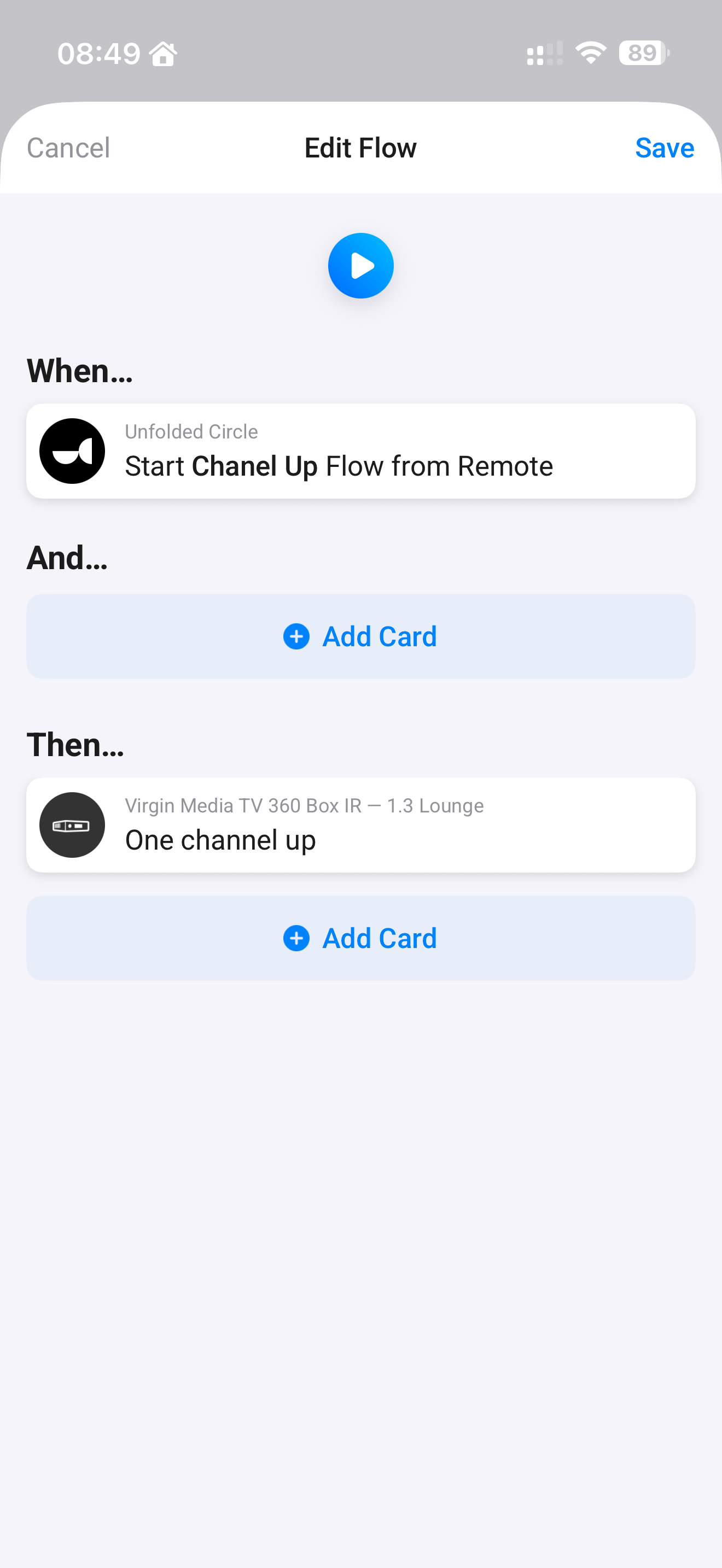

I’ve setup the Unfolded app in Homey and I can get my devices added, all works fine.
Homey IR devices aren’t recognised as devices. why would I use them? Well the remote 3 doesn’t have my device in its IR database, I’ve search and downloaded from the Global Cache database, but just doesn’t seem to work.
So using a Flow, just can’t get them to work at all. I create a flow with “channel up” and”channel down”. So I have a “when” card with “channel up” and that fires the IR device channel up (image) Doesn’t appear in the remote. I’ve restarted the remote, restarted Homey, removed the integration and app and added again. I’ve waited overnight, nothing.
Anyone have any ideas? Am I doing this wrong?

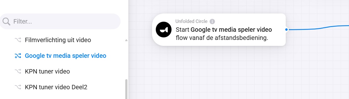

Does it help as the flow has the same name as the “start…….flow from remote”? In your case Channel Up? Like my example.
OK, I think I worked it out.
You don’t need that same name, but it does have to be an advanced flow!
Thanks very much for the pointer! The screenshot pushed me towards the right answer.
