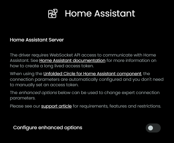

Marton posted this on Discord for this issue: “Web configurator/Integrations/Home Assistant then click on Start setup. Then you’ll be able to enter a new URL. If you leave the token input empty it will use the one you’ve already provided.”
@fbutler thank you for your response. I did try that, but see where to enter a new URL. This is what I see when selecting ‘Start setup’:

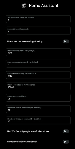

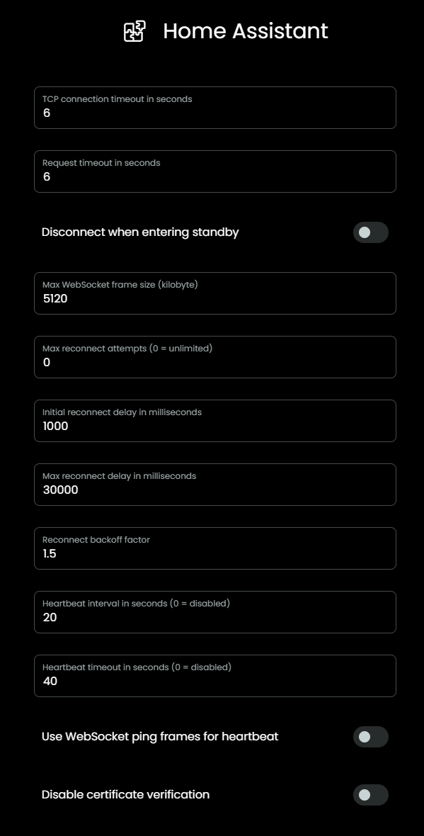

Turning on Configure Enhanced Options and clicking Next shows the following options:
I can’t see anywhere to provide the updated IP address

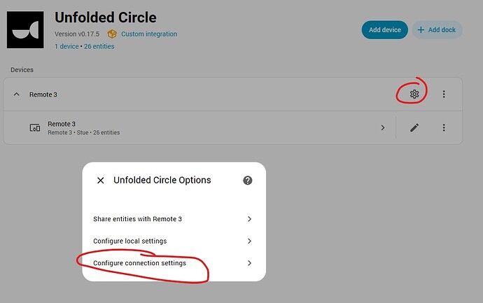

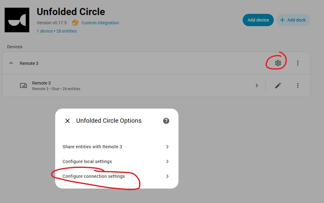

Change it at Home Assistant side - you might have to run the config again on your remote to pick the change up afterwards.
Thanks @TheWall. Updating it there worked. Thank you so much for your help.
