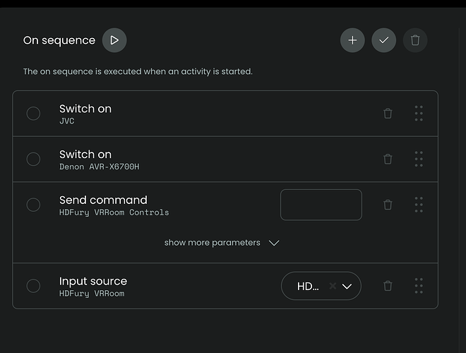

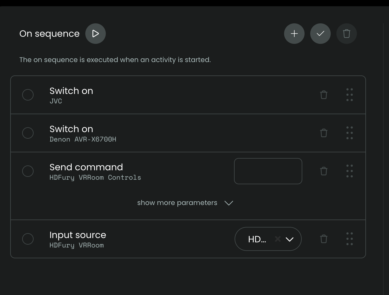

You need to add the entities into your activity, then set the sequence you want, add a delay between as the remote blast all commands at the same time and since it’s different devices a delay might be needed. Share screenshots, to confirm.
The only thing I want to have it do is change the input on the HDFury. Like switch to 0, 1, 2 3. Do I need both of them in the sequence? I think that is where I am confused, because when I add the HD Fury Vrroom Controls, there is nothing in that box, so I do not know how to send the command to switch the input…?
Remove step 3, it’s empty and not needed. Replace it with a delay step. Then click on the play button to execute the sequence, download the logs and share.

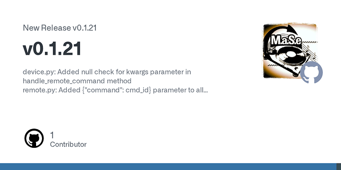

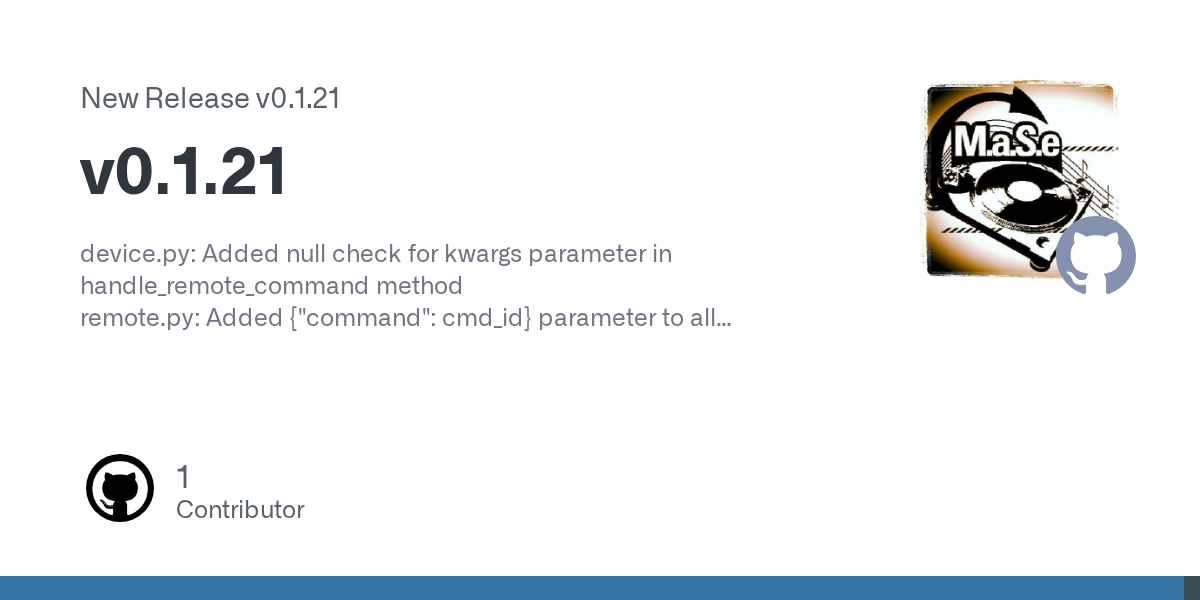

New version 1.0.21 is out
You did it! That new version fixed my issue. Many thanks!!!

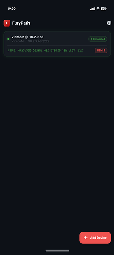

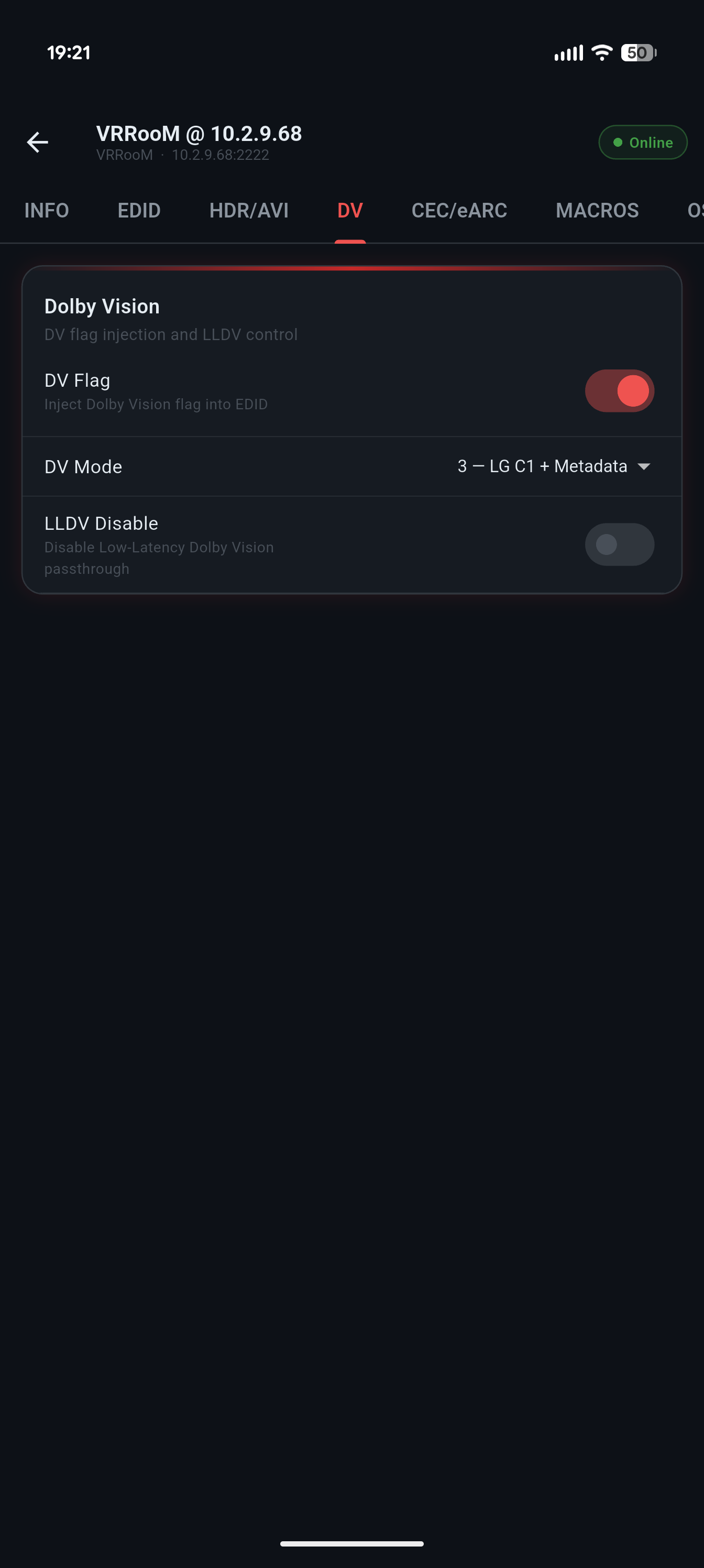

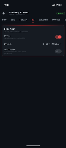

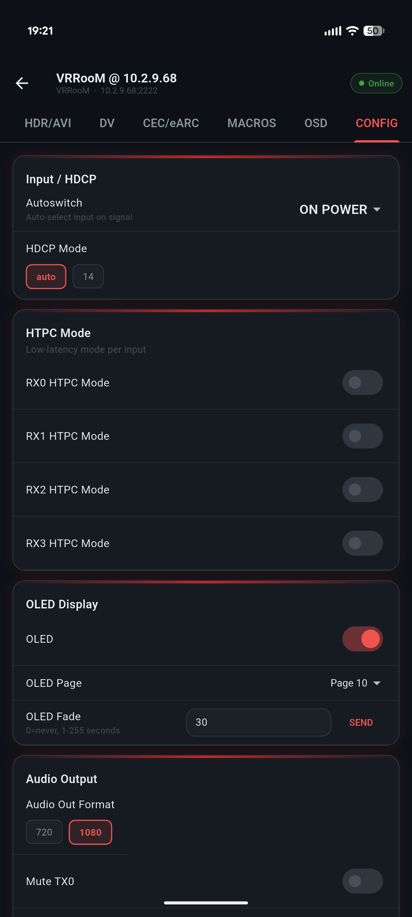

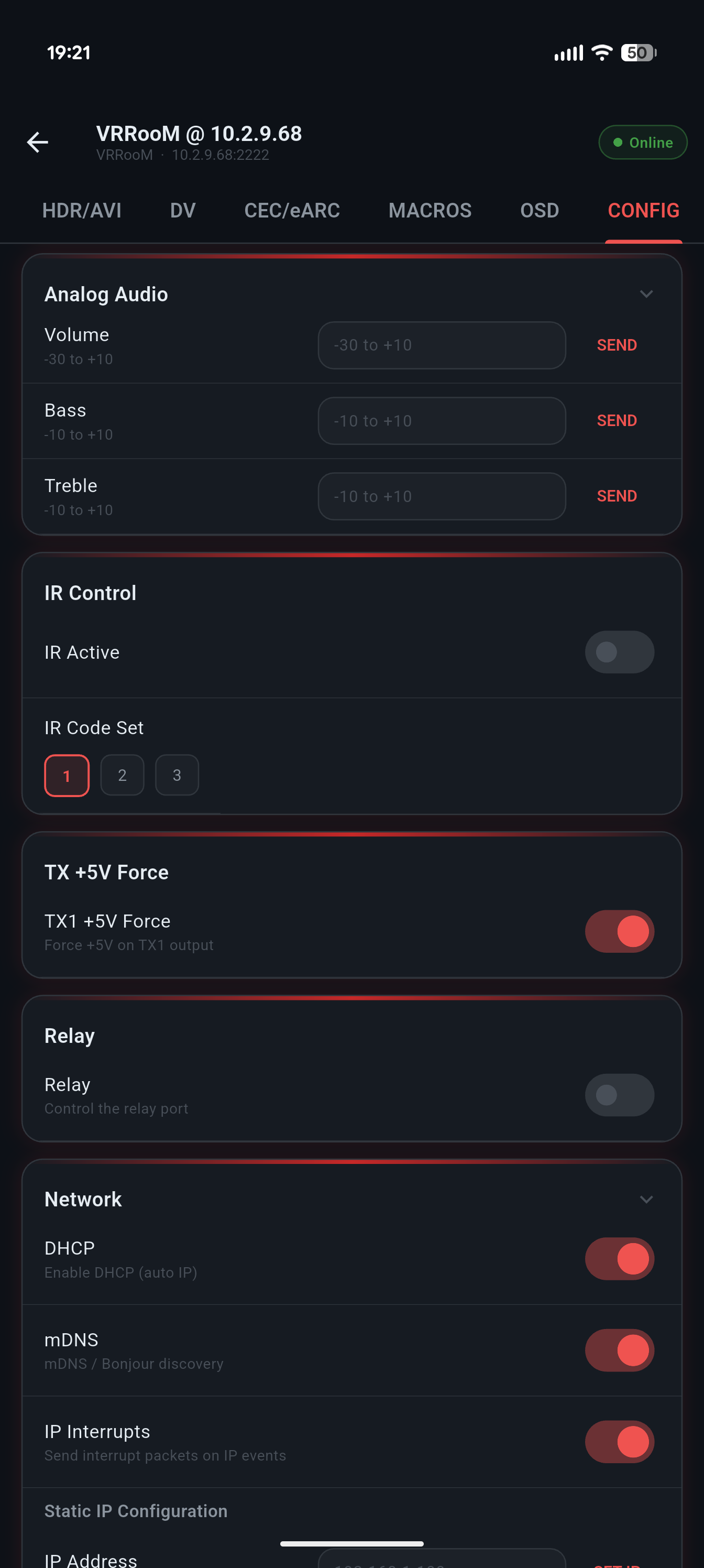

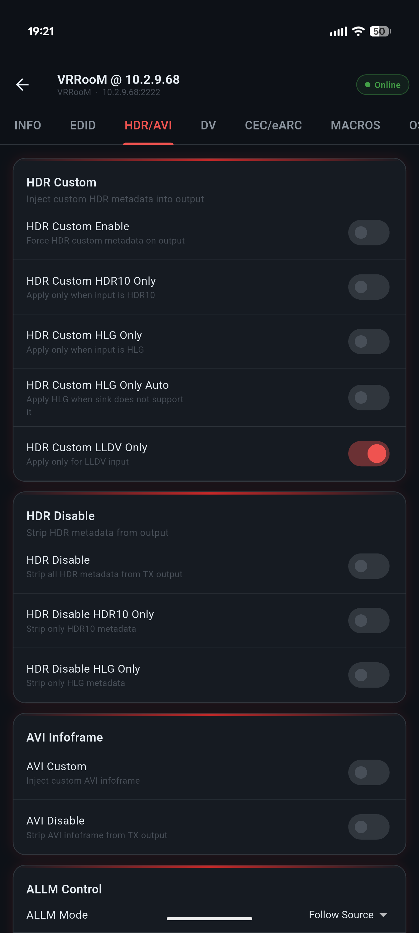

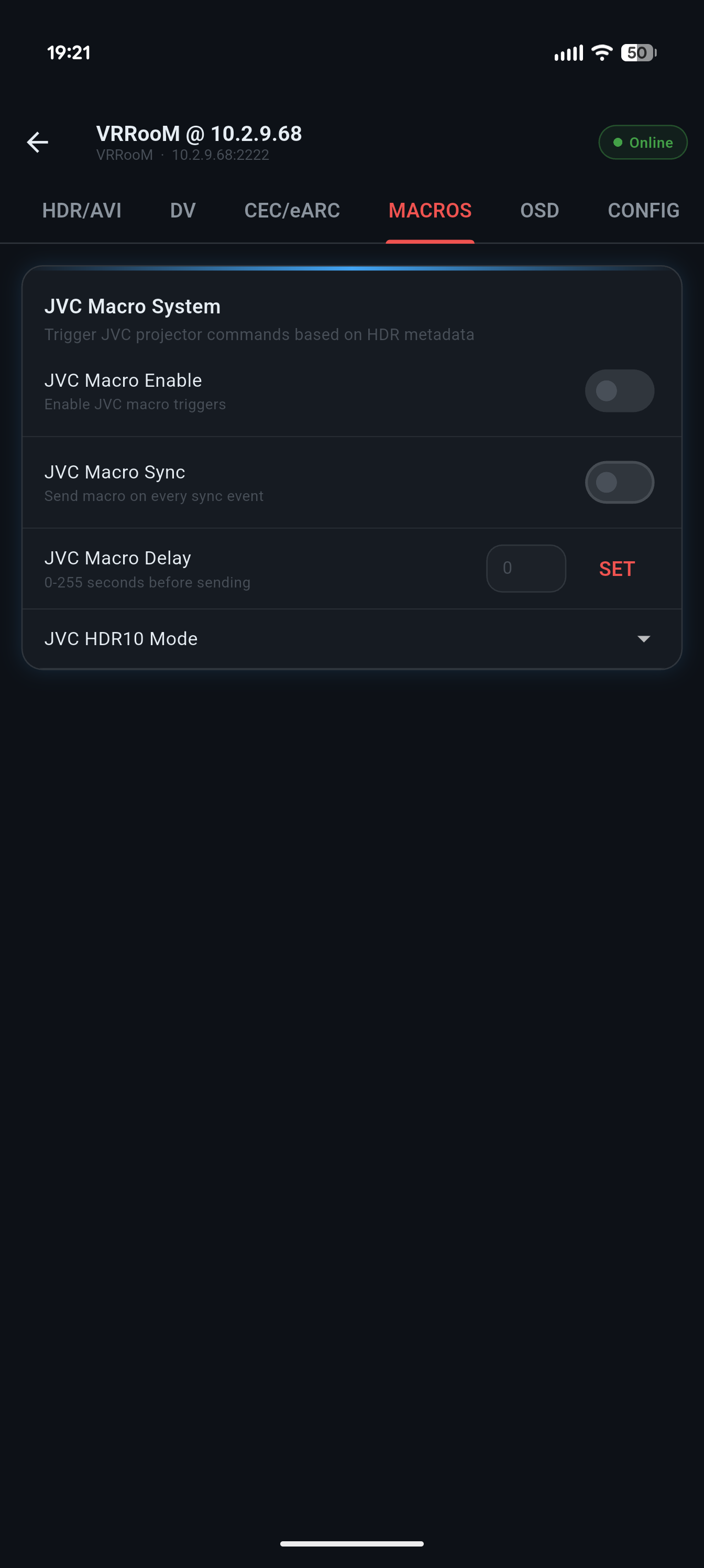

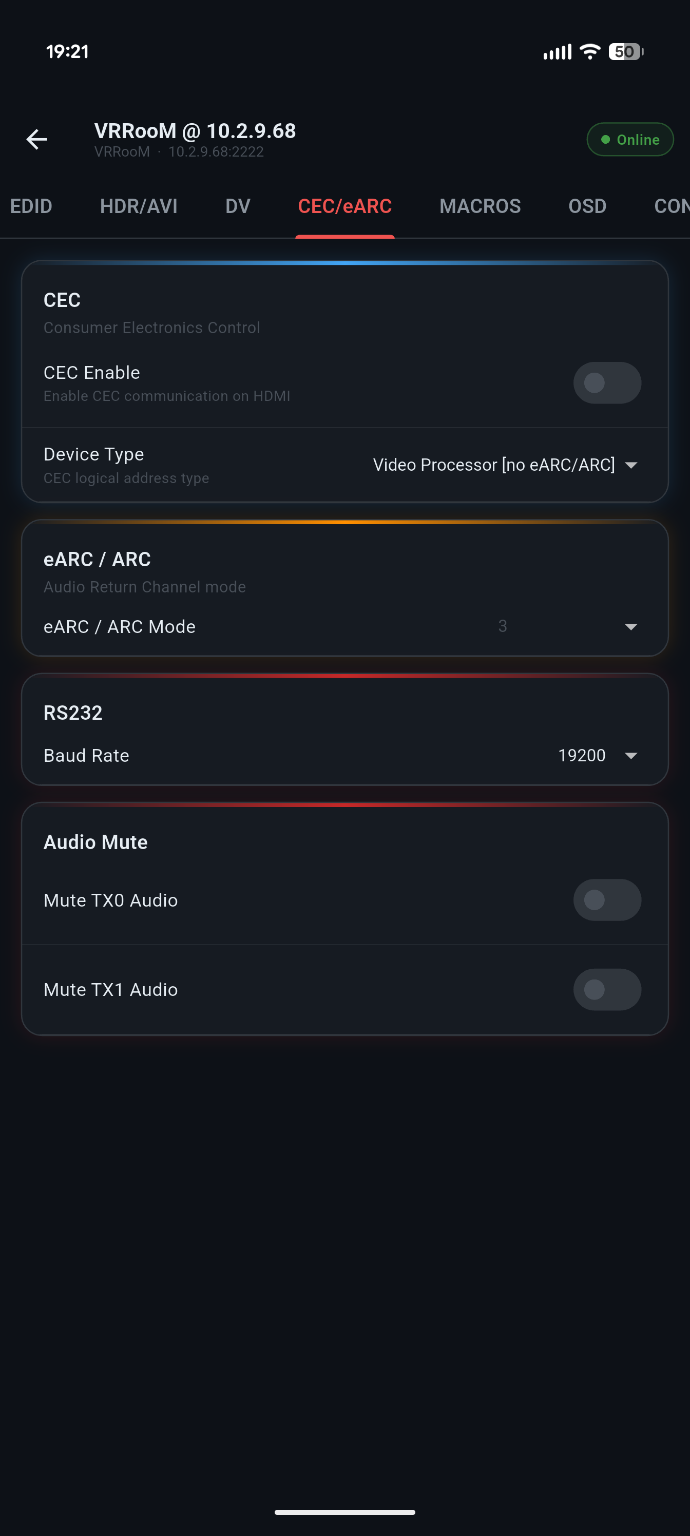

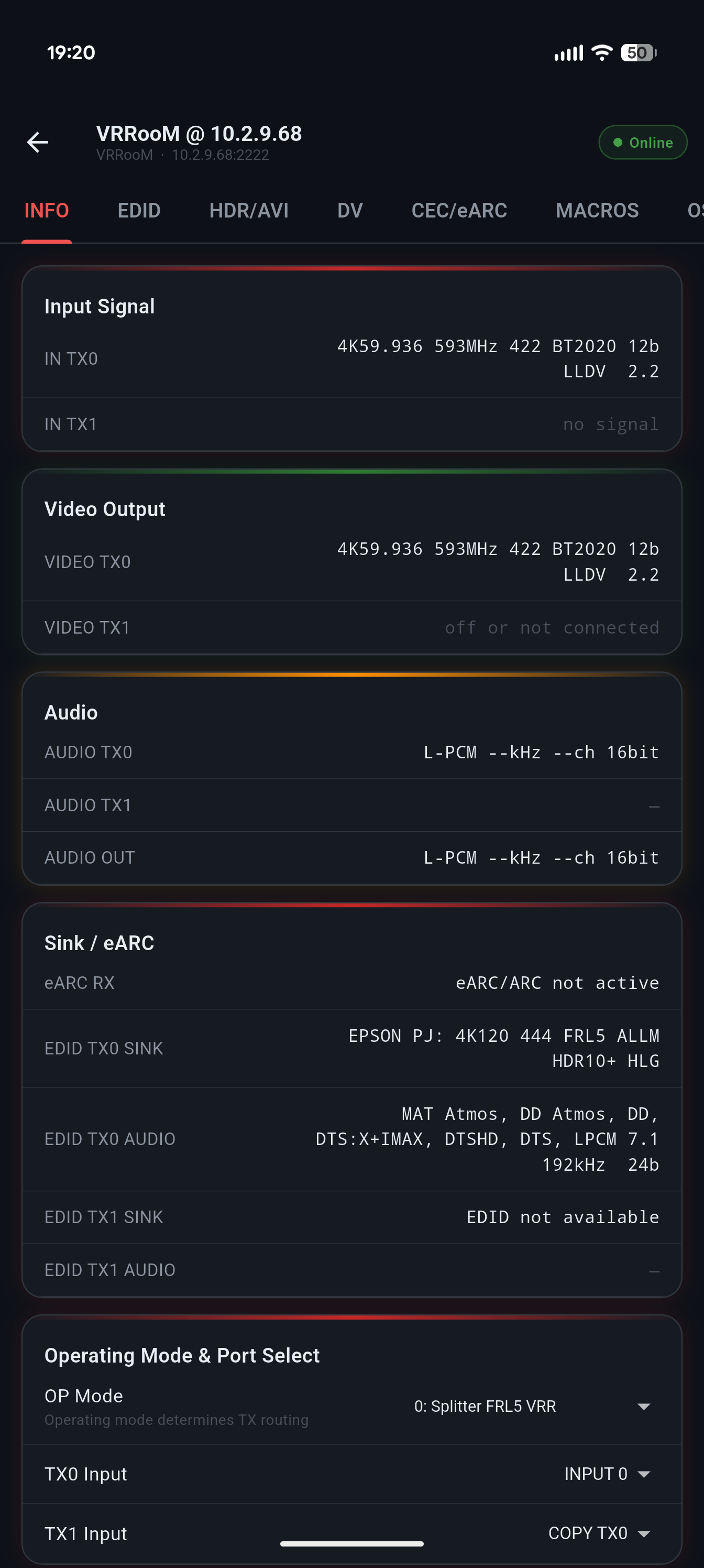

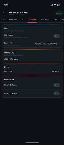

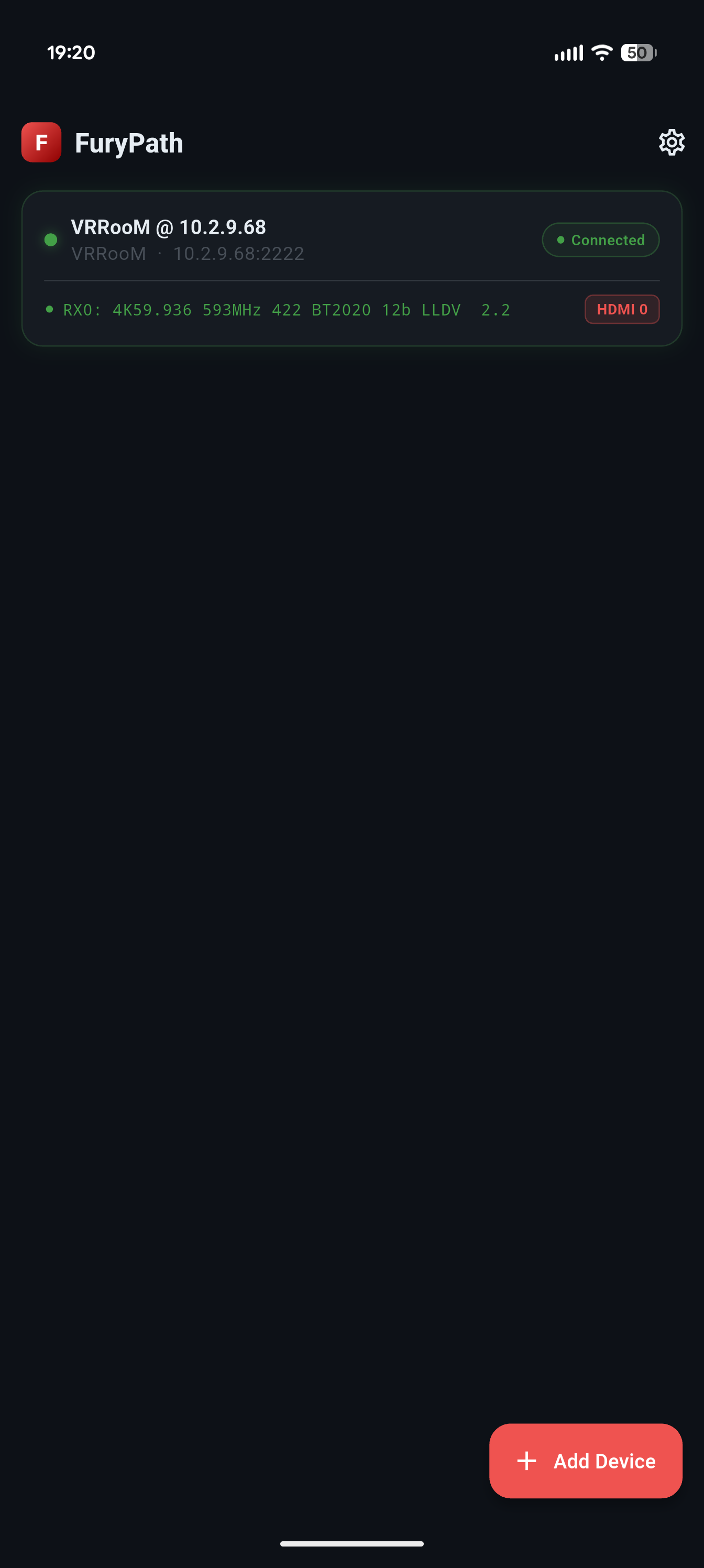

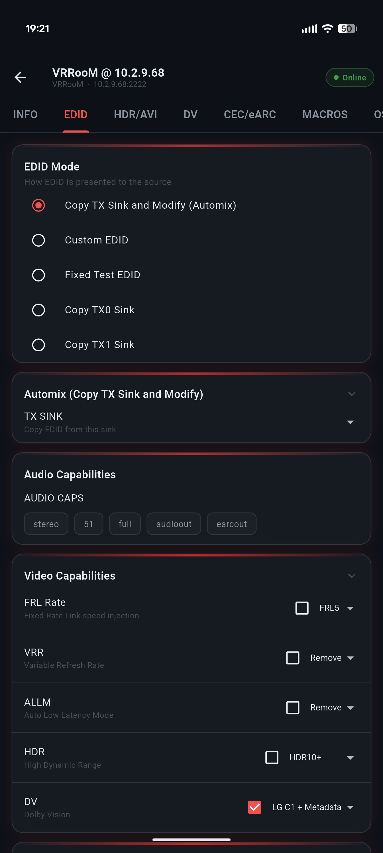

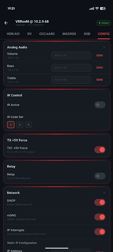

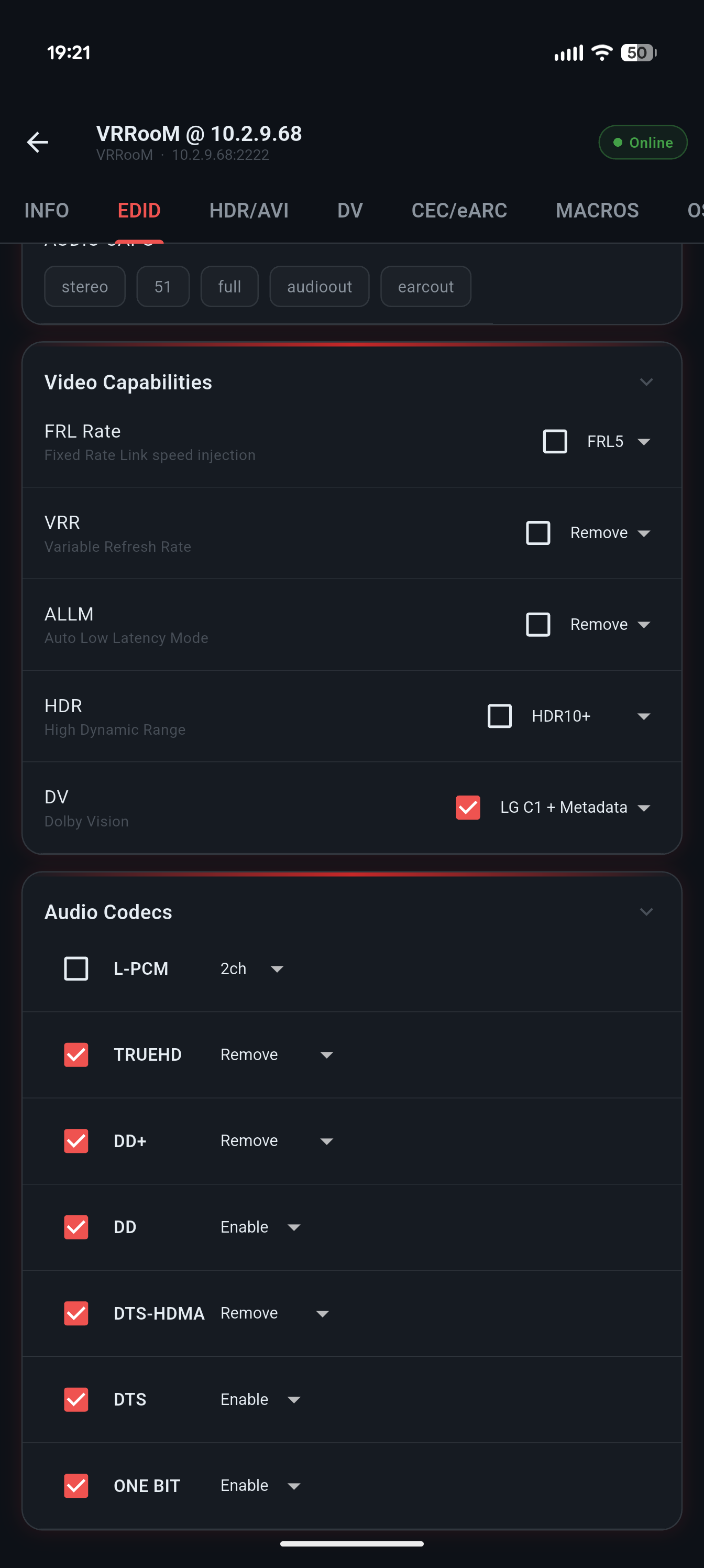

Hey guys. I’ve developed an android app for hdfury, anyone without a different model then vrroom want to give it a spin and provide feedback (I have vrroom so tested against that model already)
Some screenshots below
