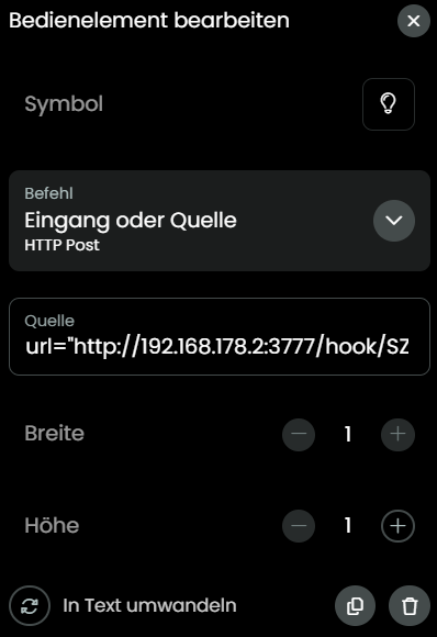

Hi !
I can’t figure out of to send a WOL command … I’ve tried different forms of MAC address, nothing is working. When using WOL on Home Assistant, it just works.
Please post logs after you sent the command.
