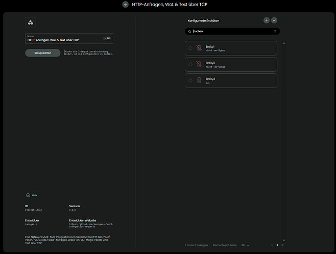

Now Entity2 works great, but Entity1 is no longer reachable. The remote says “Ressource not found” and in the log you can read “WARNING Cannot execute command ‘on’ for ‘remote-custom-entity1’: no configured entity found”. When i now add a third Entity, then the third Entity works great, but Entity1+2 are no longer reachable and so on, means, only the last createt Entity works, all others are not reachable. If i reboot the remote, the icons of the Entities get a red backslash and are marked as “not reachable”. I’ve also deleted the integration twice and build everything new but without success.

I’ve started today from scratch, so you see in the log file at first adding the integration, then configurating the integration (fire&forget) and then adding Entity1, switching Entity1 on/off (works), adding Entity2, switching Entity2 on/off (works), try to switch Entity1 again (won’t work anymore), adding Entity3, switching Entinity3 on/off (works), try to switch Entity2 again (won’t work anymore), try to switch Entity1 again (won’t work anymore). After restart of the remote Entity1,2 are not found, Entity3 works as befor as last added Entity. I use UC System Version 2.7.0.
configured entities:
After restart:
https://pastebin.com/PrhjbXg8
Thanks for the log. You are replacing the entity with the new entity instead of adding it to the config. That will remove the old entity and the old entity will be shown as unavailable after a restart (2025-11-10 22:02:13.844895 +00:00 custom-intg-requests INFO setup INFO One or more entities have been removed from the custom entities configuration. Removing them as available and configured entity)

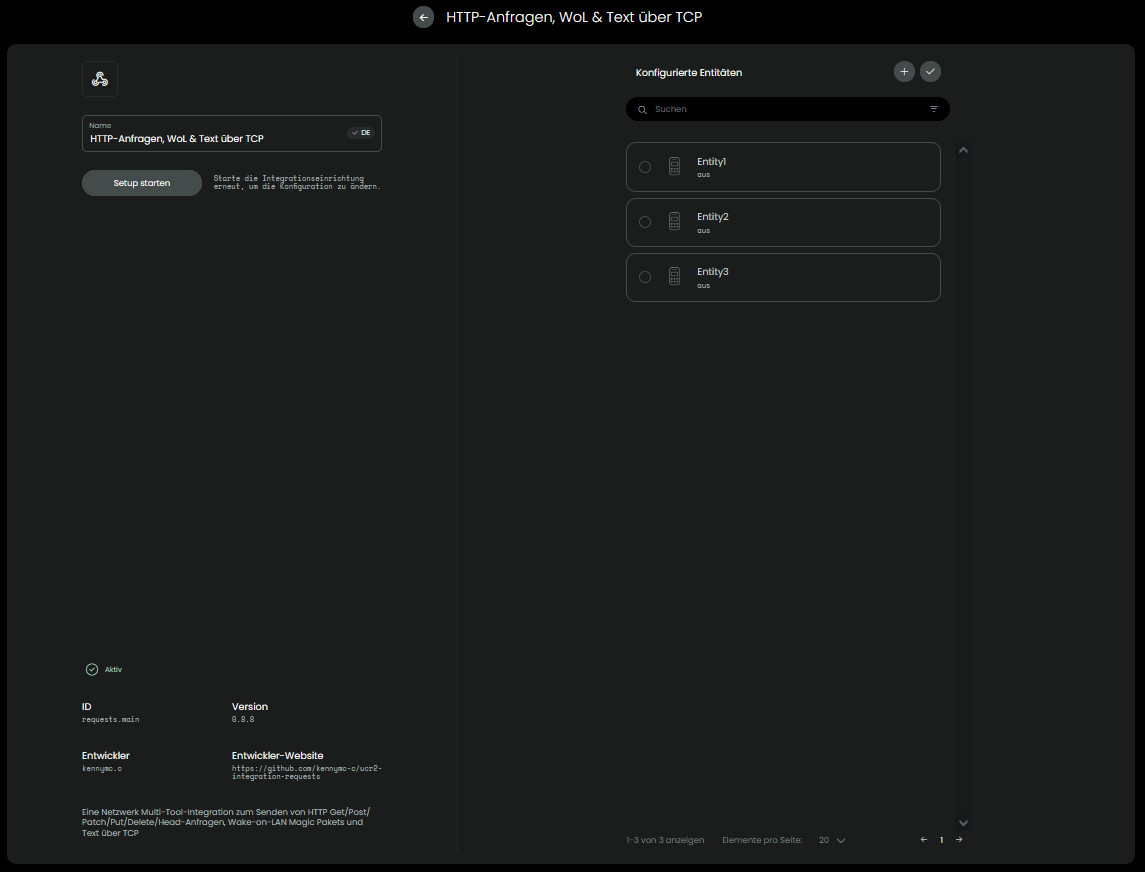

Dear Kenny,
thank you for the hint. Now I understand that all HTTP commands must be entered together and not individually, as I had previously thought. Now it works perfectly. Thanks again for your support!
