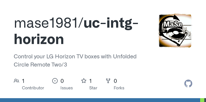

This integration is another “Blind Integration”, meaning: I do not own the device, i live in the US and have zero ability to test / debug properly, any and all support will not be possible at all without detailed description of the problem and logs. This was developed for the community for others to enjoy their Unfolded Remotes. Blind integrations are never easy, please forgive bugs - remember - this is not a job - this is done on free time :slight_smile:
Special thanks: This integration was intensively and thoroughly tested against Virgin Media Cable Box by @fbutler over multiple days and long hours - without his help / debugging skills and incredible attention to details and documentation style this could not have been developed - thank you @fbutler .
You will need to extract a token for this integrations (on some boxes), instructions are on Github - i will refine the instructions based on feedback. Please read README file for full guidance.
Enjoy!
i created this script to try to allow anyone simply double clicking the file and it will open a browser window with instructions to automatically grab your token with zero effort.
just download it, double click and it will be self explanitory. let me know.obviously, i cant test so feedback is needed.
if it doesnt work, let me know so i can work on it.this will simplify the token process.
Script has been uploaded to github and README section updated with instructions to run it.
