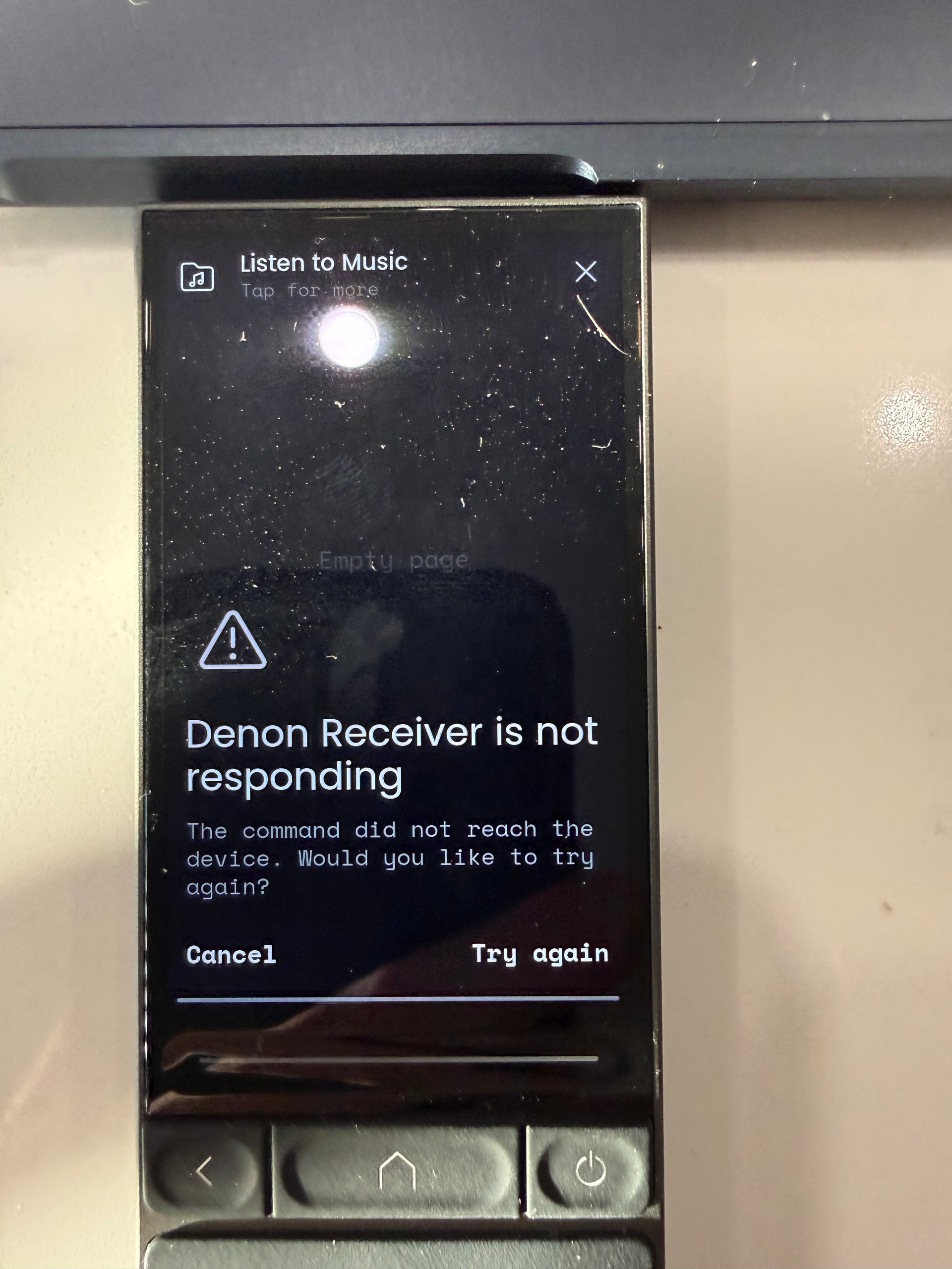

I have most of my commands set to use InfraRed (IR) commands, transmitted from the Dock (in another room). Very often, when I hit a button to send a command (such as Volume Up), The remote pulls-up (effectively) one of two MODAL messages (requiring human acknowledgement) before it will allow any other button to work.
  1. …is not responding: The command did not reach the device. Would you like to try again? (Cancel/Try Again)
  2. Error sending the command: Denon Receiver is not responding. Error code: 400
Other than the obvious (why does it have a problem sending an IR Command), I have to ask why it’s making me ACKNOWLEDGE that it didn’t work before I can send any other command. Effectively, it failed to send a command, and then makes matters worse for usability by demanding I acknowledge that it didn’t work. Would be much better to just let me hit the button again and hope the new attempt goes through. Instead, it’s making life harder adding in a step and making me think about it.
P.S. Yes I know it’s a Denon Receiver, but I’ve chosen to use IR Signals instead of the Denon integration. So this is indeed an IR issue not a Denon Integration issue.
See pictures attached
