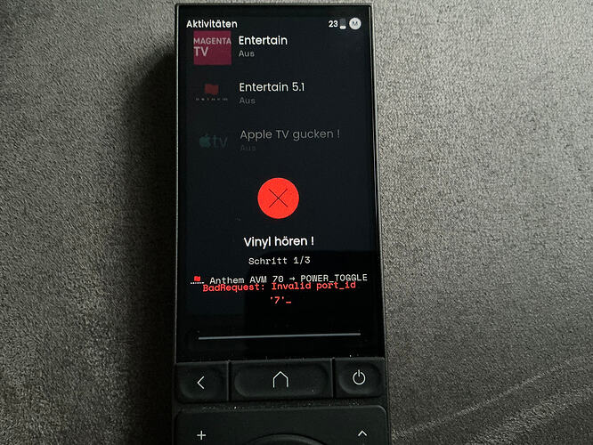

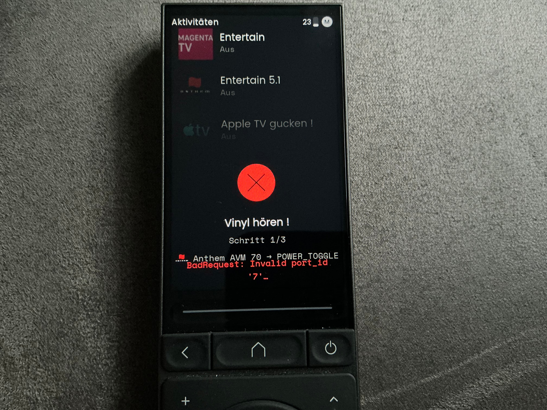

Display Anzeige
Was ist das jetzt wieder?
What the Fuck…..:enraged_face:
This seems to be a problem with a wrong IR port configuration. Please check output settings the entity settings. Otherwise please include the core serivce logs.
EventCategory.ENTITY: ‘ENTITY’>}
2026-01-07 03:01:26.285970 +00:00 custom-intg-anthemav INFO 2026-01-07 04:01:26,285 - ucapi.entities - DEBUG - [configured]: entity ‘remote.anthem_192_168_1_100_14999’ attributes updated
2026-01-07 03:01:26.284544 +00:00 custom-intg-anthemav INFO 2026-01-07 04:01:26,283 - ucapi.entities - DEBUG - [configured]: entity ‘media_player.anthem_192_168_1_100_14999’ attributes updated
2026-01-07 03:01:26.283060 +00:00 custom-intg-anthemav INFO 2026-01-07 04:01:26,282 - ucapi_framework.driver - ERROR - [anthem_192_168_1_100_14999] Connection error: [Errno 101] Connect call failed (‘192.168.1.100’, 14999)
2026-01-07 03:01:26.280930 +00:00 custom-intg-anthemav INFO 2026-01-07 04:01:26,280 - ucapi_framework.device - ERROR - [Anthem (192.168.1.100)] Connection error: [Errno 101] Connect call failed (‘192.168.1.100’, 14999)
2026-01-07 03:01:26.266655 +00:00 custom-intg-anthemav INFO 2026-01-07 04:01:26,265 - uc_intg_anthemav.device - INFO - [Anthem (192.168.1.100)] Establishing TCP connection to 192.168.1.100:14999
2026-01-07 03:00:56.271787 +00:00 custom-intg-anthemav INFO 2026-01-07 04:00:56,270 - ucapi.api - DEBUG - [(‘127.0.0.1’, 40870)] =>: {‘kind’: ‘event’, ‘msg’: <WsMsgEvents.ENTITY_CHANGE: ‘entity_change’>, ‘msg_data’: {‘entity_id’: ‘remote.anthem_192_168_1_100_14999’, ‘entity_type’: <EntityTypes.REMOTE: ‘remote’>, ‘attributes’: {<Attributes.STATE: ‘state’>: <States.UNAVAILABLE: ‘UNAVAILABLE’>}}, ‘cat’: <EventCategory.ENTITY: ‘ENTITY’>}
Maybe this will help you. I restarted the dock and then it worked. I didn't have this problem before. I just updated the Anthem integration; maybe there's a bug in there.
If you’re using the Anthem integration the Dock has nothing to do with it. There seems to be a connection problem to the Receiver. Maybe @M.a.S.e can help here. Also check, that your receiver is reachable from the network
Hey, sorry i dont think i follow the scenario and problem statement. Can you please tryt to reexplain (in english please) @Marco17091971 - WTF statements are not helpful todebug :slight_smile:
Walk me through what you did, what is the issue and how you set it up. (please be verbose, i dont own the Anthem device so i need you to explain in details).
The problem is solved. I restarted the dock, and it's working now. Our internet connection was changed recently; that might have been the cause.
