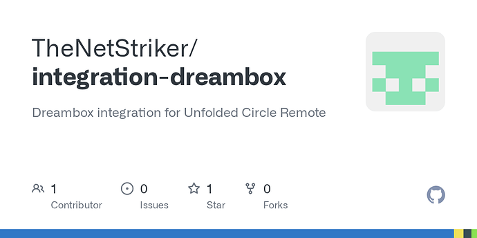

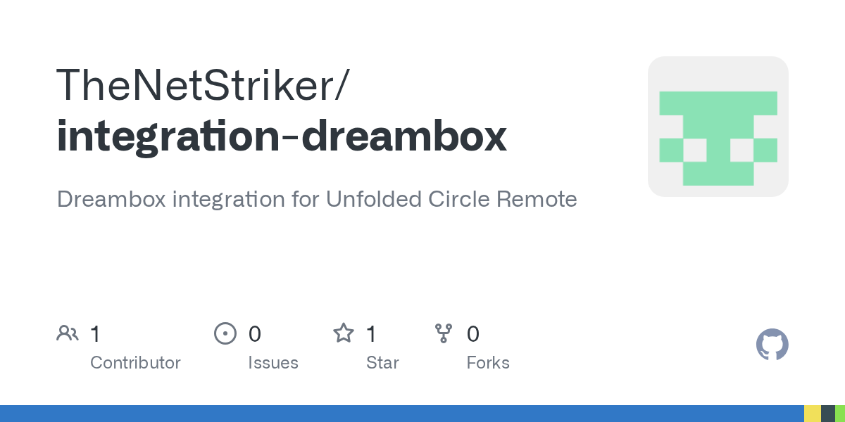

Here is Dreambox integration
It is called Dreambox but it supports Enigm2 from my VUs and Octagon.
