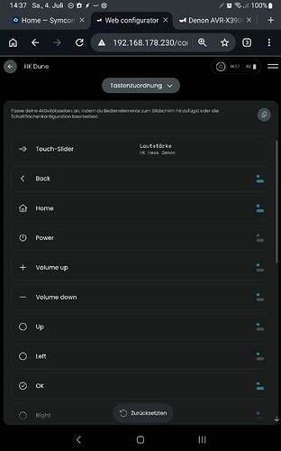

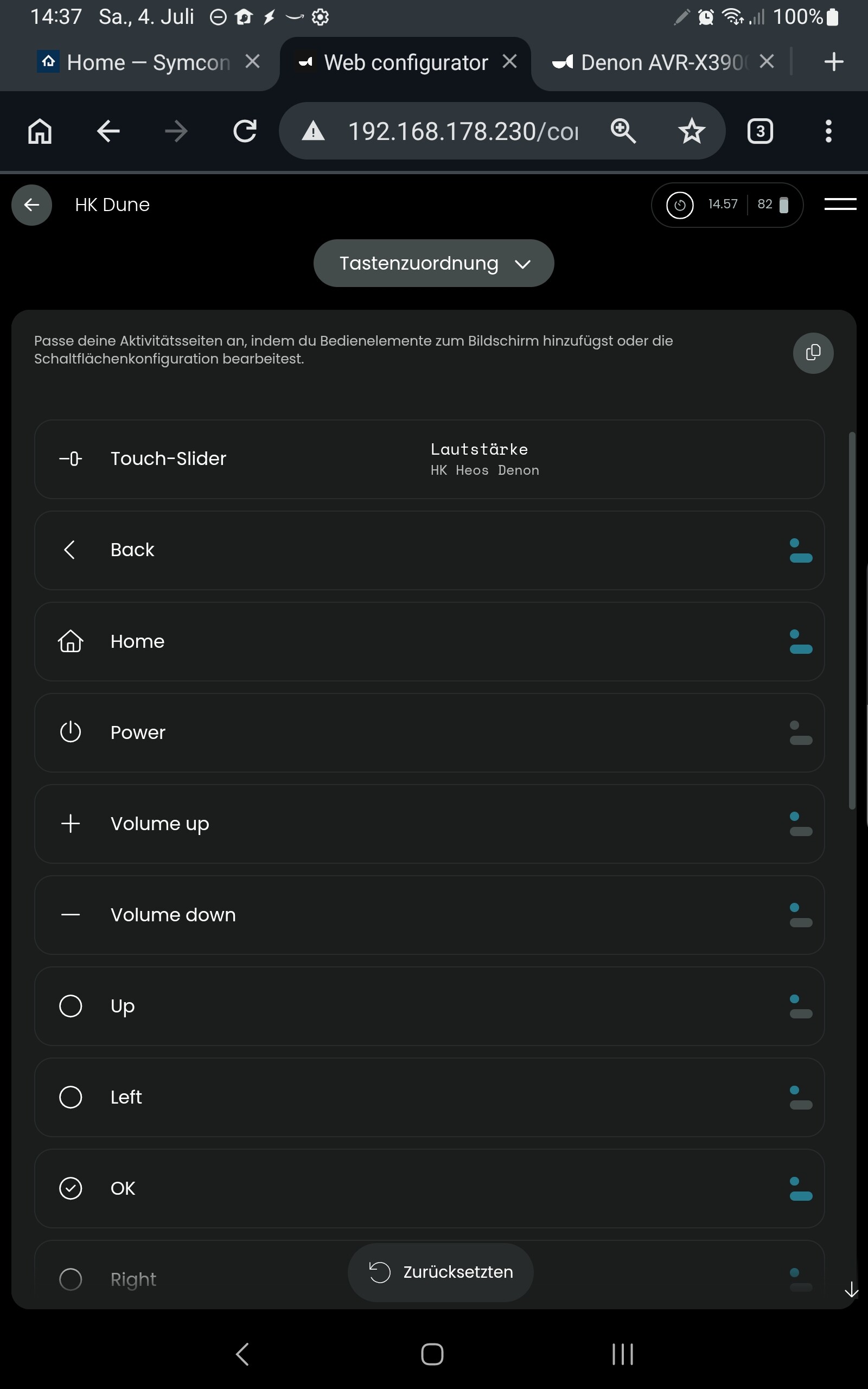

for the slider, you do have to configure it in the activity setup for the slider to control the AVR volume, have you checked there?
(i can send you screenshot if you need)

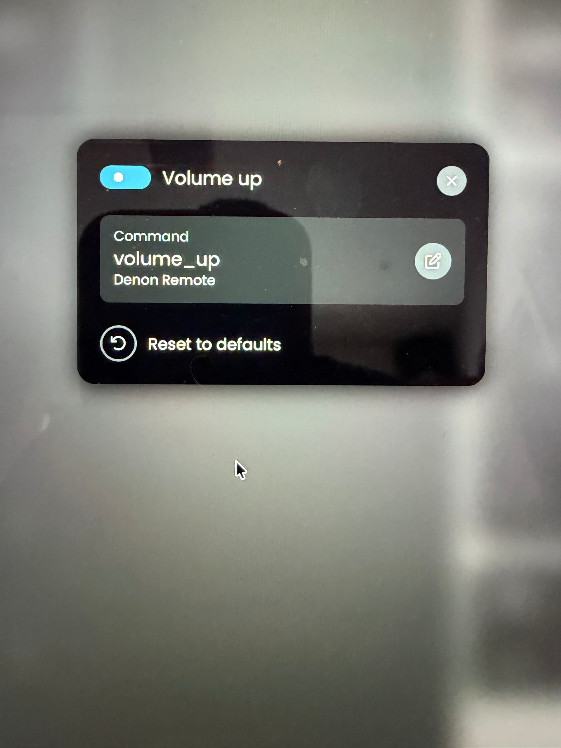

You find the slider config in button setup and I think you must have added the Mediaplayer entity to your activity.

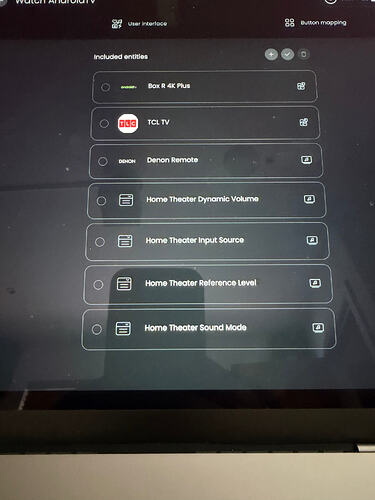

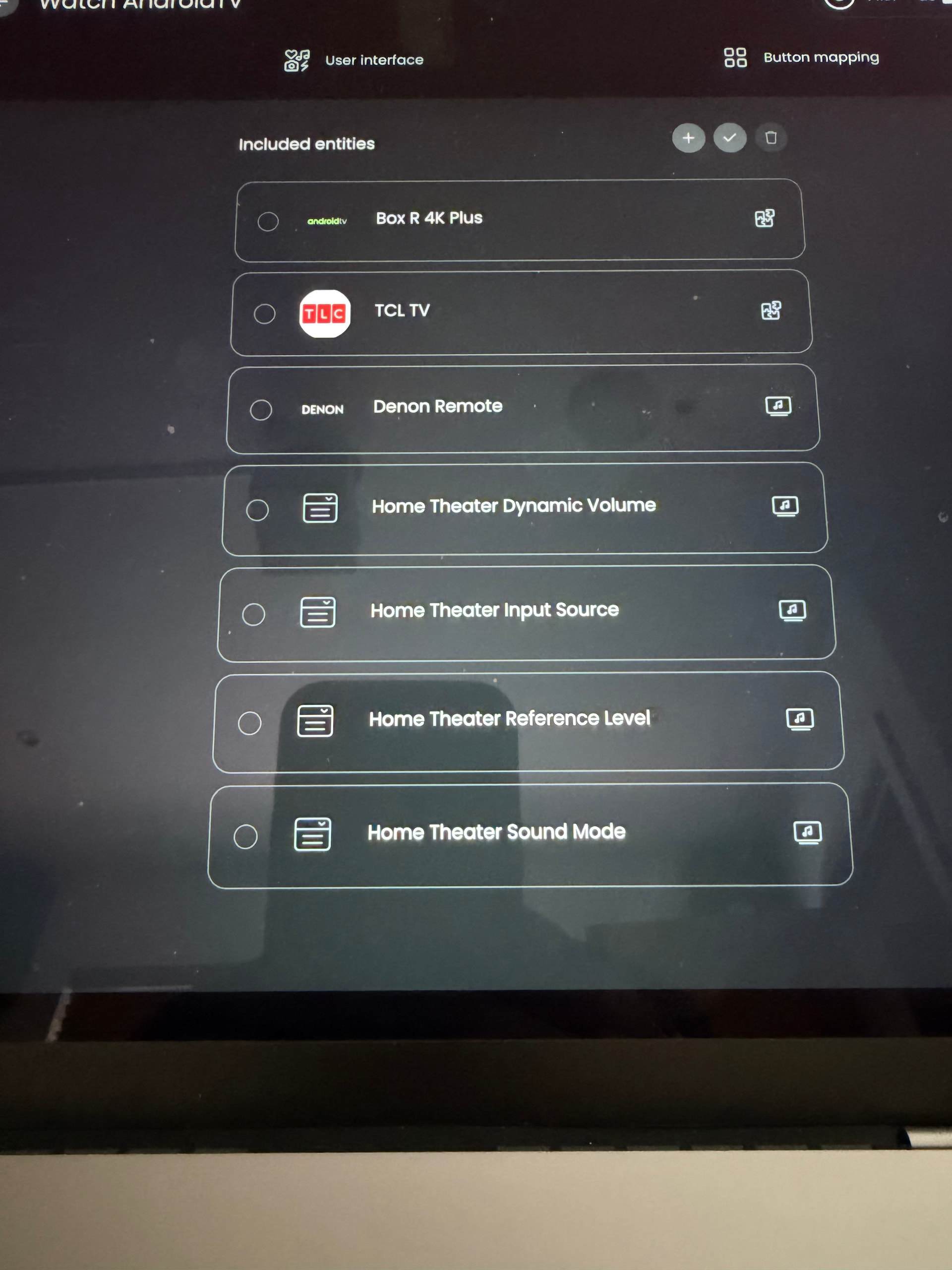

I do have the remote added. I’ll check maestro now.
I actually had to add the AVR network receivers for it to actually work. I’m sure before I’ve added the remote.
Thanks for your input and help guys. All sorted.
