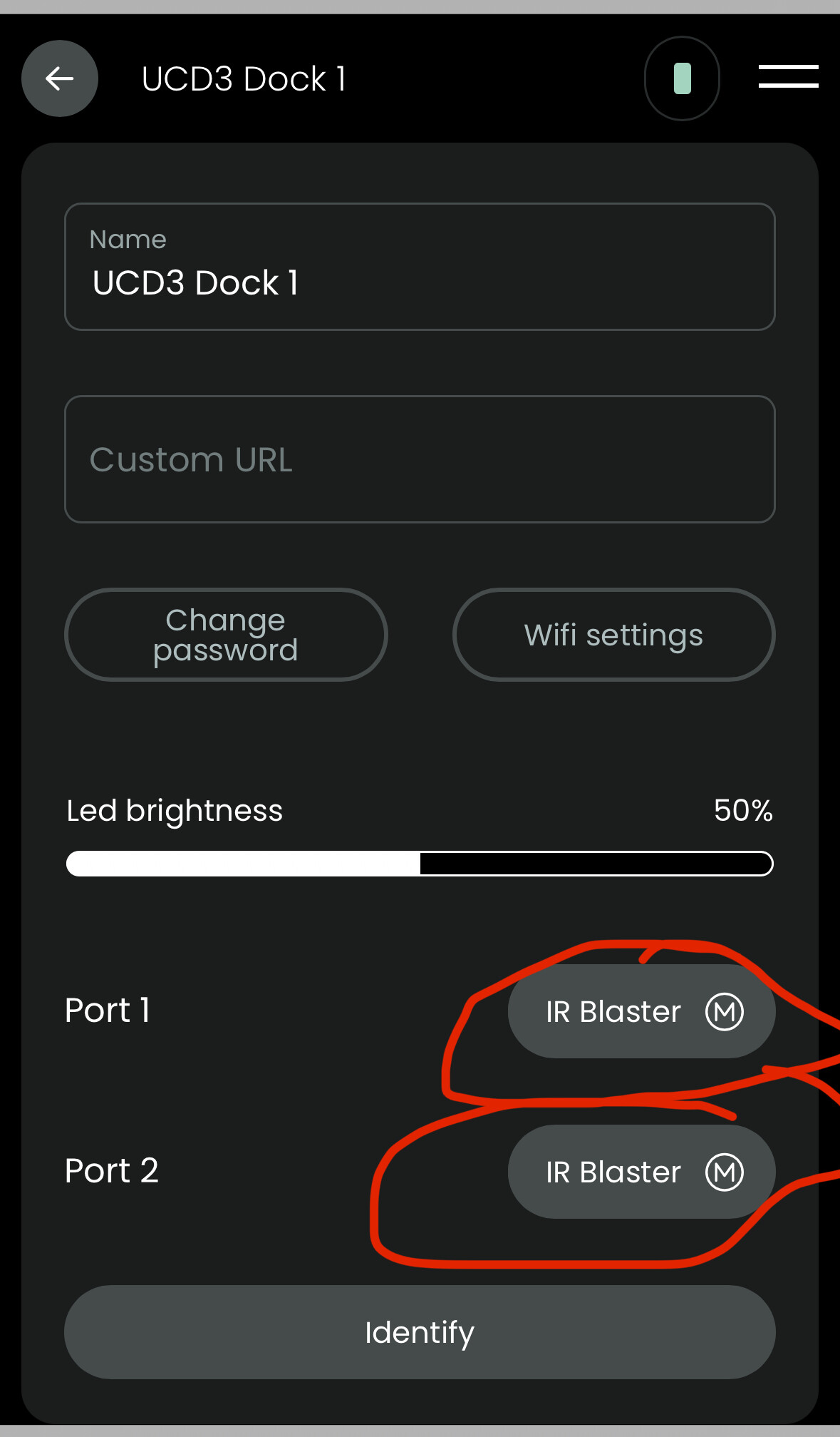

I got it. Thank you for your help. I figured out that my IR satellite box only responds if I press the command from the remote a few inches away. Any idea why the IR blaster from the dock isnt working?

Is the IR blaster properly set up and detected by the dock (check in the web UI)?
Is the blaster selected as an output device in the IR entity?
Where do I check to see if the ir blasters are being detected in the web ui?
Go to integrations then the docks tab:
