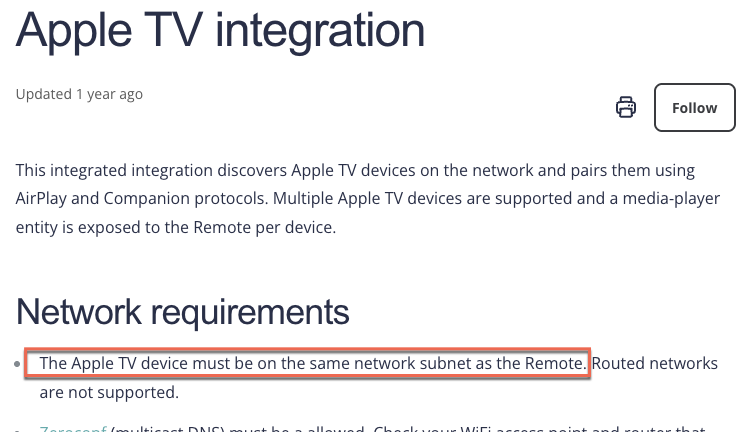

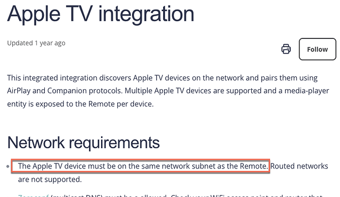

I guess the answer is no, VLANs are not supported. Unless the remote and the ATV are on the same VLAN. Unfortunate, because Home Assistant has no issues control the ATV from a different VLAN. Seems like an issue that could be resolved by the UC folks.
https://support.unfoldedcircle.com/hc/en-us/articles/19479576638620-Apple-TV-integration
