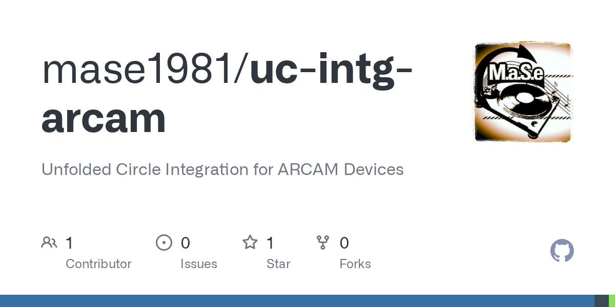

ARCAM Integration release
Hey everyone, releasing my latest integration for ARCAM FMJ devices, this should also work for JBL and AudioControl devices since they use same protocol.
A few things to note:
This is another blind integration, i do not own an ARCAM device and i cannot test or replicate anything. If any issues occur or this is not working please explain in details what was done and the steps taken and share the integration logs.
thank you.
