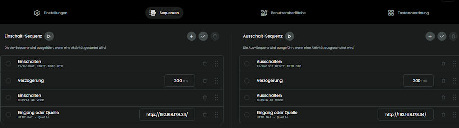

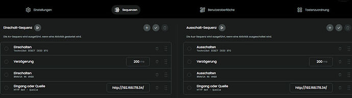

Here’s how the sequence looks like:
Start and end sequences of both activities would be interesting. I saw http request commands what do they do?
HTTP Requests are for LightManager AIR (Background-Light, Subwoofer, etc).

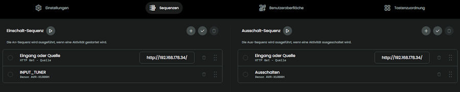

Here’s the Radio-Sequence
CEC deactivated? Both in the same group?
Sure. (I hate CEC :wink: )
Yes.

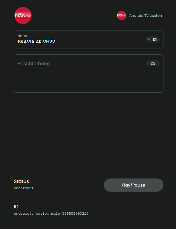

It is interesting that the status of the BRAVIA is set to “unknown” and remains there all the time.
All other entities have and change their status.
Then i changed controlling the TV from integration to IR and with that the TV is switched off like expected.
So for me it looks like something is going wrong inside the integration Android TV.
Your Sony Android TV has an unknown state. This can cause such issues as the remote doesn’t know the state of the device. You can see in the log that the TV is not included in the newly created off sequence but only the Technisat receiver that has a known state (ON):
  • 2026-05-21 08:42:24.609904 +00:00 core NOTICE [Wohnzimmer] Created power-off sequence: [{“type”:“command”,“command”:{“entity_id”:“uc.main.0d085c63-c836-4877-ba79-ef3ec840c971”,“cmd_id”:“remote.off”}}] Entities in old activity: [“BRAVIA 4K VH22 (androidtv_custom.main.38B800E9C21C) UNKNOWN”, “HTTP Get (requests.main.http-get) ON”, “TechniSat DIGIT ISIO STC (uc.main.0d085c63-c836-4877-ba79-ef3ec840c971) ON”] Entities in new activity: [“HTTP Get (requests.main.http-get) ON”, “Denon AVR-X1800H (uc_denon_driver.main.media_player.DCFW032408801) OFF”, “Denon AVR-X1800H Remote (uc_denon_driver.main.remote.DCFW032408801) OFF”]

That might be an integration problem. Can you monitor the entity state shown in the web configurator when you turn it on and off using the remote and media player entity?
I also noticed that your Android tv integration driver id contains a _custom postfix. Is there a reason why you’re not using the included version? Maybe you also could have mixed up entities from both the internal and custom variant?
Did it and it still stays on “unknown” all the time.
First i used the included version with the same problem. Therefore i tried the “external” without success.
