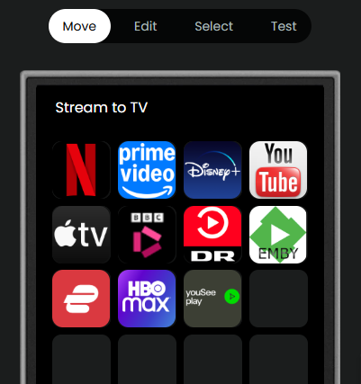

Could you please explain the context of your answer? In the UC3 ‘user interface’ for my activity ‘Stream to TV’ I have these buttons
which launch apps on the Shield using HA scripts (entities exported to the UC3).

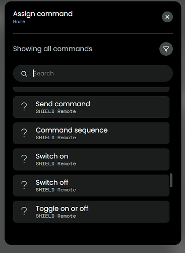

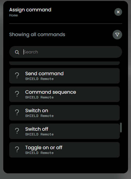

My question is whether this can be done directly using just the Android TV Remote integration (without HA). But for the Android TV Remote I only get to choose from this list of commands:
Is there some commands or command sequences that I can use here?

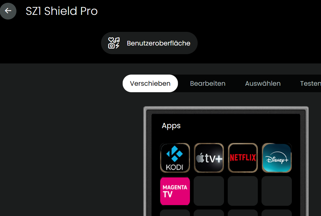

Mine looks like this with pure Android TV:
In configurator it looks like this:

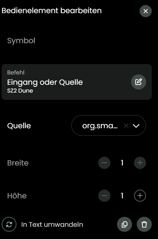

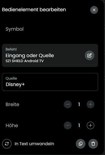

Disney+ is predefined in the integration. For Apps not defined you need to know the package name and then simply enter the package name in the source line like this:
This is with the package name of SmartTube.
