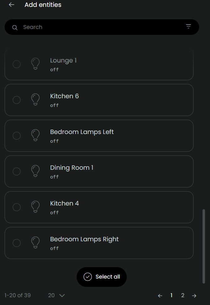

When I setup the Home Assistant integration I selected a small number of HA entities to be exposed to the remote but I had plenty to choose from. I’d like to add a few more but can’t for the life of me work out how.
If I go to Integrations → Integrations → Home Assistant and click the + to the right of ‘Configured entities’ I can add more HA entities but I only see 39 entities showing. There’s no filters applied so I’d expect to see a lot more.
I wondered if I needed to step through the integration setup again but I only see the same 39 entities there.
What am I doing wrong?

Regarding your problem, I vaguely remember instances where not all HA entities would be shown for selection. Have you tried typing the name of an entity you want to add in the search field. I seem to remember that this would then also bring up entities previoulsly not shown.
I’ve got the HACS integration setup but all I see that doing is exposing some UC entities into HA - battery % and so on. I’ll check if there’s another integration or if I need to reconfigure this one.
Yeah, I’ve tried searching for an entity by name but nothing is found.
EDIT - I see there’s more config needed on the HACS integration, I’ll experiment with that now.
All sorted - thanks for pointing out the HACS integration. I needed to go in to there and expose the entries to UC from within there.
