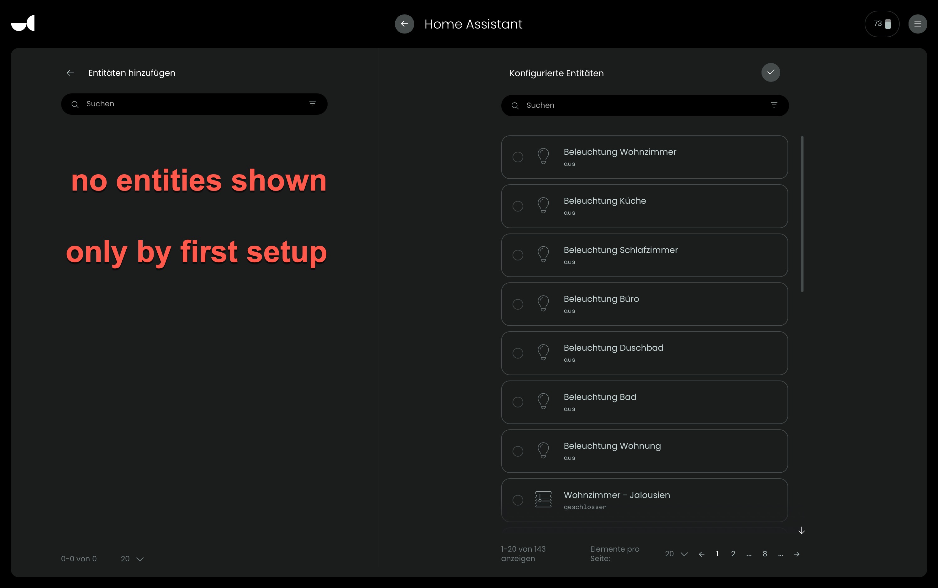

Dear all,
I have an interesting problem. I use some Entities via Home Assistant Integration an it works fine. But adding additional entities are not possible, the list is empty for selection.
I can only add entities by using the following workaround:
Removing Home Assistant Integration- Restart R3 - Install Home Assistant Integration - and then, all Entities are available - but I have always select all needed entities again.
What can I do to add entities without executing the full setup again and again. I have more than 4.000 entities on Home Assistant, maybe that this is too much? Also using the seach field shows no entries.
What can I do to add Home Assistant Entities without doing the full setup process on each change?
There is a much better way to add HA entities to Unfolded Circle remotes using Jack Powell’s Unfolded Circle Home Assistant integration. See here: GitHub - JackJPowell/hass-unfoldedcircle: Home Assistant Integration for the Unfolded Circle line of remotes
Thx. Works really well.
