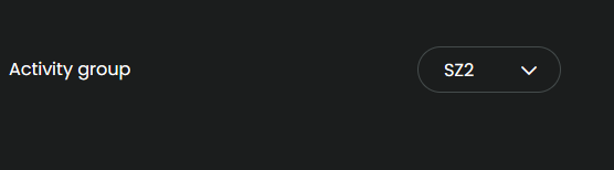

Ok, if it will not ask me, I’m fine with it as well. Then again the question, what do I have to set in the pull down menus of the activity group?
The first drop down determines if delays after a power-on command in an on-sequence should be removed. The second drop down determines which entities will be switched off. The support article describes the options in more detail.
I have my actitity group set to „Never“ and „used in off sequence“.
