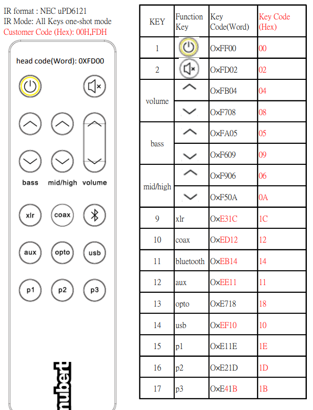

I’m more and more frustrated. I have now a feedback from Nubert, the manufacturer of my active speakers, but I can’t make it work. I’m not sure, if I interpret the info from Nubert correctly.
Can someone please help me and tell me, what I have to copy to the Hex or Pronto field.
What have I done?
For the power toggle I copied the head code and the key code to the hex field, so “FD00FF00”. I pasted these eight letters and numbers instead of the ones in the learned entry. The command looks like this and doesn’t work. I know, this procedure is very trial & error.
3;0xFD00FF00;32;0
Then I pasted the “FD00 FF00” into the hex converter on the Yamaha homepage. It successfully creates a Pronto code, which also doesn’t work.
But also here, I don’t know, if these 8 digits are right at all
So my first question is, what do I take from the provided screenshot?
I hope, the screenshot will be visible here below.
Can you try the following HEX code for the Power Toggle and see if that works:
3;0xBF00FF;32;0
I have tried it, but after it also didn’t work, I pushed the button 4, 5, 6 times and suddenly, it was powered on. So at least, there is any reaction at all. Same to toggle it off. Just pushing the button once or twice, does not work.
So there are two questions now to me. How did you come to this command, and what can we do to improve the command, that the speakers react after the first push?
Thank you very much for your help!
