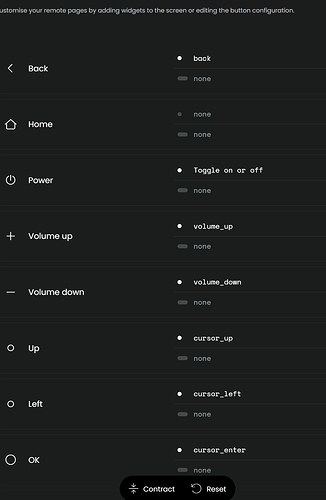

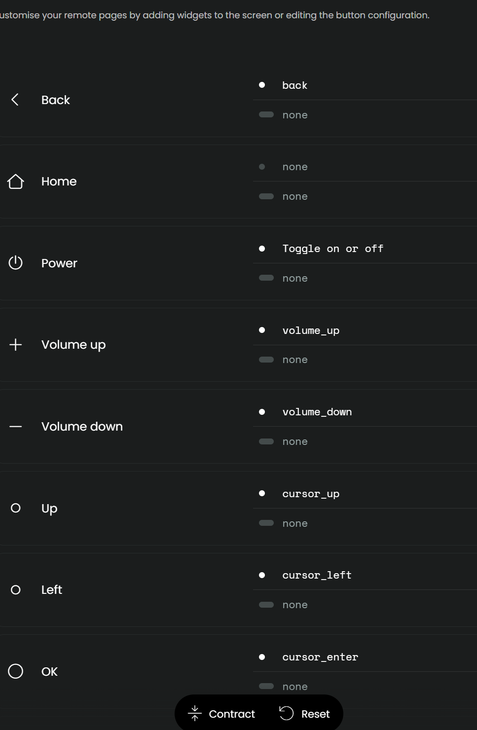

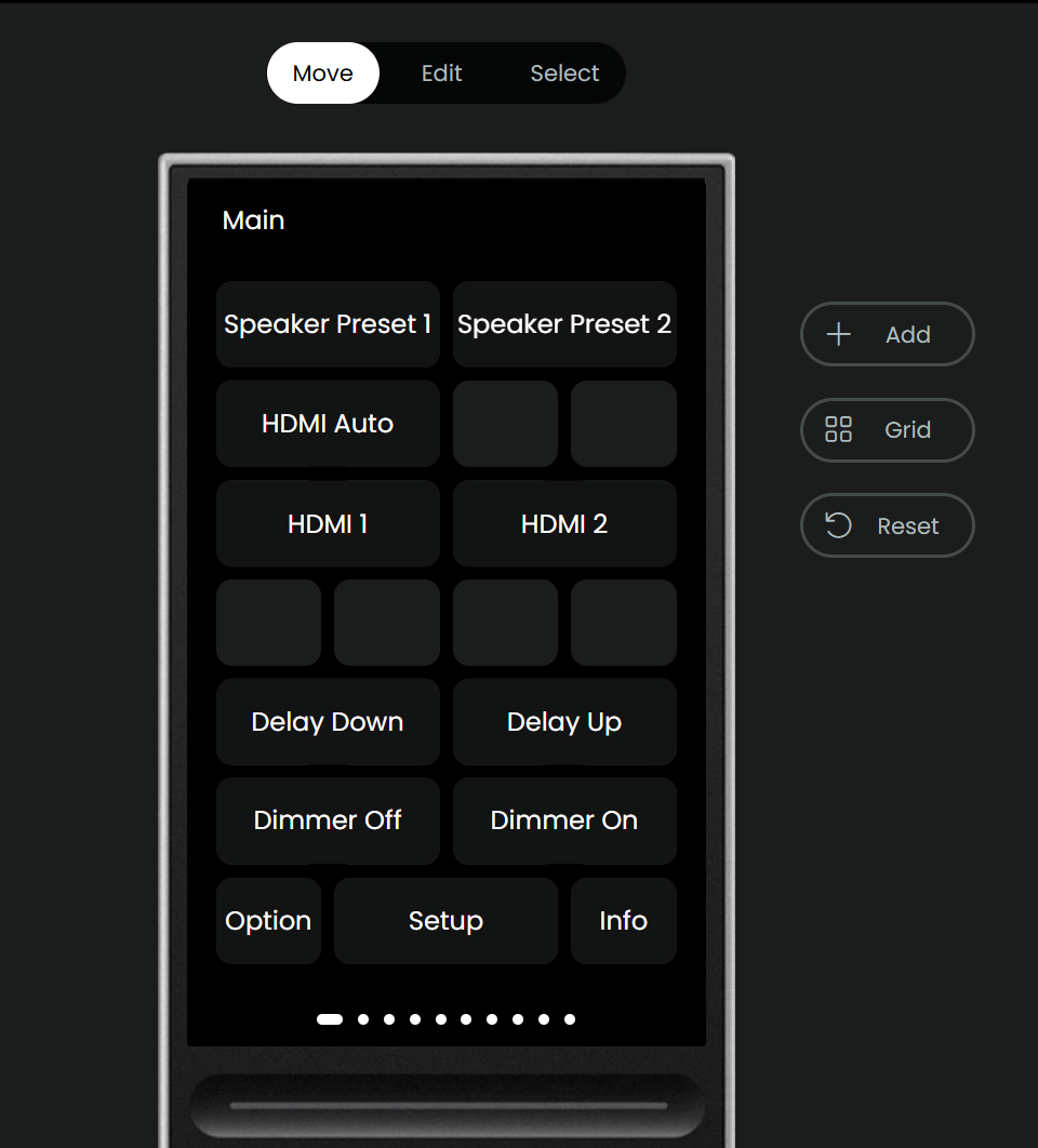

If you do integrations on the device itself, you get these awesome pre-configured remote views with buttons already programmed into the remote:
Question

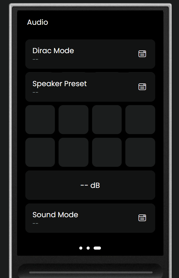

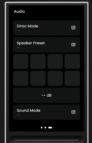

I’d still like to go back to 100% Home Assistant, but I’m not sure if it makes sense. The “Remote” entities seem super valuable from these integrations.
How are you guys using Home Assistant and sharing configs? Do you add the integrations only for their Remote entity and leave the rest to Home Assistant?
How are you handling icon-style configs like this without those Remote 3 entities? Home Assistant doesn’t have all of the ones the configurations give you:

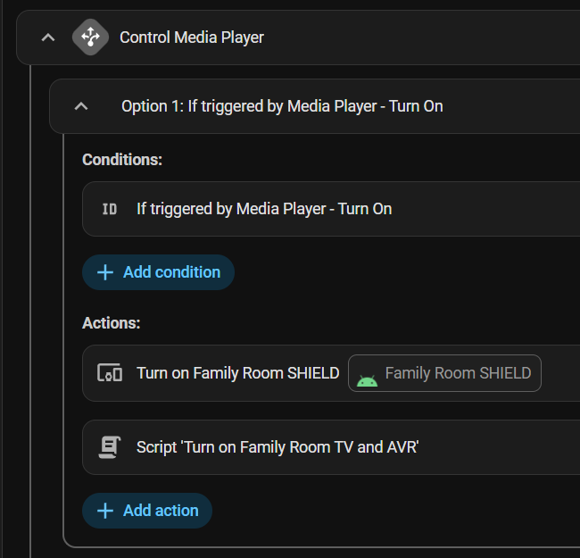

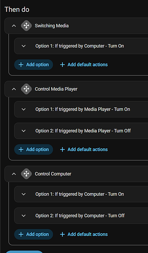

Home Assistant automation

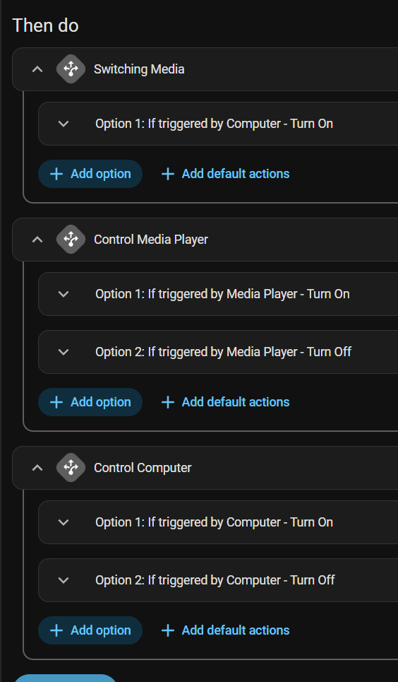

This is what I had in the past. Sound very much like what you’re doing:
I try to minimize the number of automations I have. I write scripts for repeat stuff and use trigger IDs to maintain single automations with multiple paths. This one:

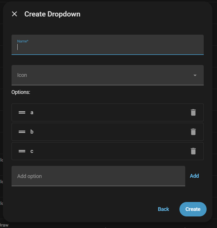

I thought of using a multi-select dropdown instead of a bunch of toggles (booleans), but that’s simply not possible. Select’s are single-selection only:
Something I did in another automation was parse strings. I used a text field, stored a special-character-separated list and used Template actions to separate those out into separate states, then I stored those in a Variables action. It’s all pretty convoluted to get a simple multi-select entity without a bunch of disconnected booleans :confused:.

I’m doing kind of the same thing when it comes to repeated actions. I only create (template) helpers, which I can re-use in automations, instead of scripts, but basically that’s the same thing I guess.
Opposite to you I’m making seperate automations for basically each action. I went for large and complicated automations at first, but noticed when somethings fail or hang, Home Assistant is not very good at letting the automation continue, even though I’ve set the ‘continue on failure’ option to all of the actions (Plus the automations are easier to maintain when they’re chopped to simple and small bits, which is also regarded as best practice in some other software).

I suppose an advantage of using native remote integrations is that you get user interfaces as part of the integration and not have to build them up if using HA integration (generally good if you like the UI that comes with the native integration).
Question: if I make changes to the user interface pages that came with a native integration (such as the Denon/Marantz integration), what happens if I update that intergration in the future? Will my custom changes to the UI remain?
Yes. Your custom UI changes will remain. If you manually upgrade a custom integration you will need to run setup again and re-add the entities you need but activities (on/off sequences, UI and button mapping) will be intact. If you havent already taken a look the integration manager by Jack Powell is worth a look as It can help manage integration upgrades for you. GitHub - JackJPowell/uc-intg-manager: An Unfolded Circle Integration to manage your Unfolded Circle Integrations · GitHub
