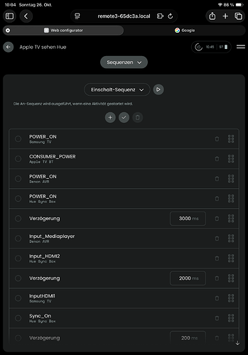

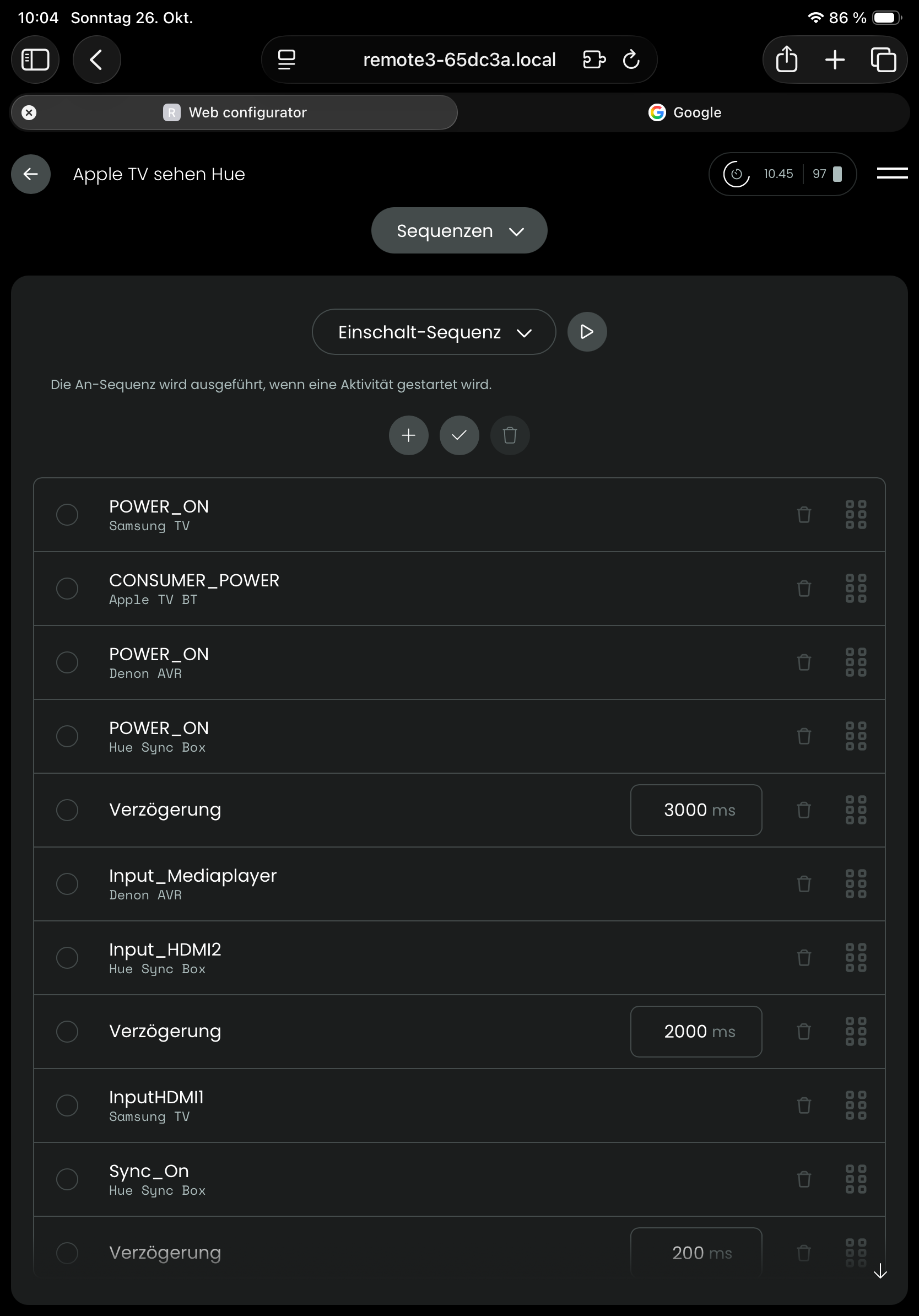

I’m having trouble reliably controlling the dead devices. Sometimes everything works as expected, but other times various devices won’t turn on or off. The error isn’t reproducible and affects different activities and different devices. Here’s the start sequence for an example activity. What could be causing this?

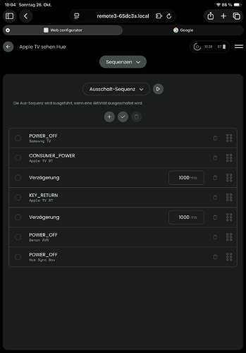

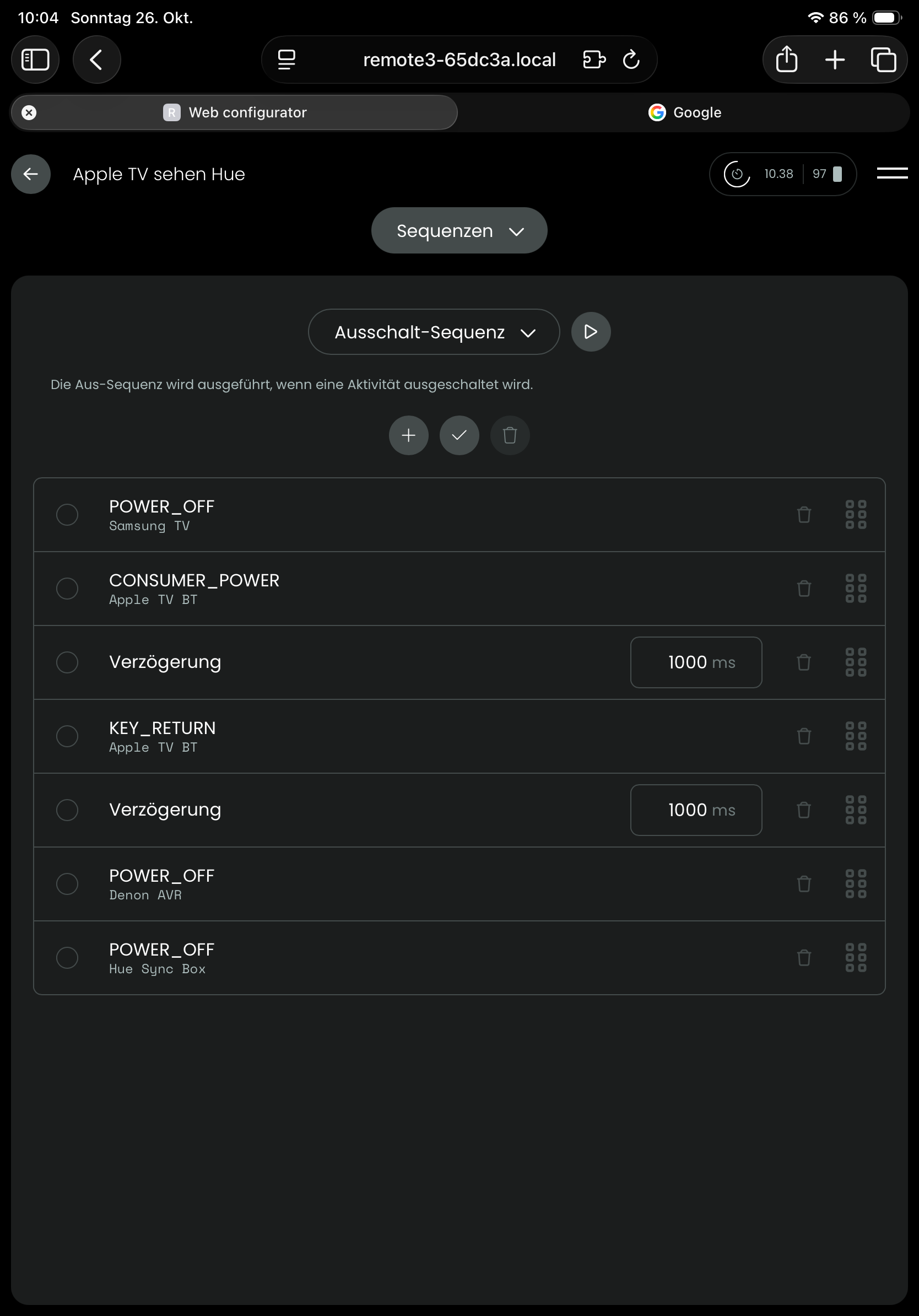

An here the stop sequence:

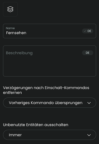

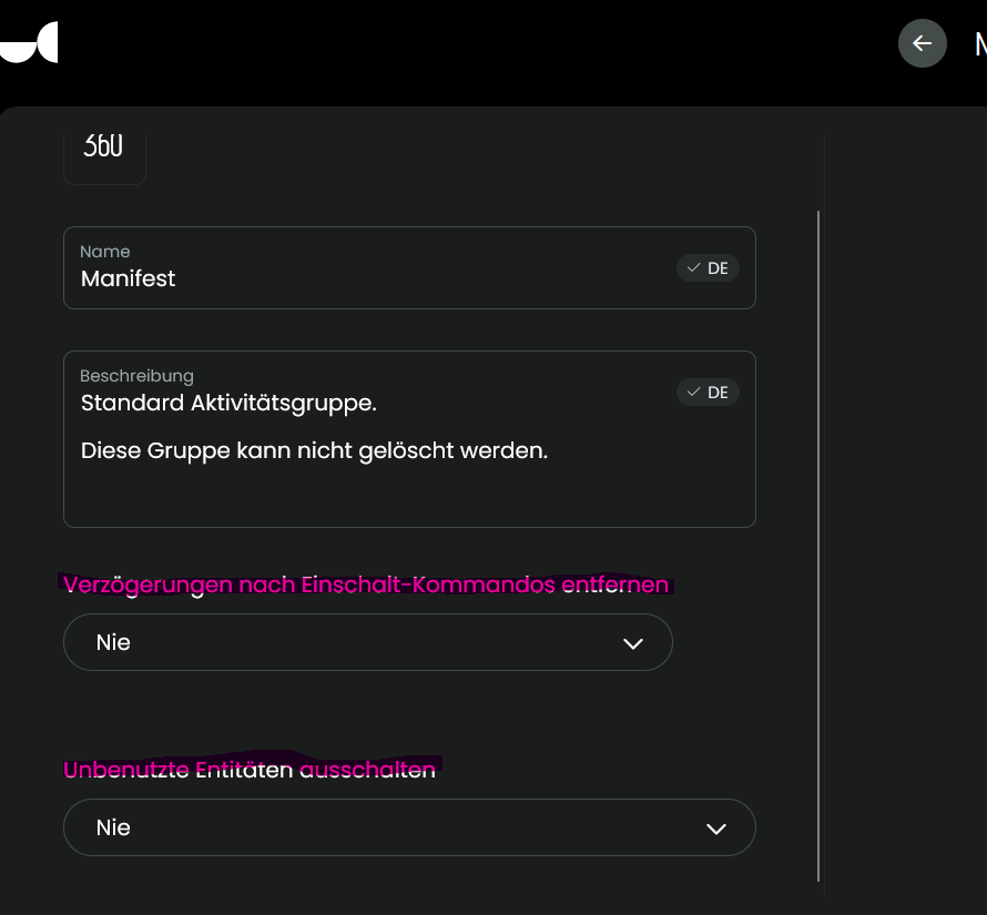

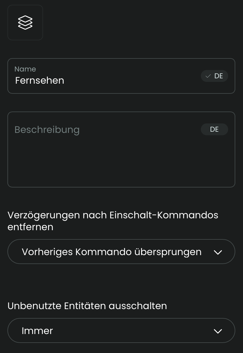

This one:
That’s how it’s set up for me. Unused entities should be deactivated. But I’m not entirely sure what point 1 means…
The issue was for me, that after switching from one active Activity to another, that all the delays were skipped. Which results in a half down motorized screen. Also all my LED´s were switched off from the previous activity. Try to set everything to “never” & check if your problem still exist.
The first point mean, if one activity is running and you switch to another (without ending them), the programmed delays are skipped. For me, the description is a little bit confusing.
I’ve now set the first setting to “never,” which makes sense. I can’t set number 2 to “never” because then all devices stay on. It’s different for me than for you. Thanks for the tip, I’ll give it a try.
