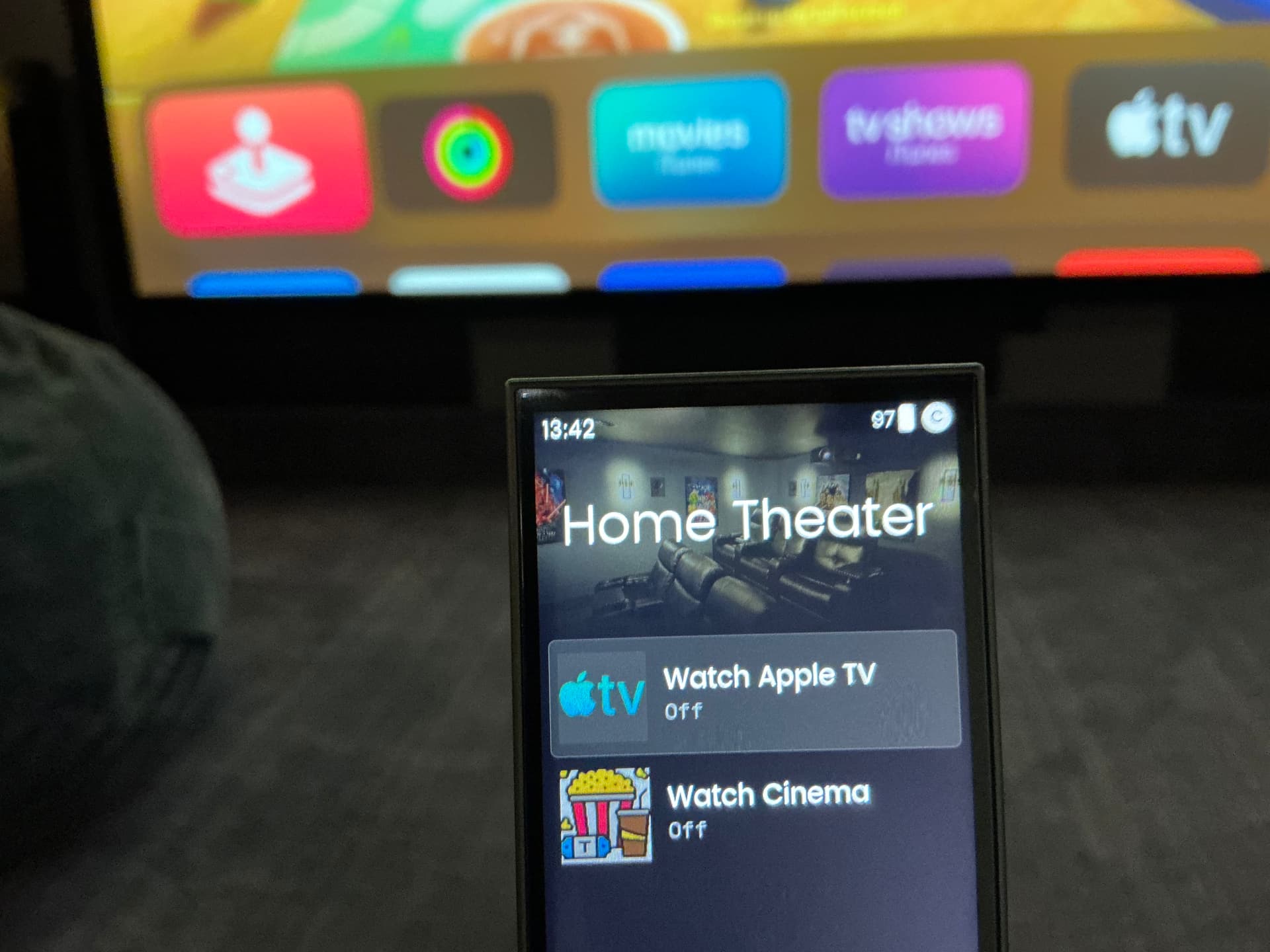

Ok, I just recreated it - I switched on the Watch Apple TV activity. But the screen on the remote just says OFF. Then I switched to Watch Cinema (Z20) and the Denon switched over to HDMI supporting the Z20, but the screen on the remote still stays OFF for Apple TV AND Z20.
And when I used the designed arrow keys on the remote, it just toggles between the activities (Watch Cinema and Watch Apple TV) on the screen of remote, but no cursor movements on the projector screen

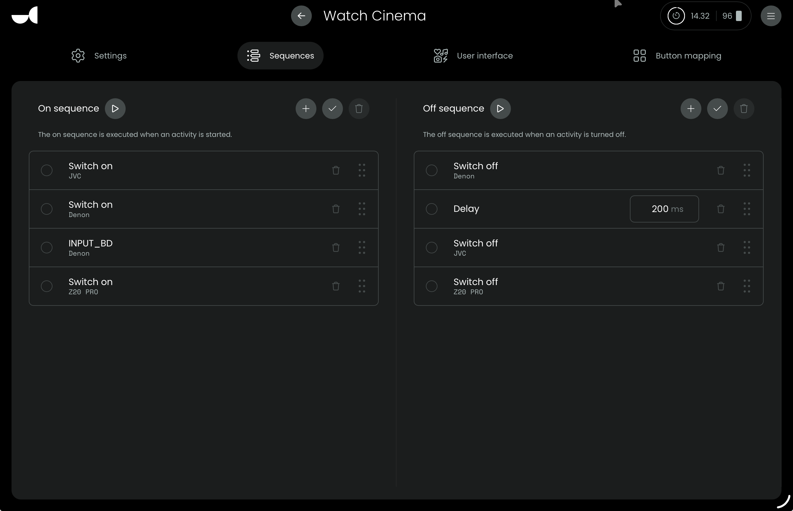

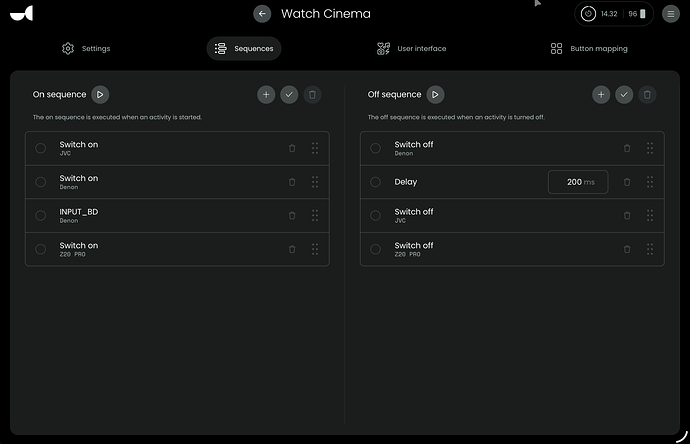

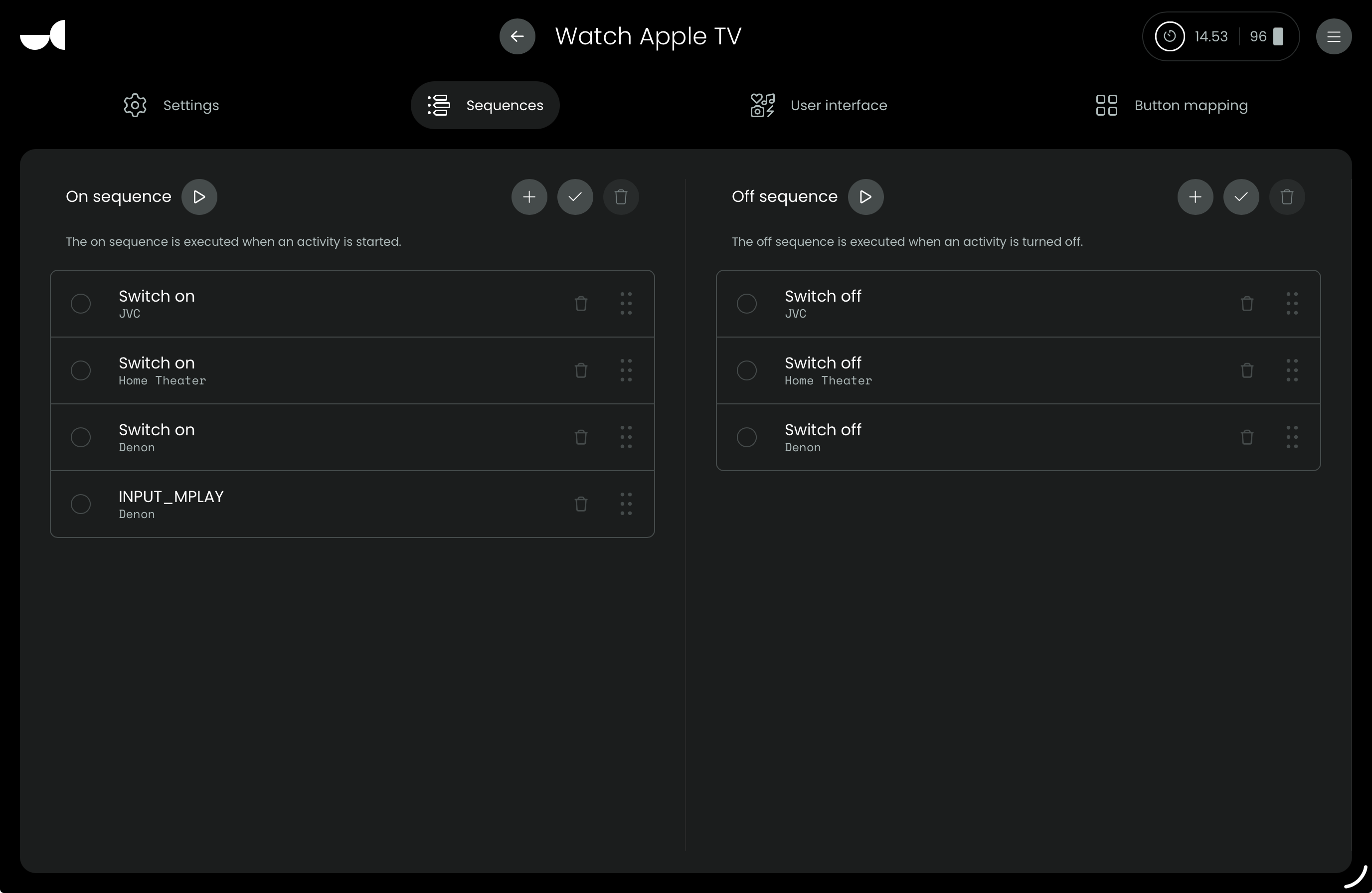

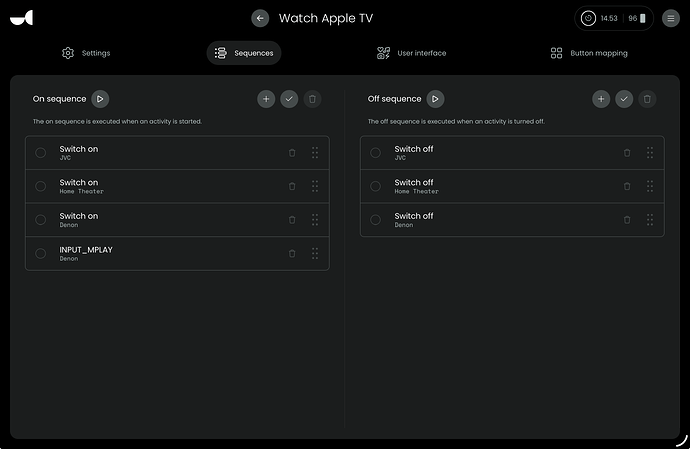

Here are my on and off sequences
Do you see the steps of the sequence when you start any activity? The button mapping doesn’t work as the remote doesn’t switch into the activity ui. Try restarting the remote.
