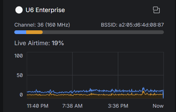

  • Yes, I’ve tried different channels, but that shouldn’t matter when there’s relatively little interference on 5GHz:

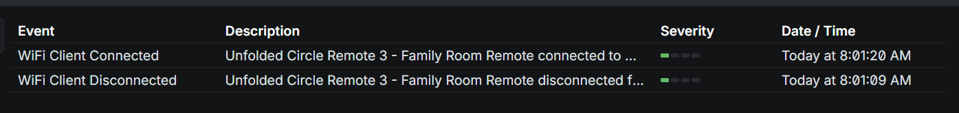

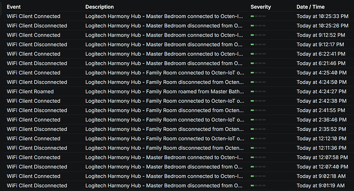

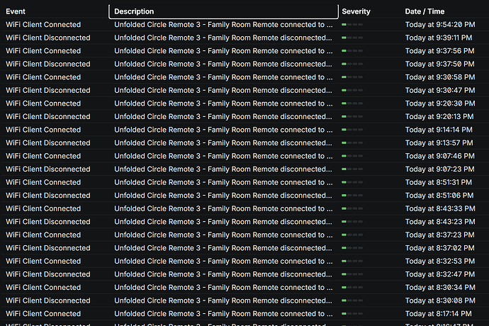

As you can see here, the device disconnects quite frequently and for quite a long time:
This list is very long. So long I could only include a small portion, 82 times it did a disconnect-reconnect in 10 hours!

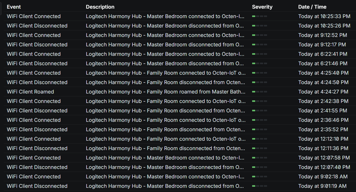

Compare that to my Harmony Hubs (both of them):
As you can see, the Harmony Hubs rarely disconnect, and it’s very short: less than 1 min. This data is from both hubs too. It’s 9 times in the same 10 hour period for both COMBINED!
The important thing is I don’t notice these small connectivity issues with Harmony. Like I said, it’s rare if I do because they’re so infrequent and so short. That’s what matters the most: whether I notice or not.
It’s possible you don’t have this connectivity issue, but I find that extremely hard to believe.

Its interesting. I just looked at my logs (my remote is also on the 5GHz chhannel and I use Unifi). For me the R3 last disconnected from WiFi 5 days ago when I last rebooted it.

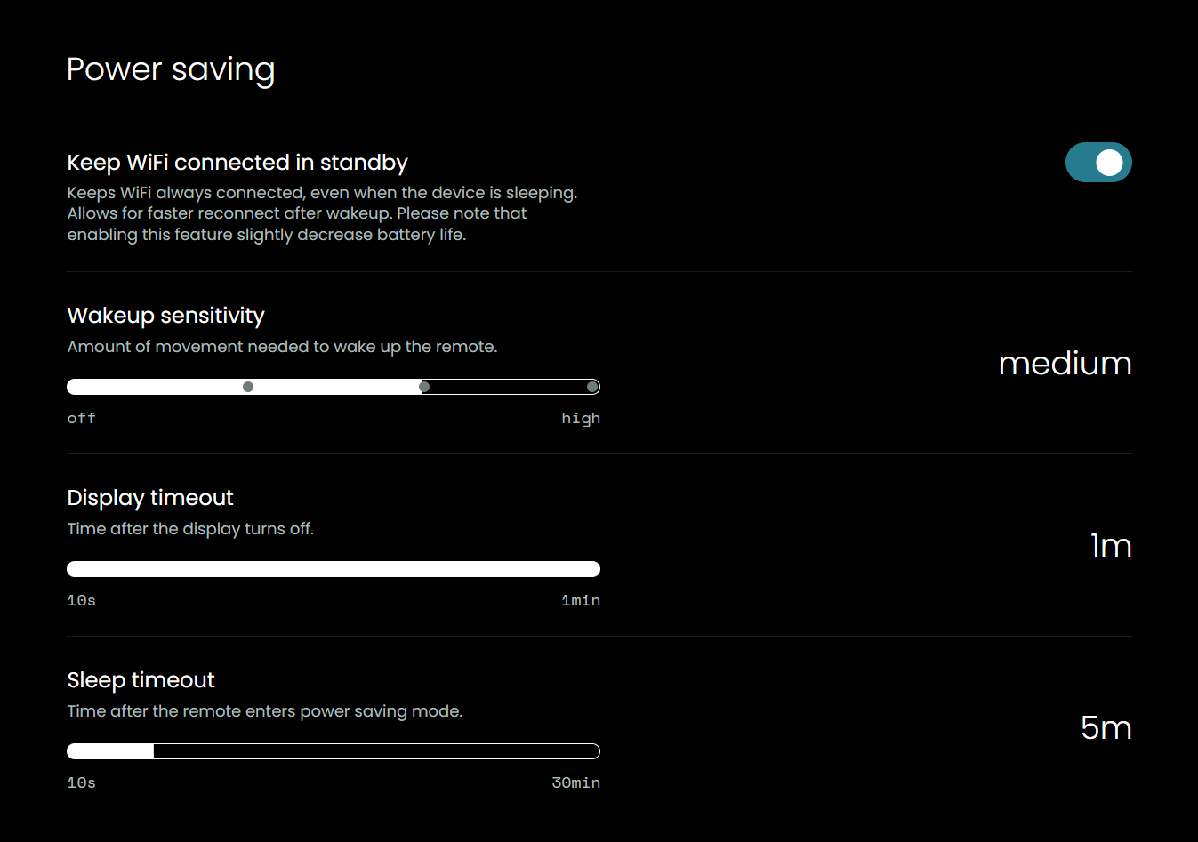

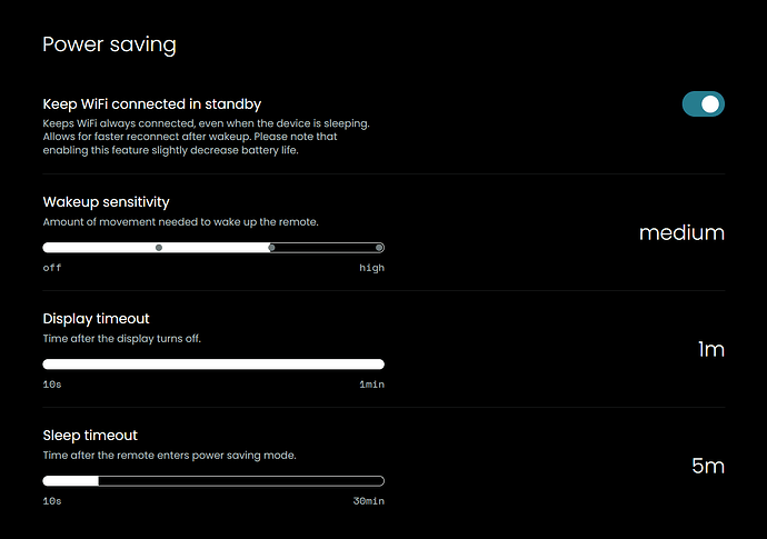

And you are sure you have the keep WiFi connected in standby setting enabled? Keep in mind that integrations still have to reconnect with this as the remote can’t keep all integrations running in standby. It only saves the time the remote would need to get to reconnect to the network like getting its ip from the router.

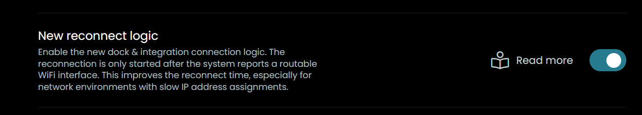

I doubt its your IP integrations that are the problem. Hopefully the keep WiFi connected in standby fixes your issue. I dont use the Android TV integration but I do use the LG and Denon plus a bunch more and have no problem with these. The keep WiFI connected in standby obviously uses a bit more battery but for me I found turning off Bluetooth (as I don’t use it for any of the devices I’m controlling) pretty much offset that battery drain.

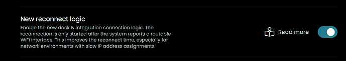

There might be some confusion here. I took screenshots of my current settings. I didn’t change any.

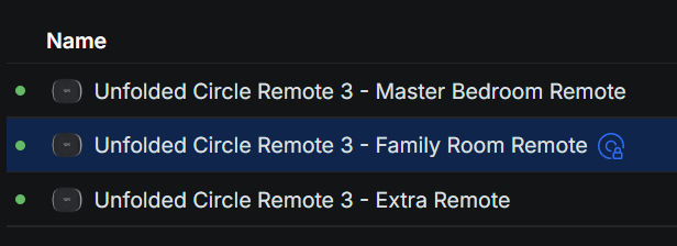

Does your remote always stay in the same room? If it does, try locking it to the nearest AP. Also disable Active WiFi scanning if you have that on. I also use fixed IP for both dock and remote. I never have disconnects outside of restarts
It doesn’t leave the room. UniFi added a setting to lock a device to a specific AP; although, I’m hesitant to do it. It’s worth a try though.
I turned off Active WiFi scanning twice, and both times, the remote lost Wi-Fi and couldn’t connect again. I don’t really understand that setting.
Lock to access point should be safe if the remote is always in the same room. It just won’t roam to another AP if it goes out of range. Maybe Active WiFi scanning should be used with a fixed IP

You can see it’s locked here:

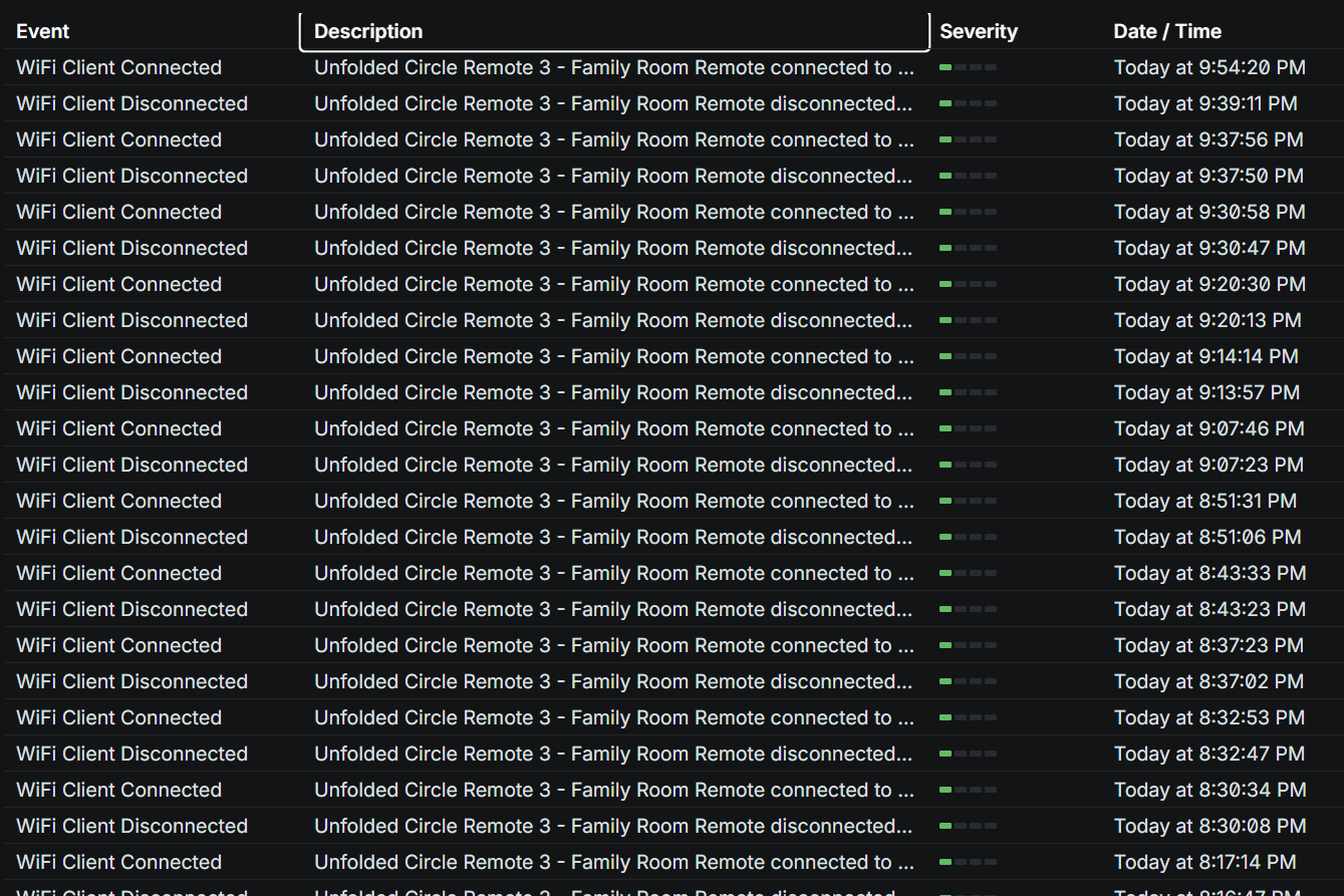

Only one disconnect showing this time:
But I don’t know if these disconnects correlate with when I can’t use the remote. I’ll have to watch something tonight 'n see. The remote was sitting in the dock most of the day.

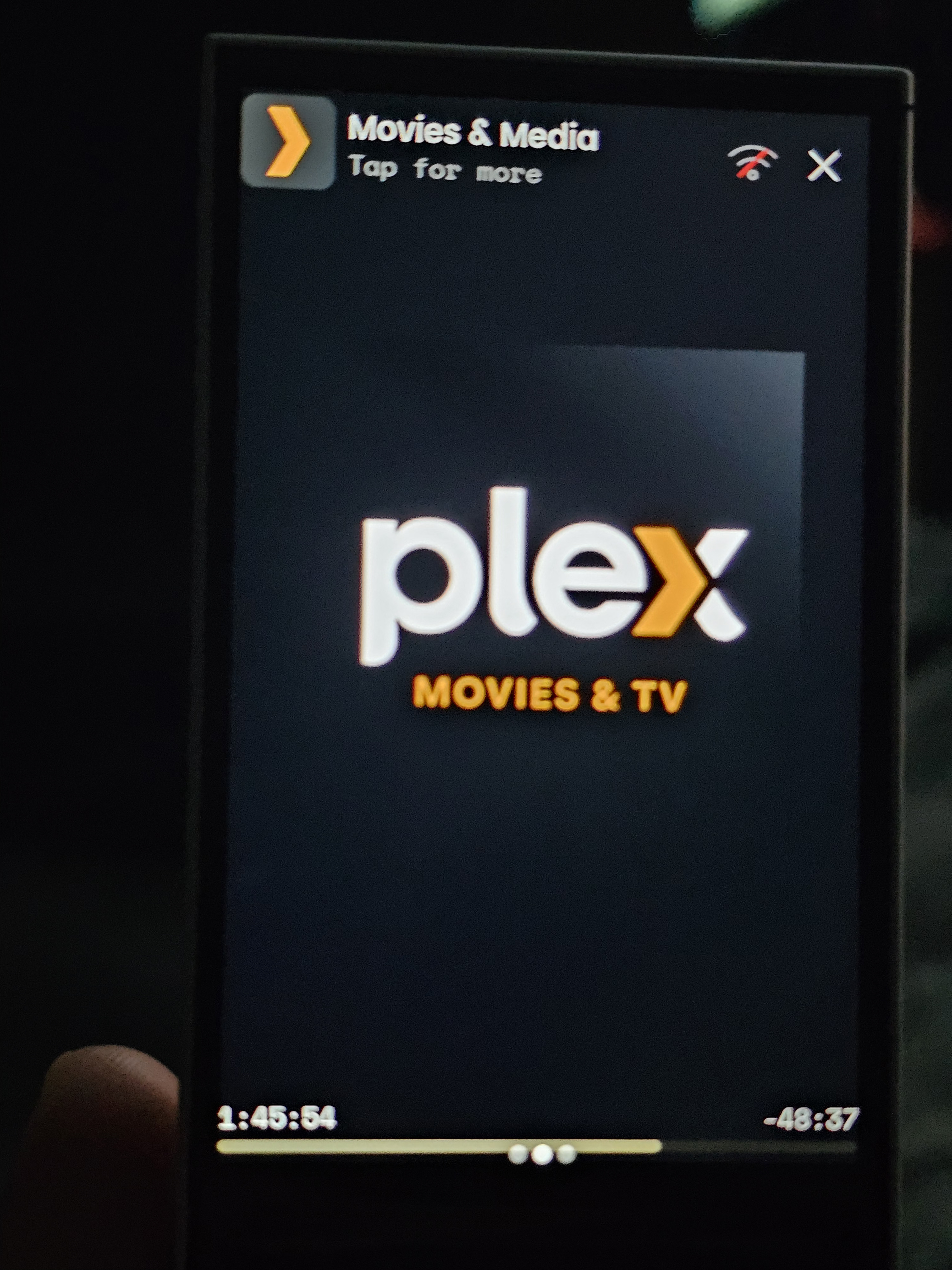

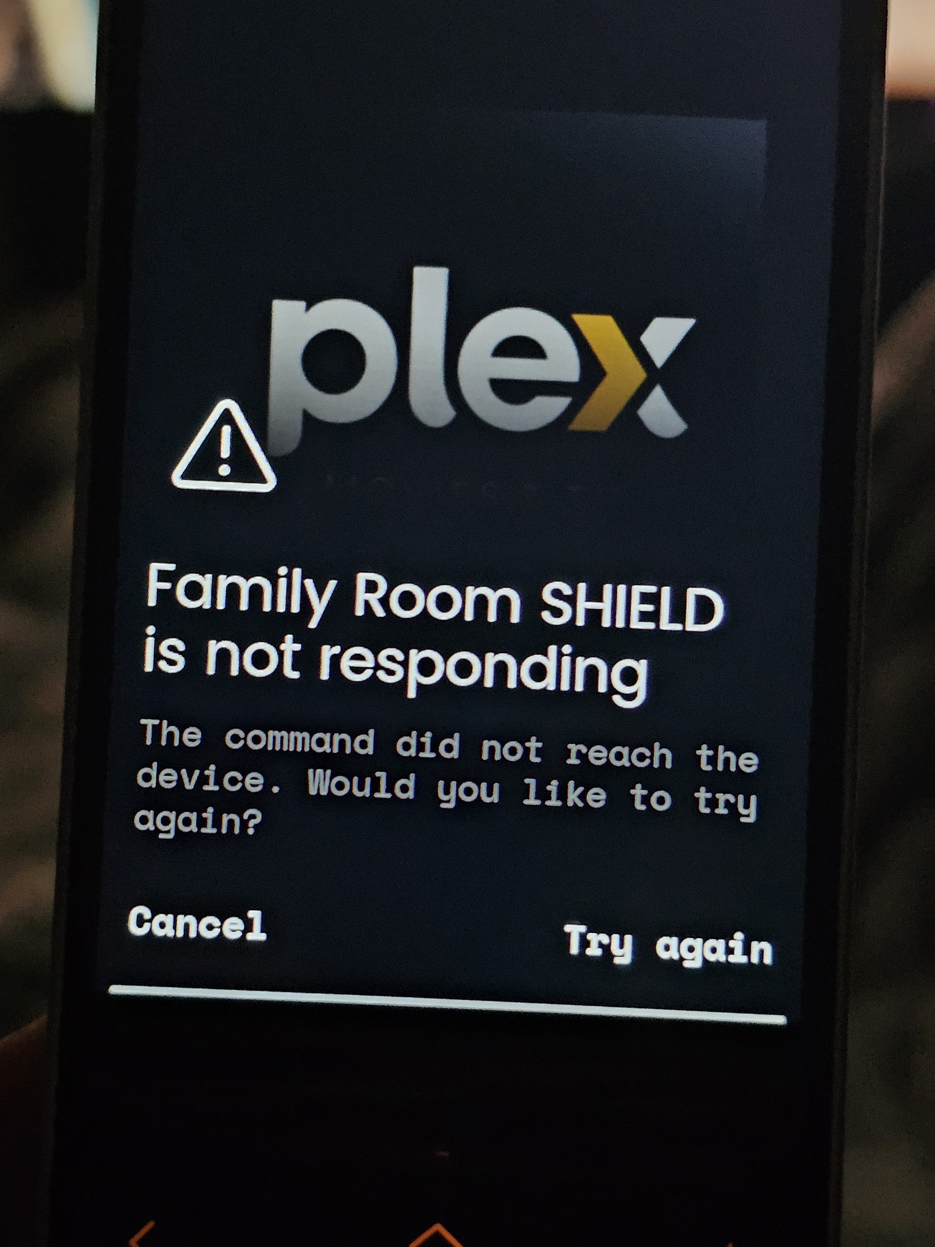

It’s been 20 min, and I’ve still been unable to pause this movie:
I had to break out Home Assistant to pause it but there’s no control in the entity to go back 10 sec (or 5 min in my case).
