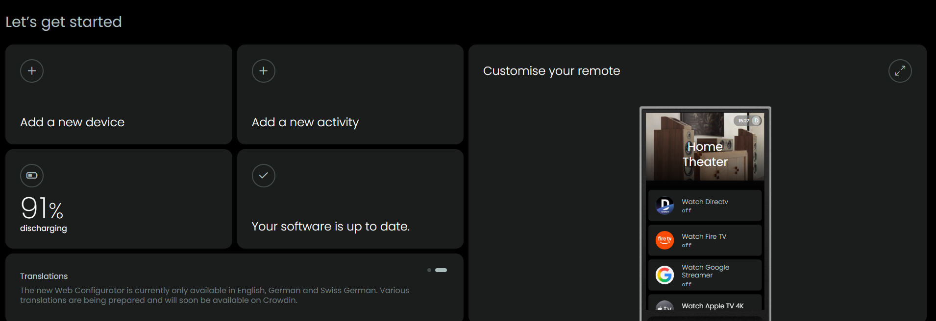

Select Add New Activity from the home screen in the Web Configurator. You then add your entities there but make sure you also setup activity groups under Activities and Macros if you want to smoothly transition from one activity to another (like the Harmony we’re all switching from).
