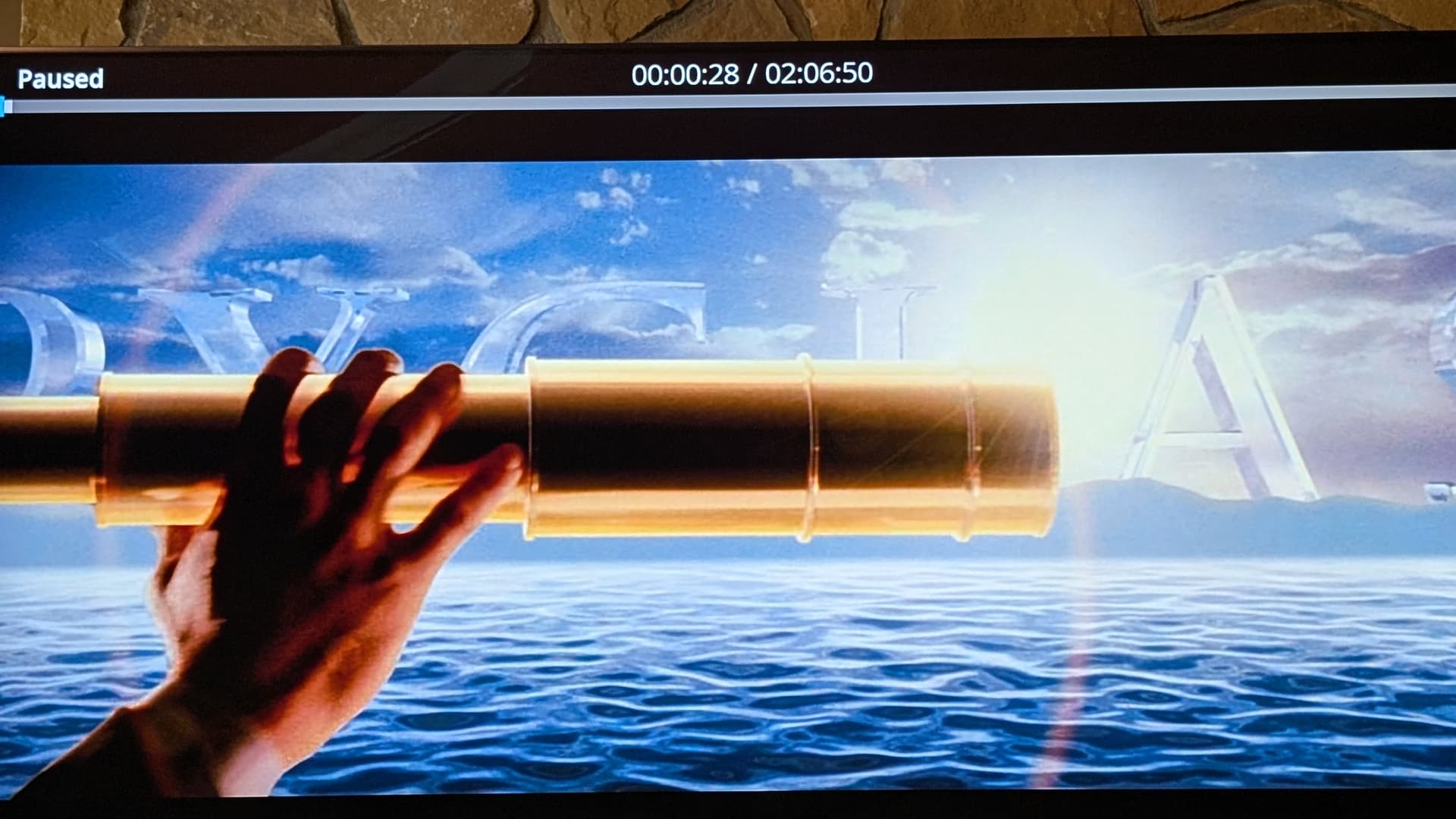

This is what I get when I hit the center button:

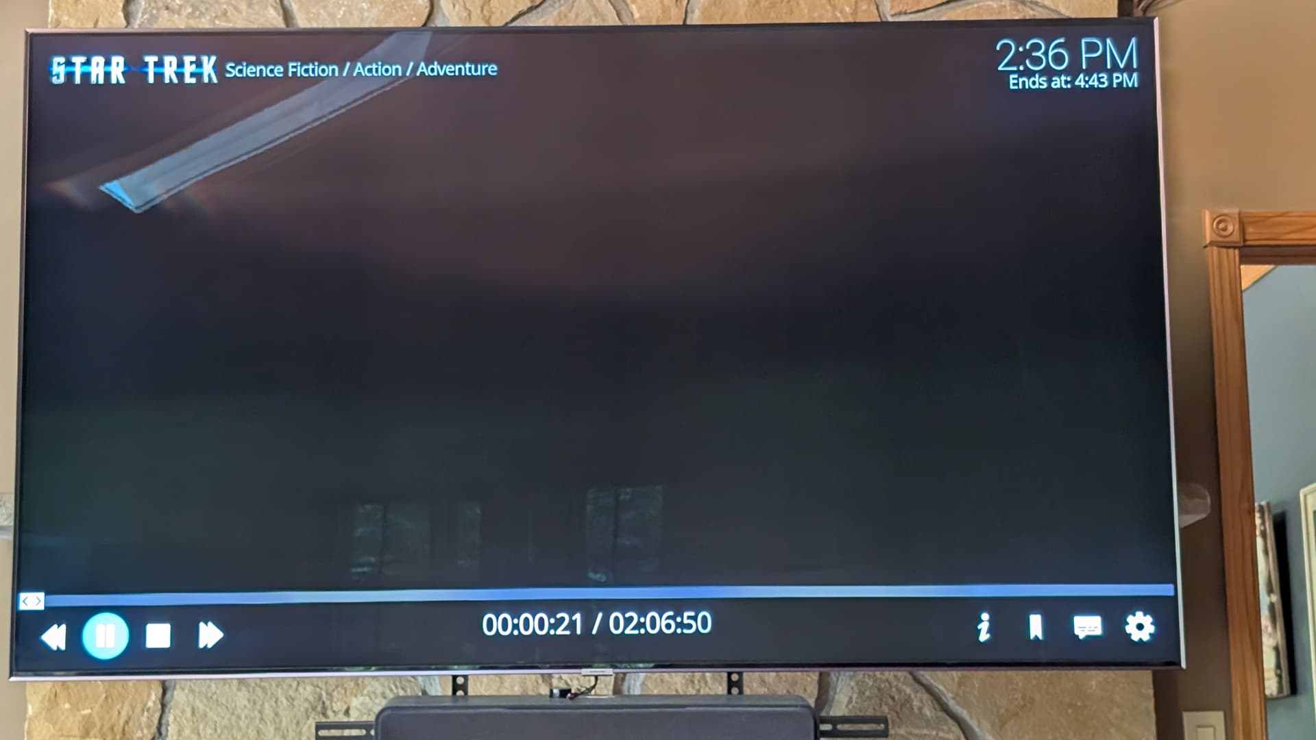

This is what I used to have:

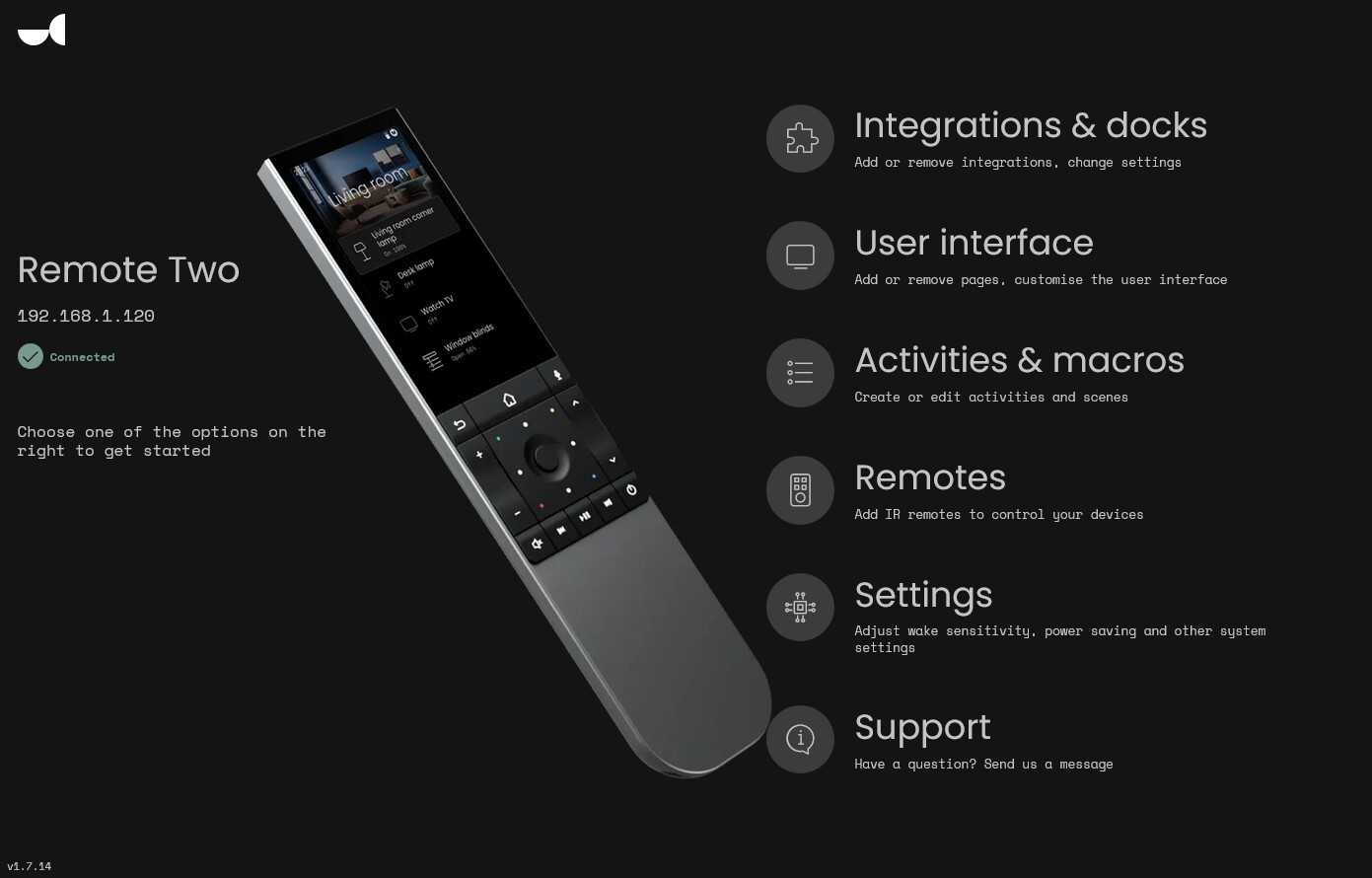

In the web configurator:
Entities → +Add new
This takes you to Add new device
Choose Bluetooth and configure for Nvidia Shield
This is a separate entity (virtual remote) from the Android TV integration
Make sure you have Bluetooth enabled in Settings → Wifi & Bluetooth

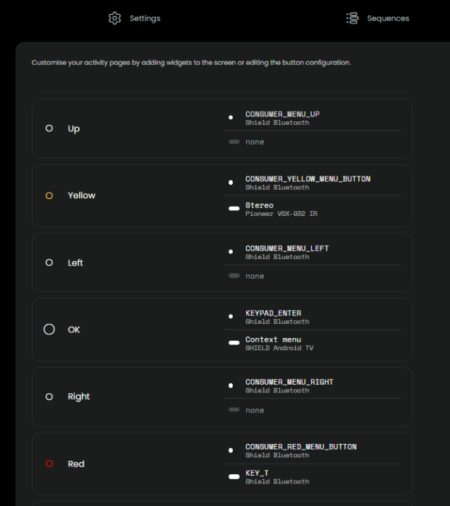

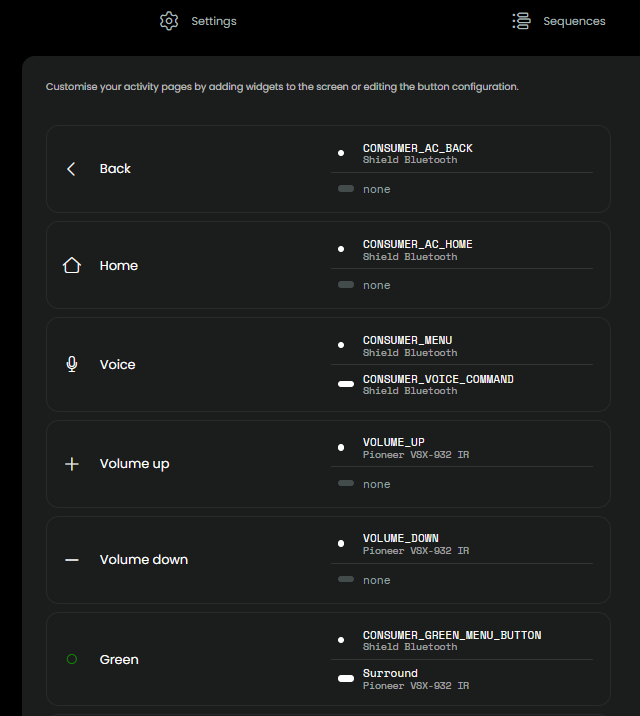

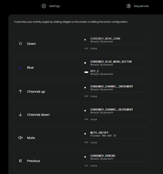

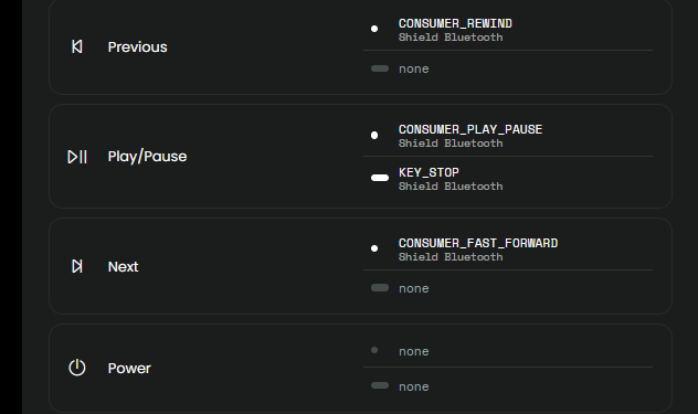

My Shield button mapping in my Watch Shield activity:
Some of the long press commands are for testing purposes. The long press Play/Pause is essential for Kodi on the R2. There is no Stop button on the R2 and I don’t have an R3!
Thanks so much for posting this! It looks like I can configure buttons either in the BT Entity, or in the ‘Movies’ (usin ShieldTv) activity. Which should I be using?
As you can see, I prefer Bluetooth for most things.
Though I do use the Android TV integration for Context_menu on the long press OK button.
The beauty of the R2/R3 is you can mix and match integrations within an activity to control a specific device.
Experiment and see which protocol works best for you on the commands you need.
