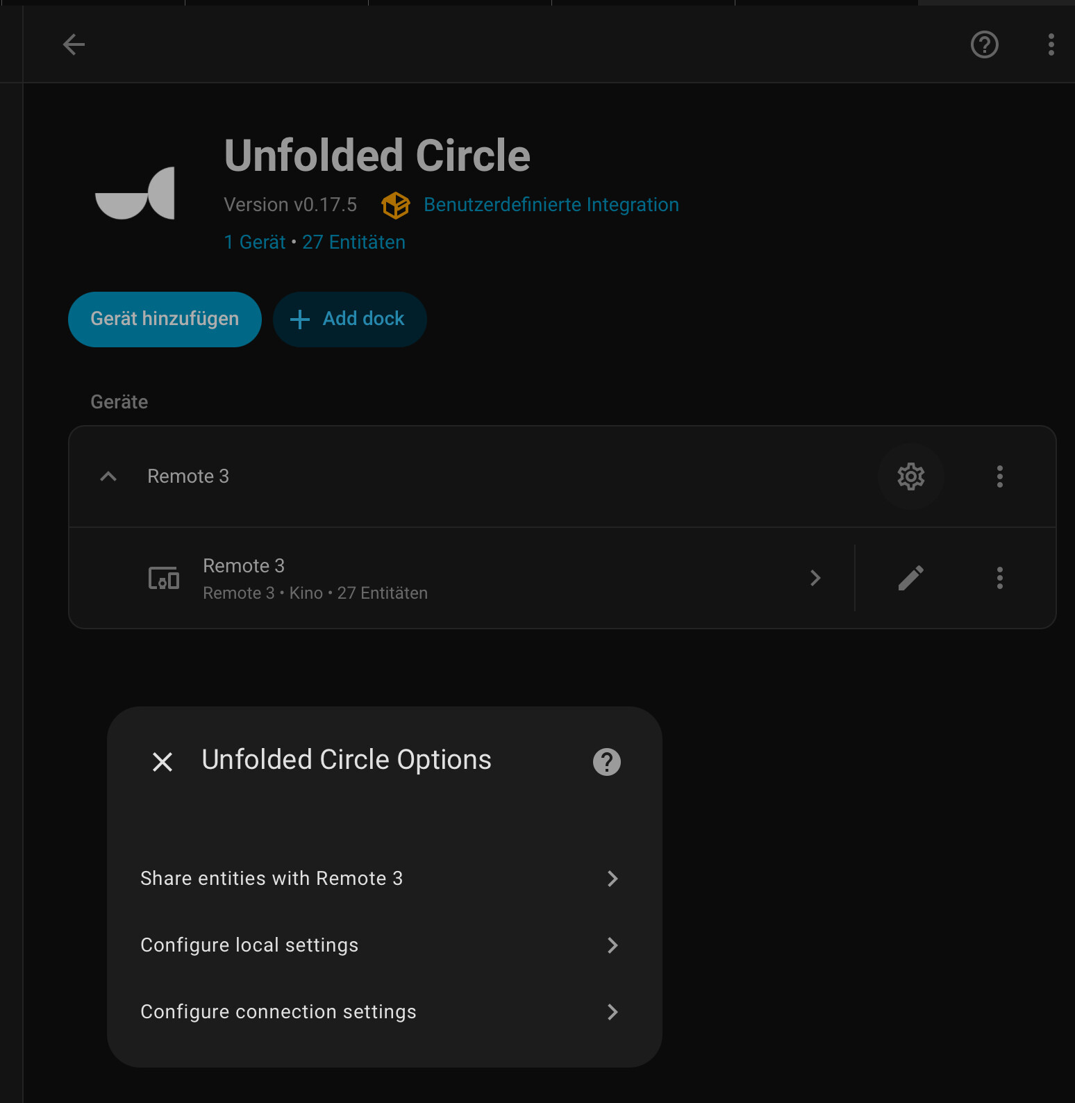

Ok, I think I figured it out. Entities have to be provided by the helper HASS integration:

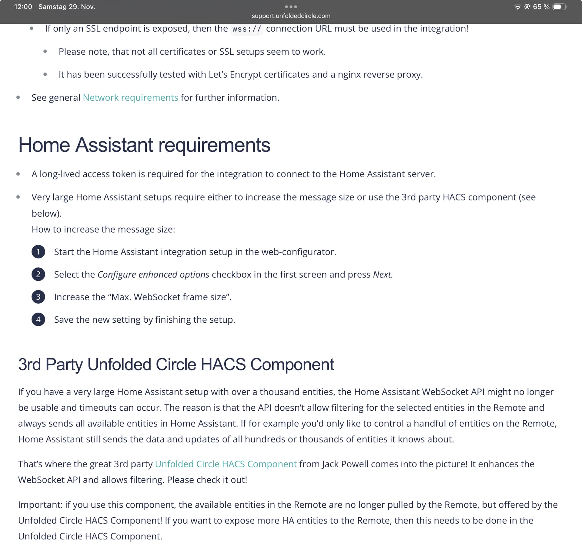

Thank you @MR77 Good find. I’m seeing the same as your first post above. Increasing WebSocket frame size helped a lot. I can now see my hass template sensors as well which considerably opens up more sensors to be displayed.
