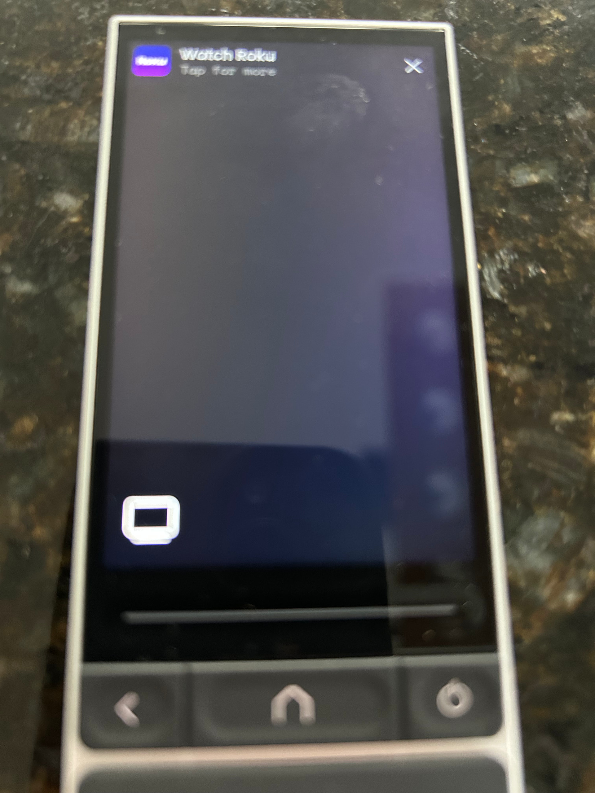

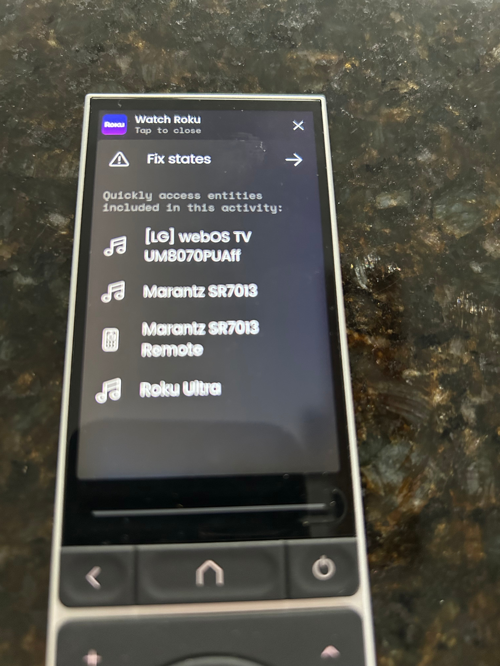

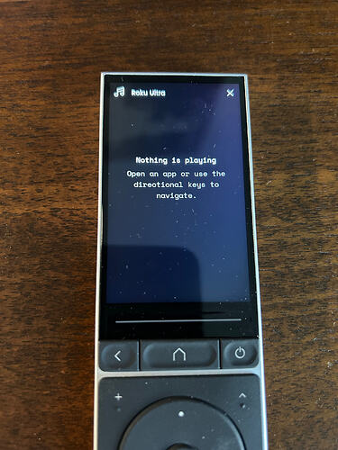

When I run the Apple TV it works great in all areas. The Roku and Zidoo will not display the media widget of what is playing but everything else works that I have programmed. I had the Zidoo working but I have tweaked so much it no longer views what is playing on the media widget as well. When I hit the media widget screen on the remote it can pause or say live TV but no display.
Below are some screenshots of what I am seeing. This is when I start the activity
And then I hit fix states
And then I see this.

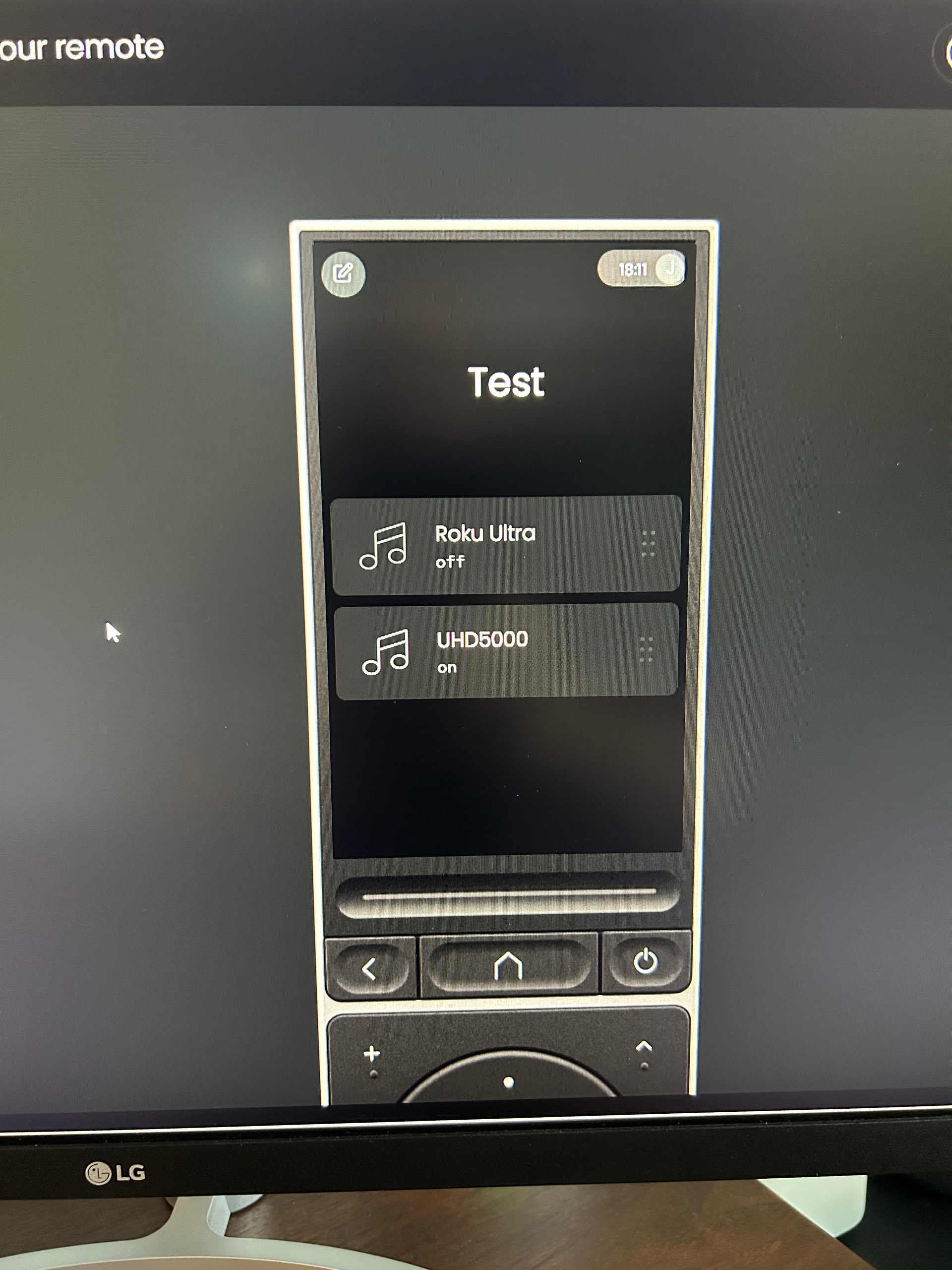

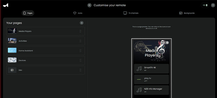

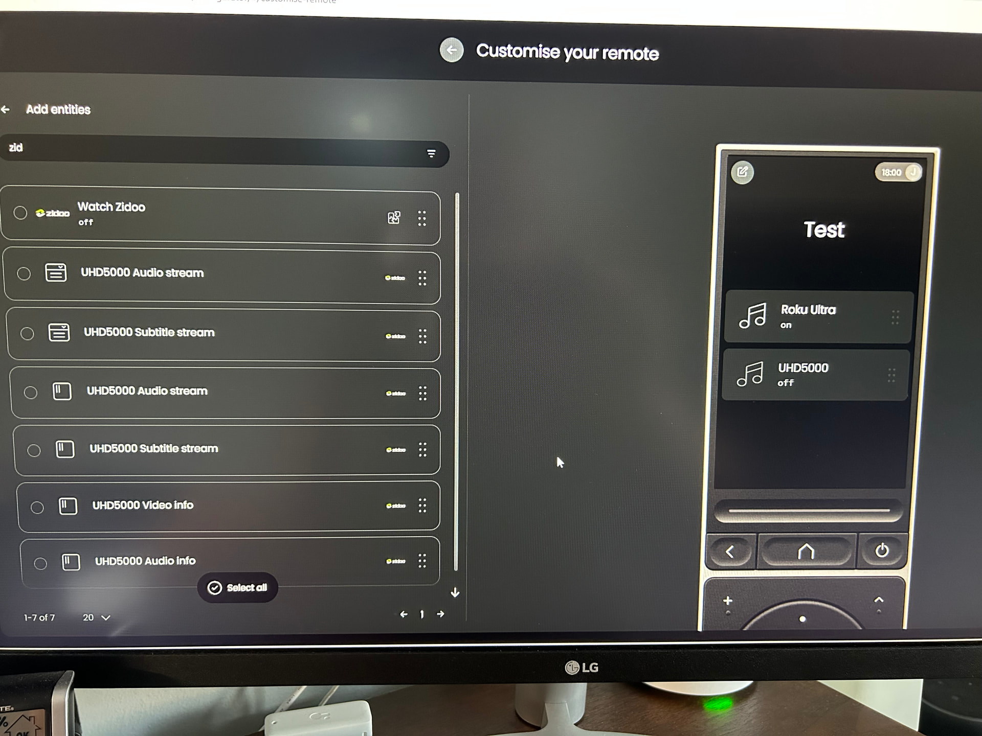

on the web configurator create a test page (not an activity) and create a “test” page.
then add to it the ziddo and the roku media players (the one with the music note)
play something on the roku or the zidoo, open the individual media players, do they show an image of currently playing?

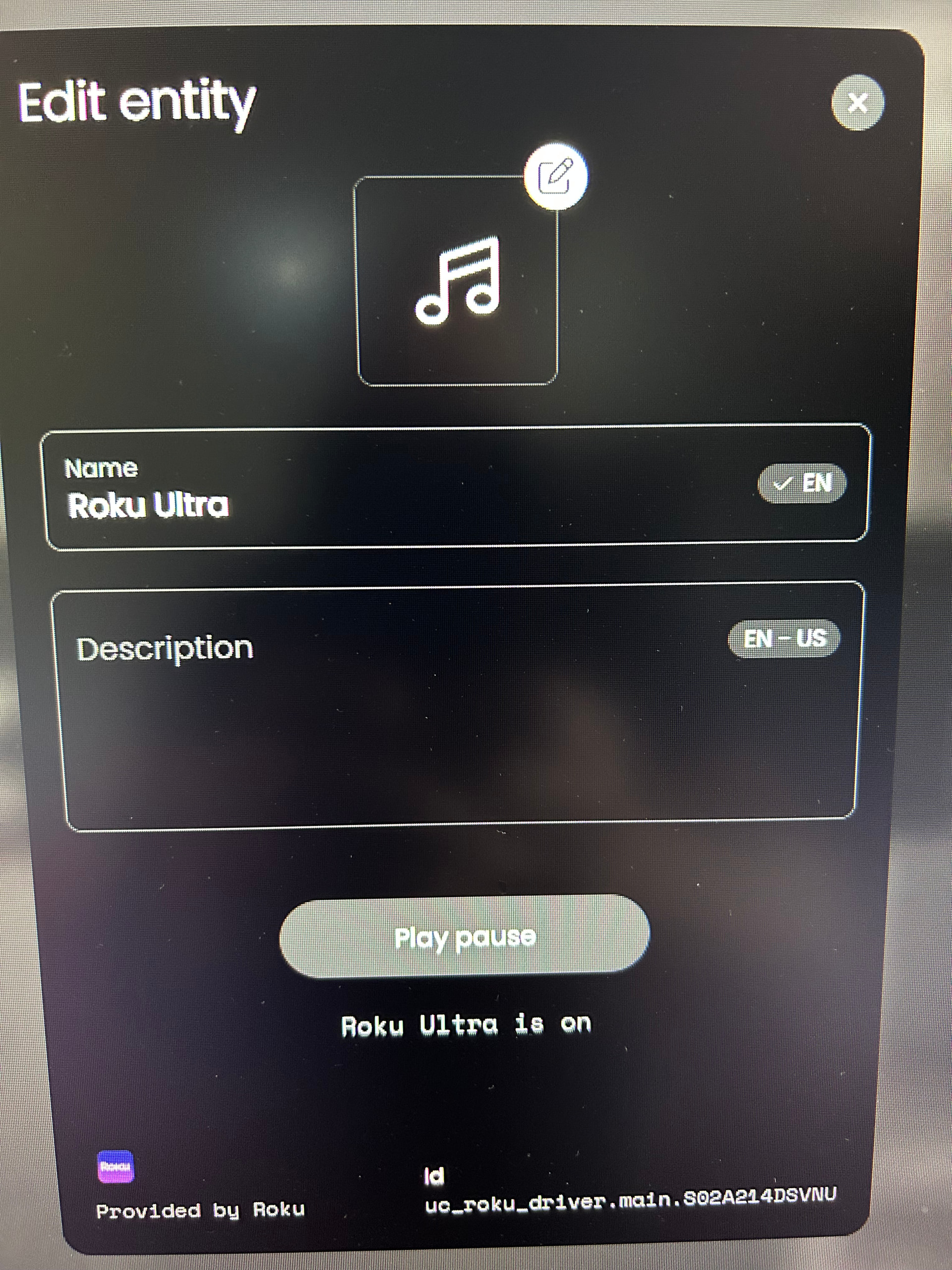

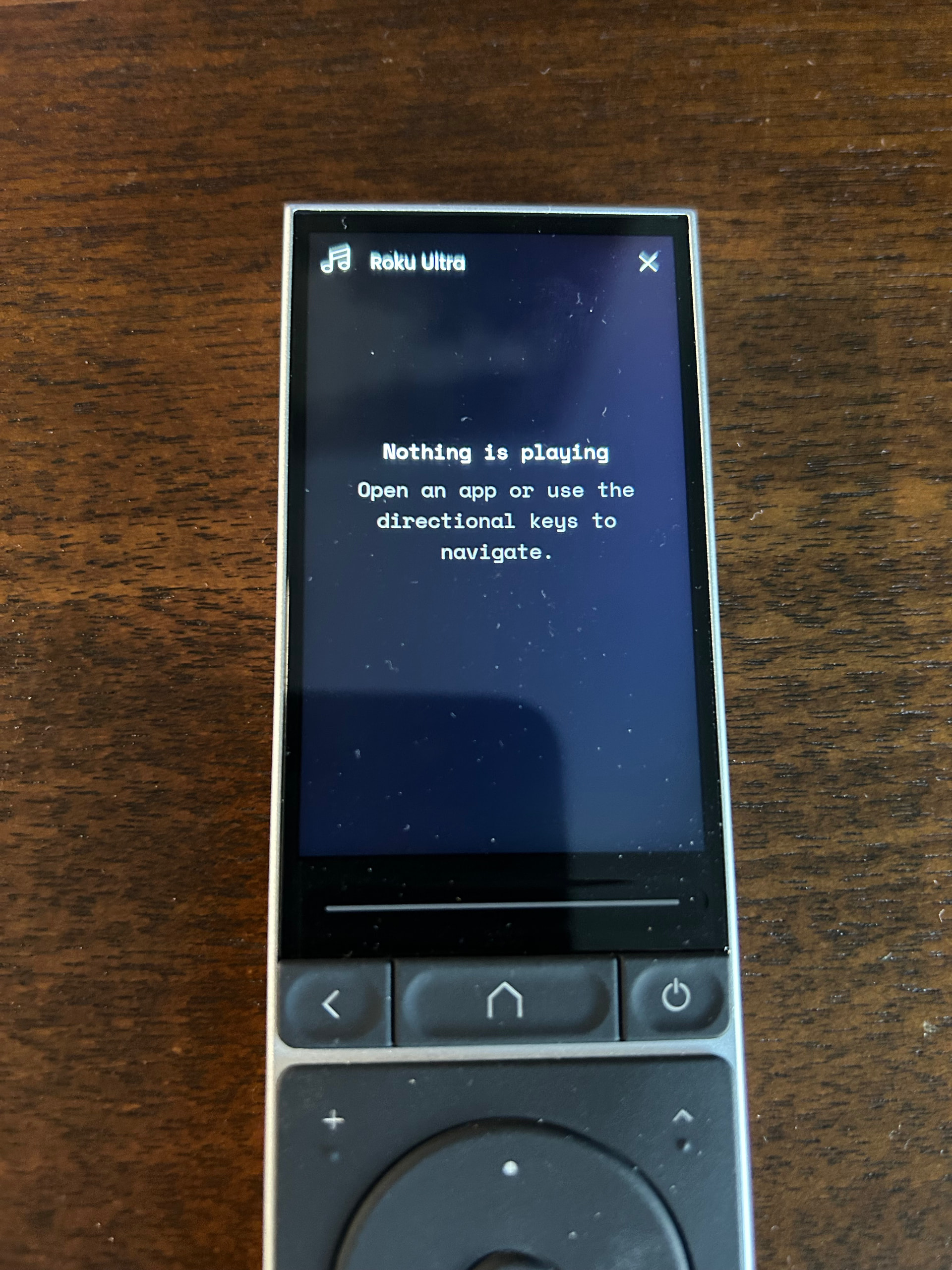

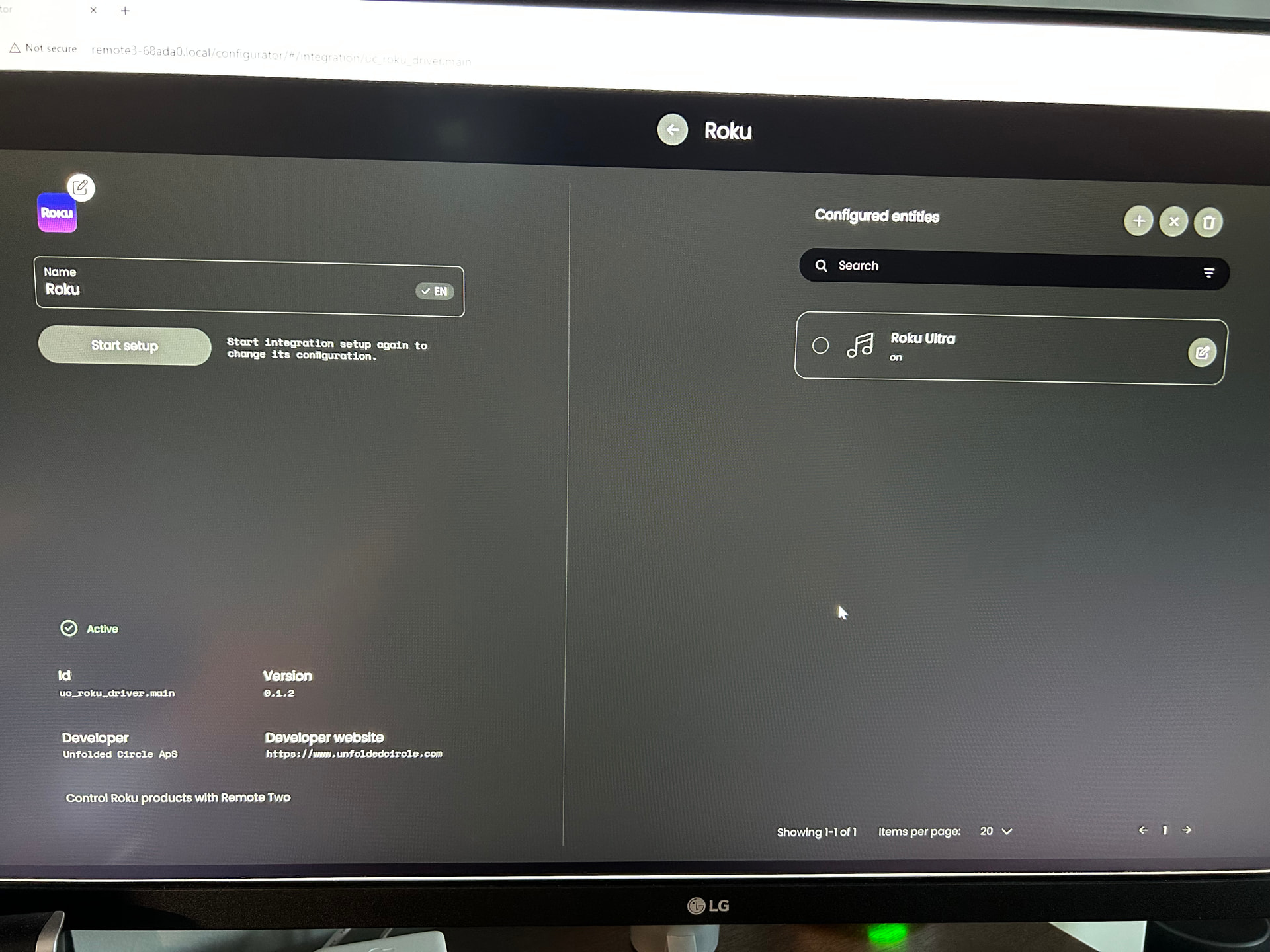

Ok, thanks for all the feedback. I think I did everything you said but here we go.

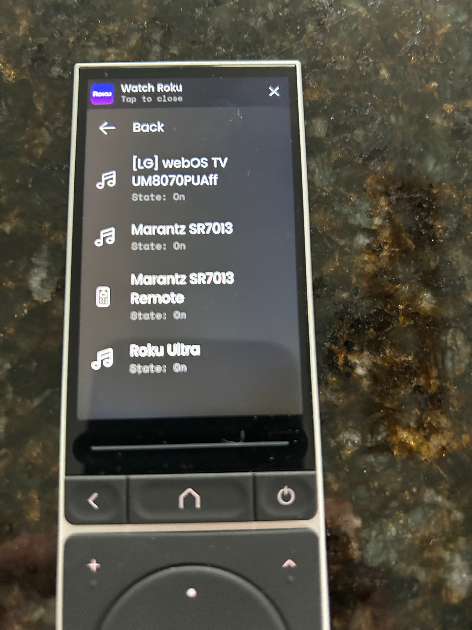

Here are screen captions of the Roku and idol in test page. .
Here is the Roku only screen captures.

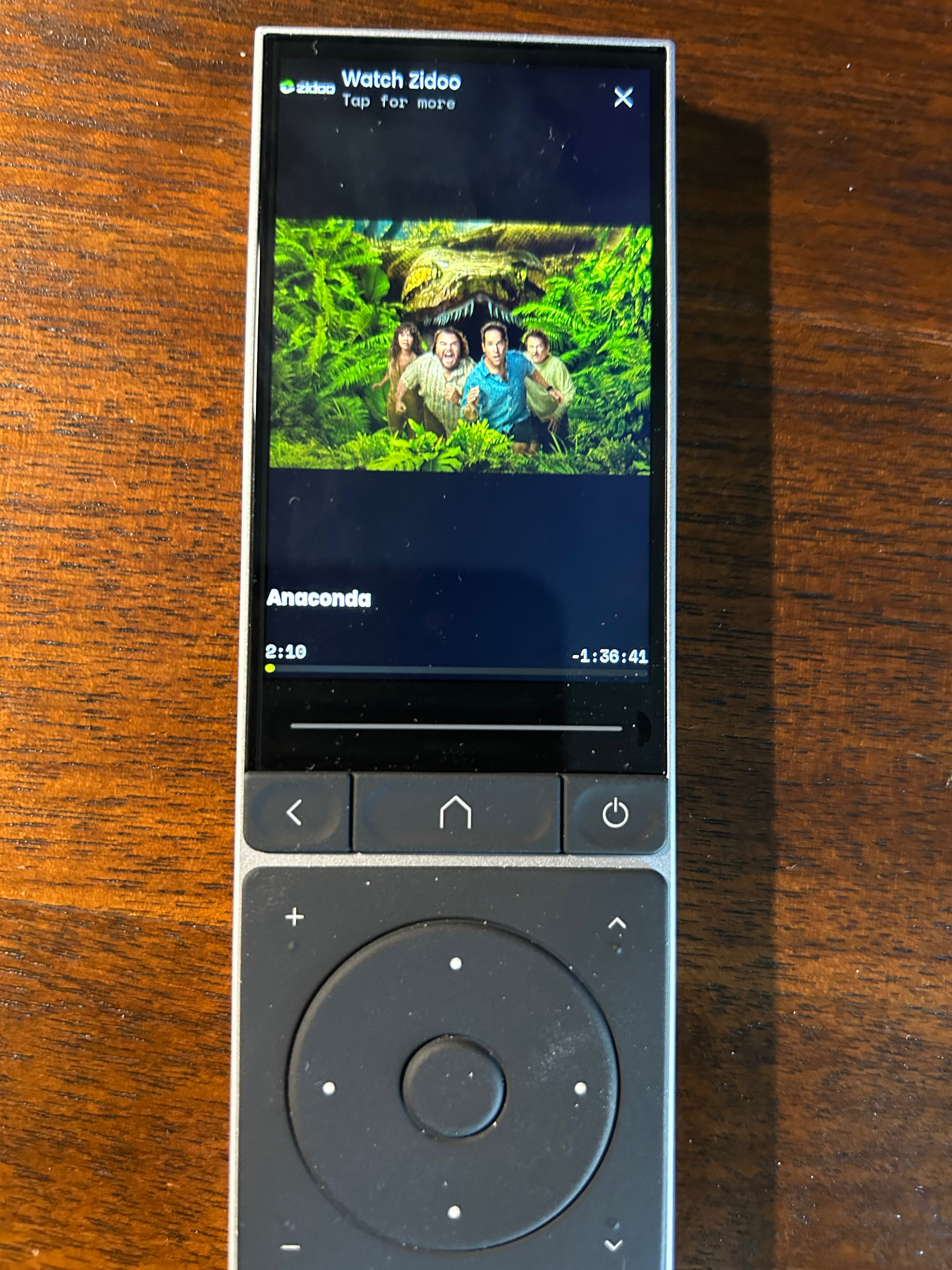

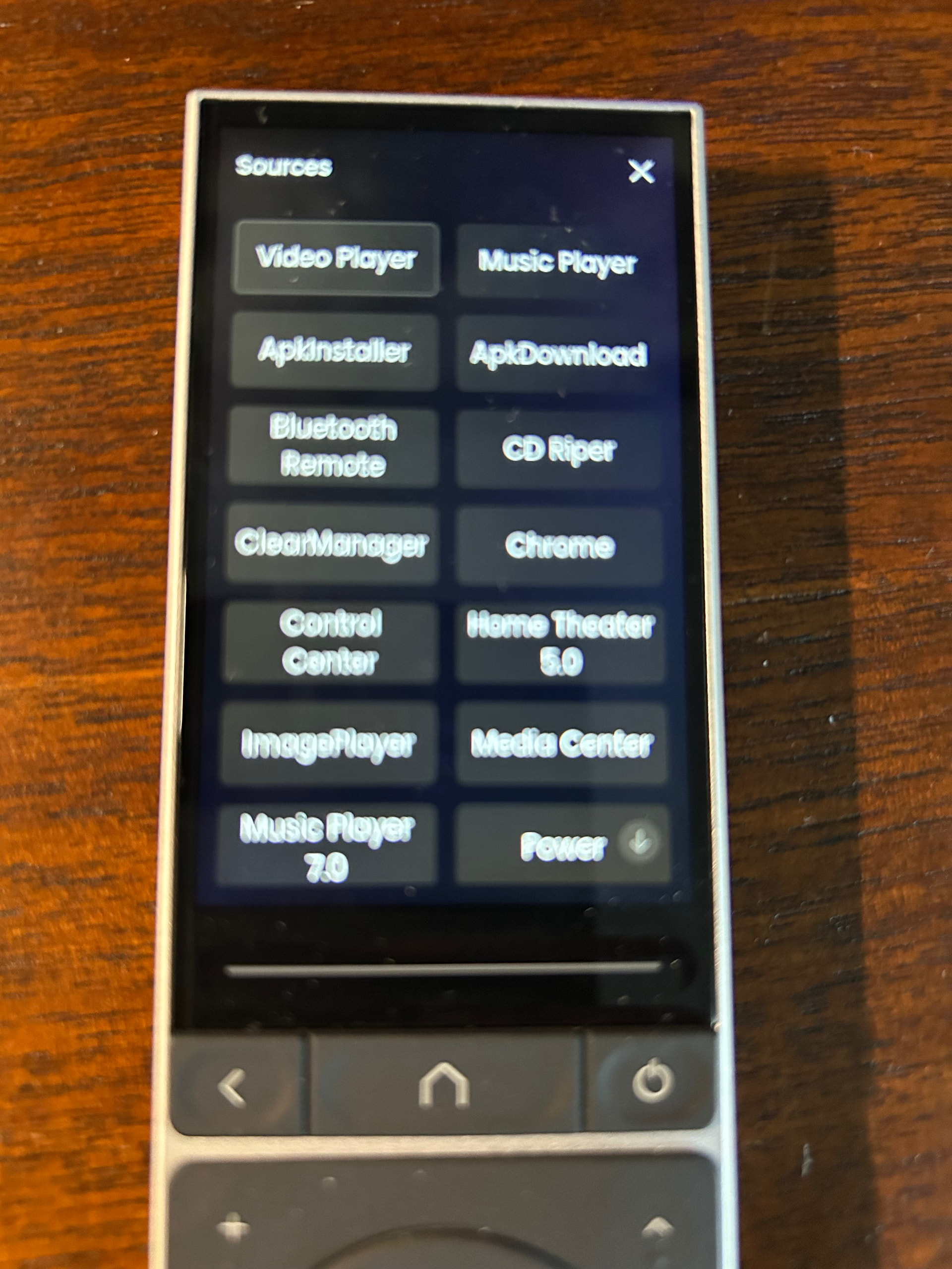

When I started with the Zidoo it did not work but I hit a Zidoo action button Video player and it displaying the movie I selected for a test in the Media Widget

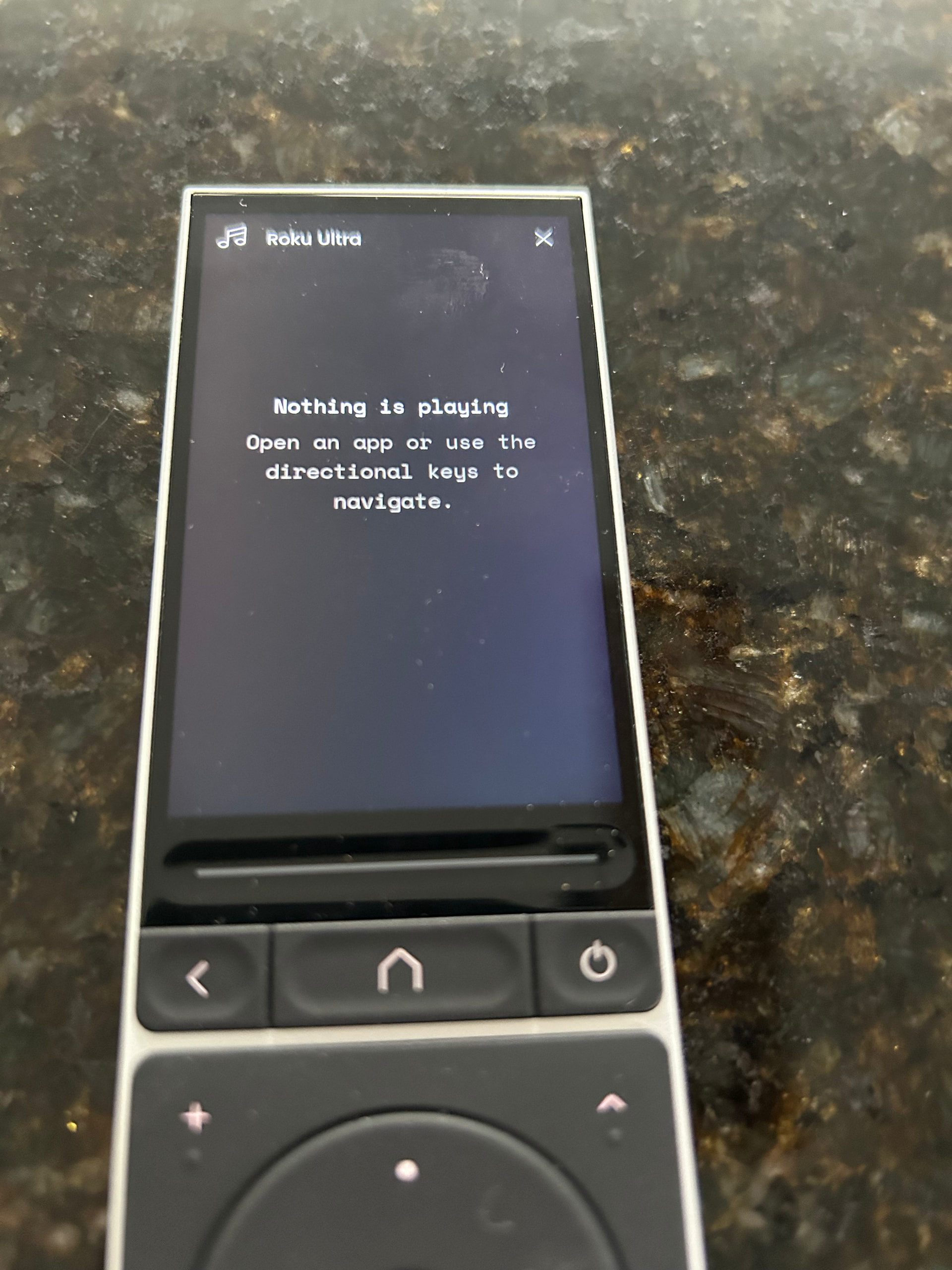

I am doing this in my phone so sorry my screen captures got mixed up. Hopefully you can make some sense of it. I am thinking the Roku does not show media on the media widget because when I hit the blank screen it pauses my video but does not display an image. I have searched everywhere and anyone who mentions Roku does not get a response from anyone.
Any ideas what could be wrong or did I give you any wrong screen captures that you were looking for?
From a config standpoint everything looks exactly as it should be. what is strange to me is that you say when you press the blank screen it pauses in roku, meaning it is actively playing something. i dont known roku so i cant replicate or tell you for sure, but it could be that it is not showing on every channel or content. your config all look accurate. is it randomly working vs not or always not working?
I would suggest updating the software as there are many improvements in the latest beta firmware for Roku.
However please note that media image and information is displayed only when the app actually supports it. And unfortunately not many do.
Thank you both for responding. I have tried many apps and all of them in the Roku have a blank media screen but all will pause when I tap the media widget screen so it has been consistent. What I find interesting is that all the apps on my Apple TV allow for media image showing on my remote screen but the same apps on the Roku do not. I will try and update to see what I get and cross my fingers.

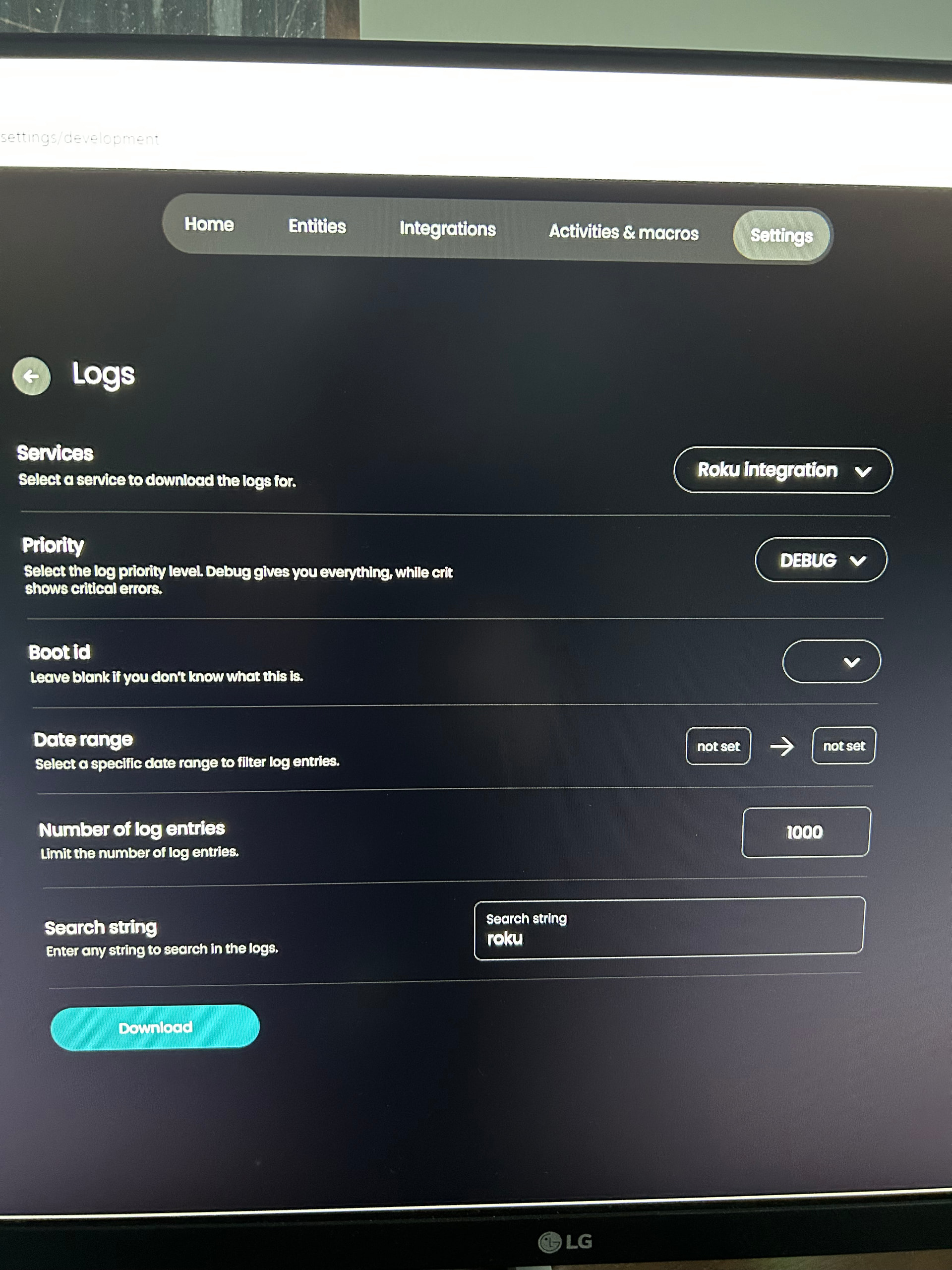

Do me a favor, curious.

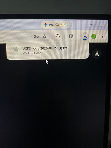

take an explicit time stamp, Play something on the roku that you are 100% confident should show media art. Then go to the remote developer options, logs, drop down, roku, and downlaod the integration logs and then find that time stamp captured earlier, share.
I’m not sure I follow what you are looking for. I took some screenshots so can you help me from theM what you want?
I

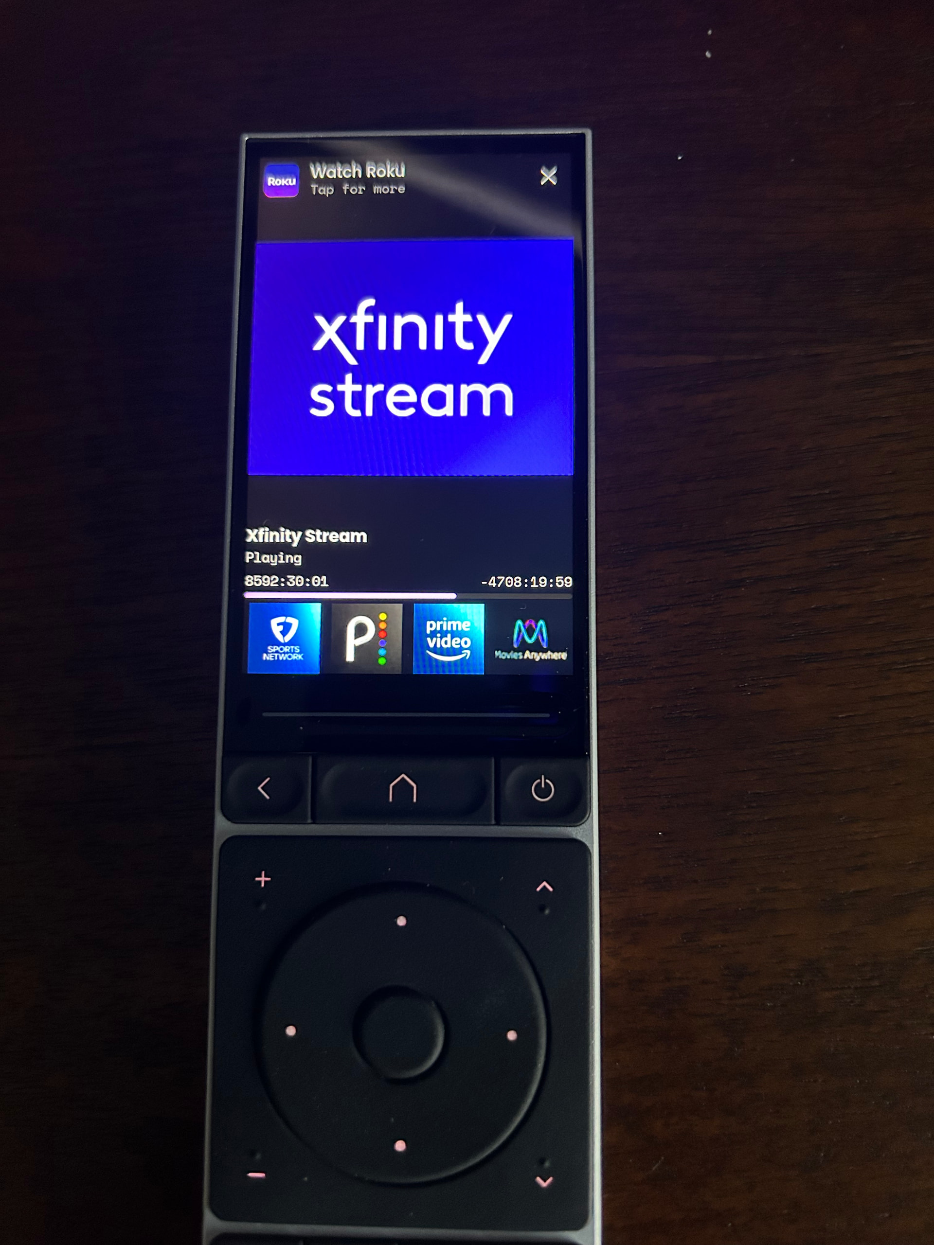

I updated to the Roku beta version and now it shows in the media screen what app I’m watching but no specific app data.

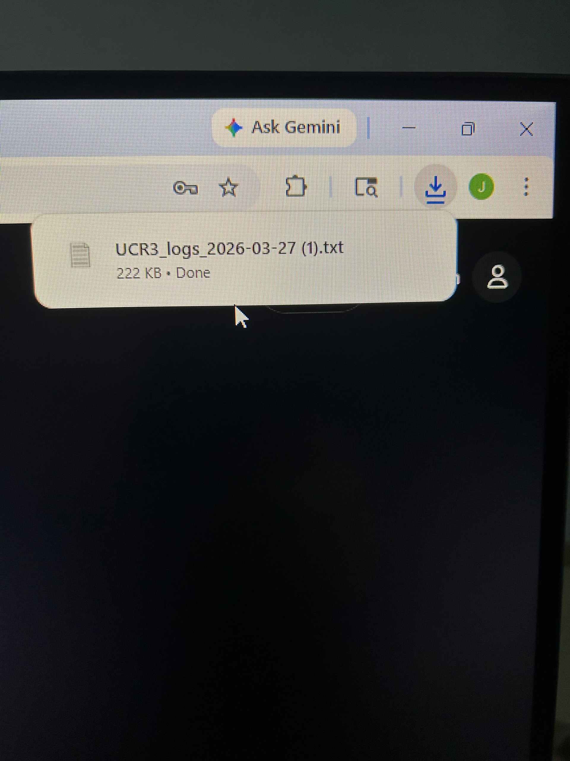

Does this help? Are you wanting the file I downloaded?
If you updated the firmware and now it works, then problem solved, no?
Not completely. I do get the App logo on the media widget now but not the exact content I am watching like I get when using the Apple TV. For example, if I go into the Prime Video App I do not see the movie content in the media widget I see the Prime Video logo only. So better than nothing but was hoping for the actual content to show. The time remaining does not seem to work correctly below the logo image Like the Apple TV media widget shows. I’m guessing this update does not include the media widget update to the extent that was done in the Apple TV integration.
This is a limitation of Roku explicitly AFAIK, same with Android TV for an example. PLEX does show, but Prime and Netflix dont. its a DRM legality issue. That is expected behavior. AFAIK i do not own Roku.
