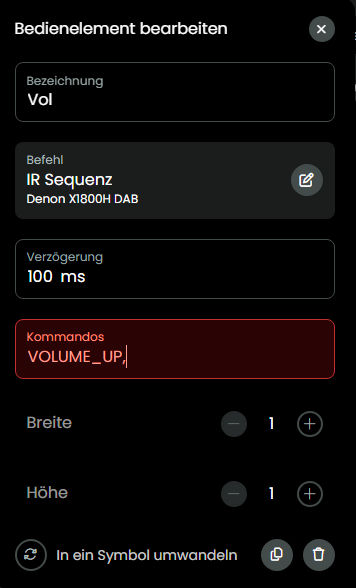

I try to define an IR Sequence inside an activity for an ir entity.

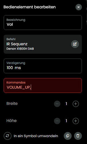

I tried a comma as separator between the commands but i get an red box (not allowed). Although a blank as separator doesn’t work. In both cases i get an red box where the commands are entered.
Example: command1, command2
What is the correct and working separator for ir seqences?
I think it might be a comma and no space.
“Command1,Command2,Command3”
Nop.
With and without a space i get the red-forbidden-box.
Its red because you just entered one command with a comma which is not a valid command. Once you enter another commands its not red anymore

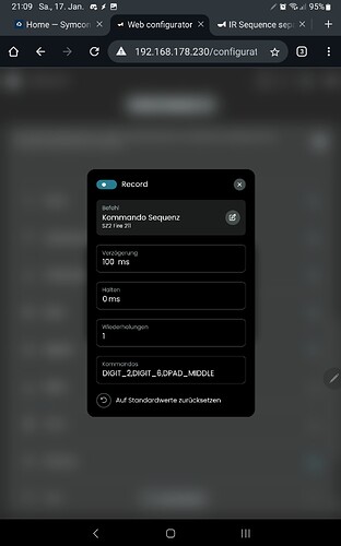

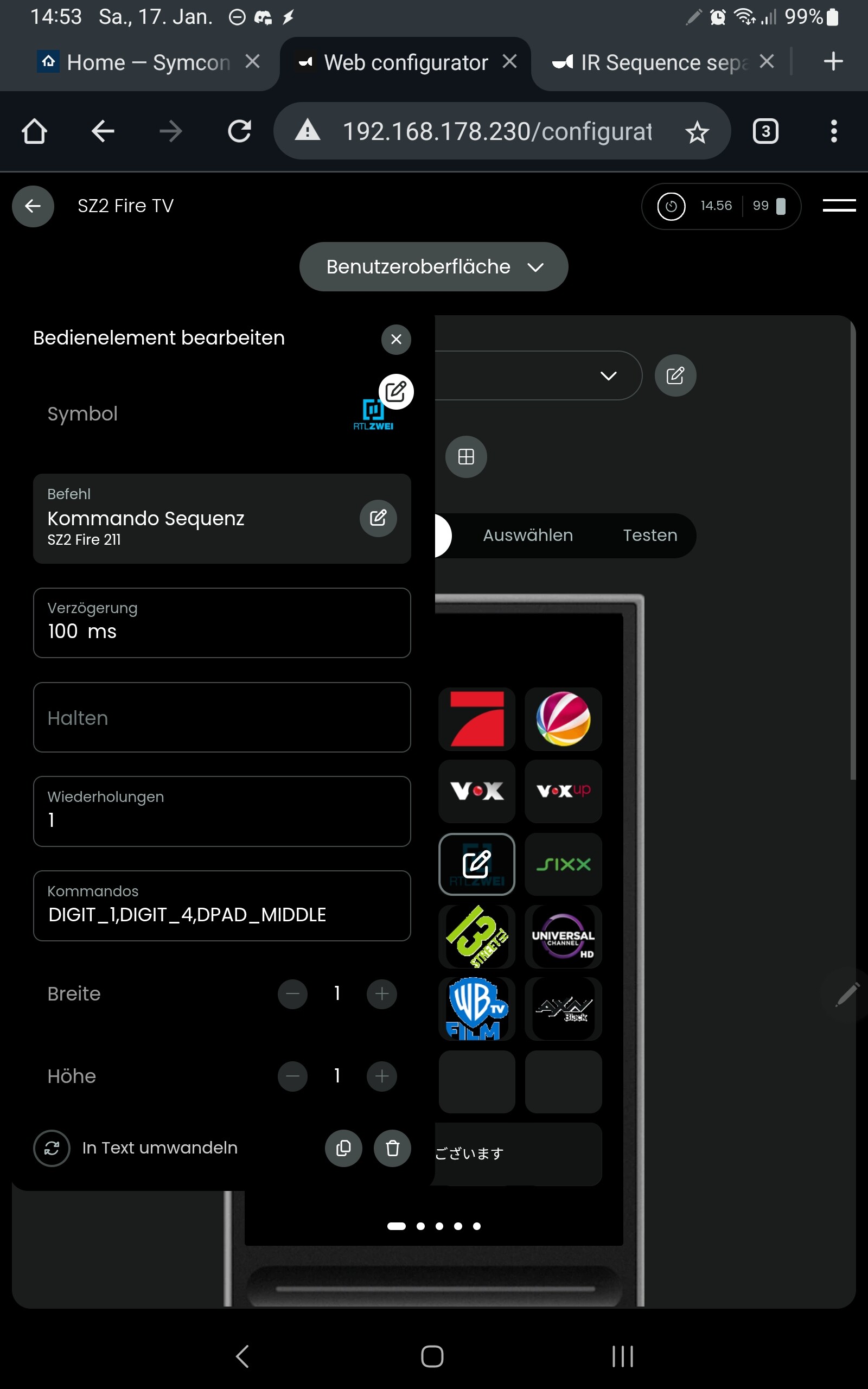

Yes: If i use it on an display-button.
No: If i use it on an fixed key (i.e. volume up/down). Then i get an error-message on the remote 3 when starting that activity.
@kennymc.c
Using it as HarmonyFan wrote (command1,command2,command2) it works but only on display-buttons. Not on fixed keys.

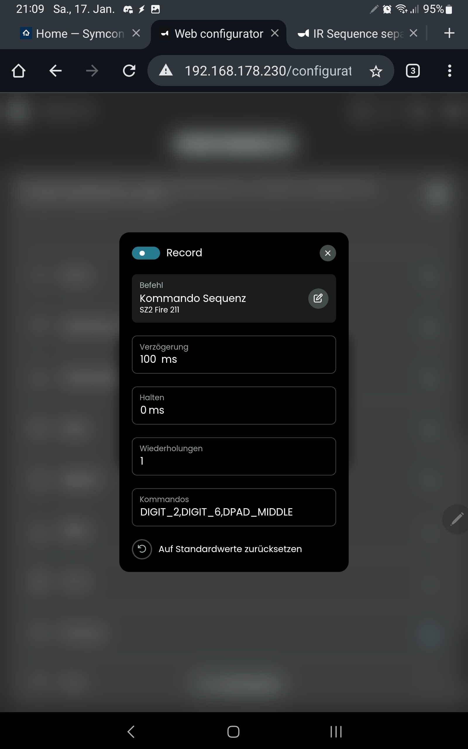

Remeber: I would like to use an IR Sequence with two times VOLUME_UP like this:
VOLUME_UP,VOLUME_UP
Actually such an IR Sequence works, but not 100%. Sometimes both commands are send, sometimes only one command.

I think it is a timing problem. Did you increase the Verzögerung value?
@HarmonyFan
You are my hero.
Changing the delay to 500msec the sequence works like a charm.
Thanks so much.
