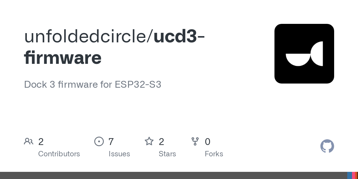

Maybe log a bug here so that UC are more likely to see it?
I’m not sure what else to try, sorry.
It is already known by unfolded circle that IR learning has some problems.
