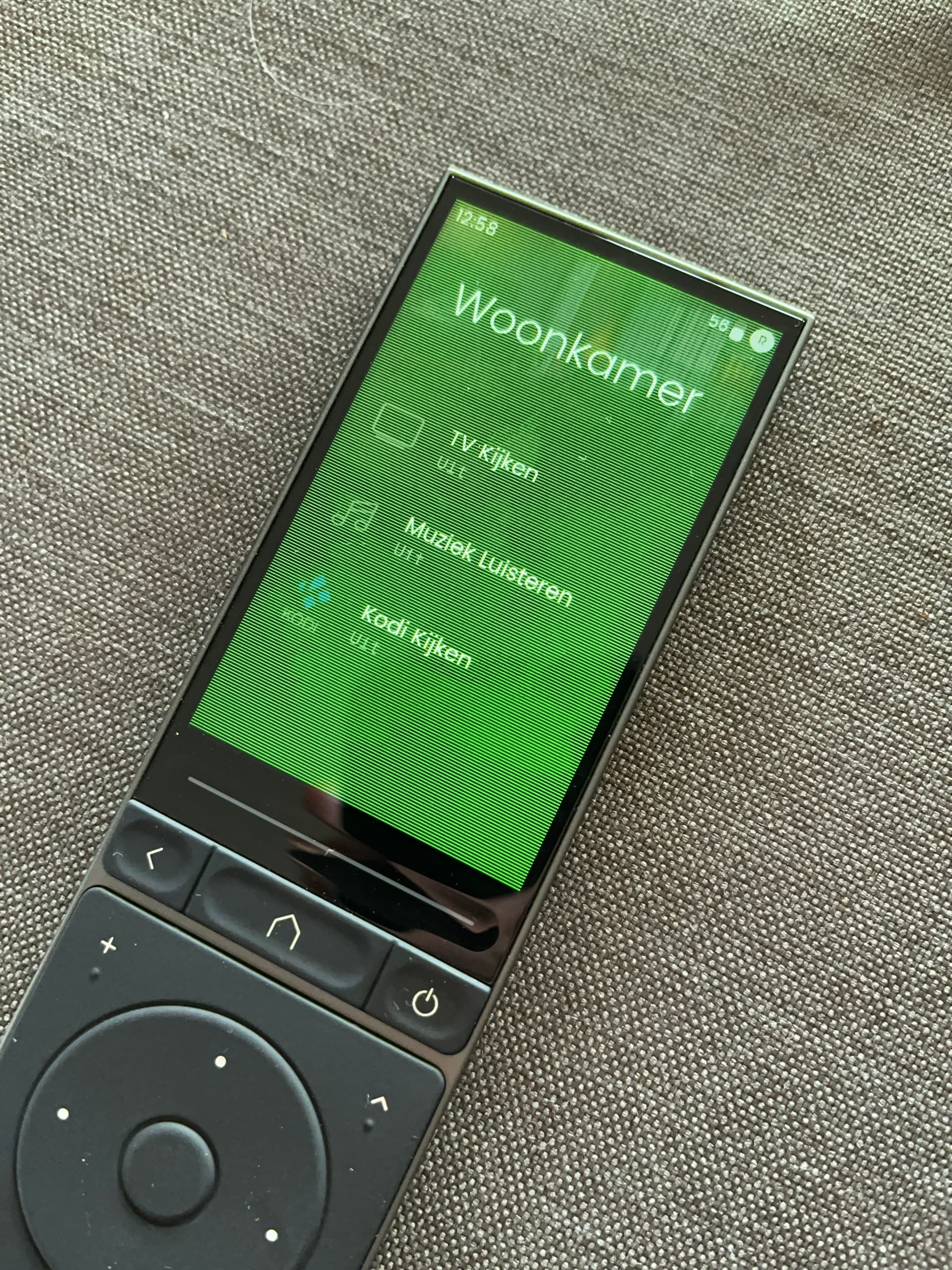

If you mean this special effect :grinning_face: , then that is a know issue. Multiple users have reported it on the Unfolded Circle Discord server:
Restarting the remote, by holding down the power button until you get the restart option, solves it temporarily. I have run into this issue also, but luckily incidentally.
There was also an issue report created for this and other screen behaviors on GitHub:
I had this issue with my R2 / 2.7.0 a few days ago. The activity ui was always closing by itself when I opened it again. Also long pressing the power button closed the power off/restart menu. I could see in the user interface app log that the BACK command was triggered multiple times repeatedly although I didn’t press the button. The workaround to restart the remote was using the restart button in the web configurator under settings/development/preview features. After a restart the issue didn’t reappear.
