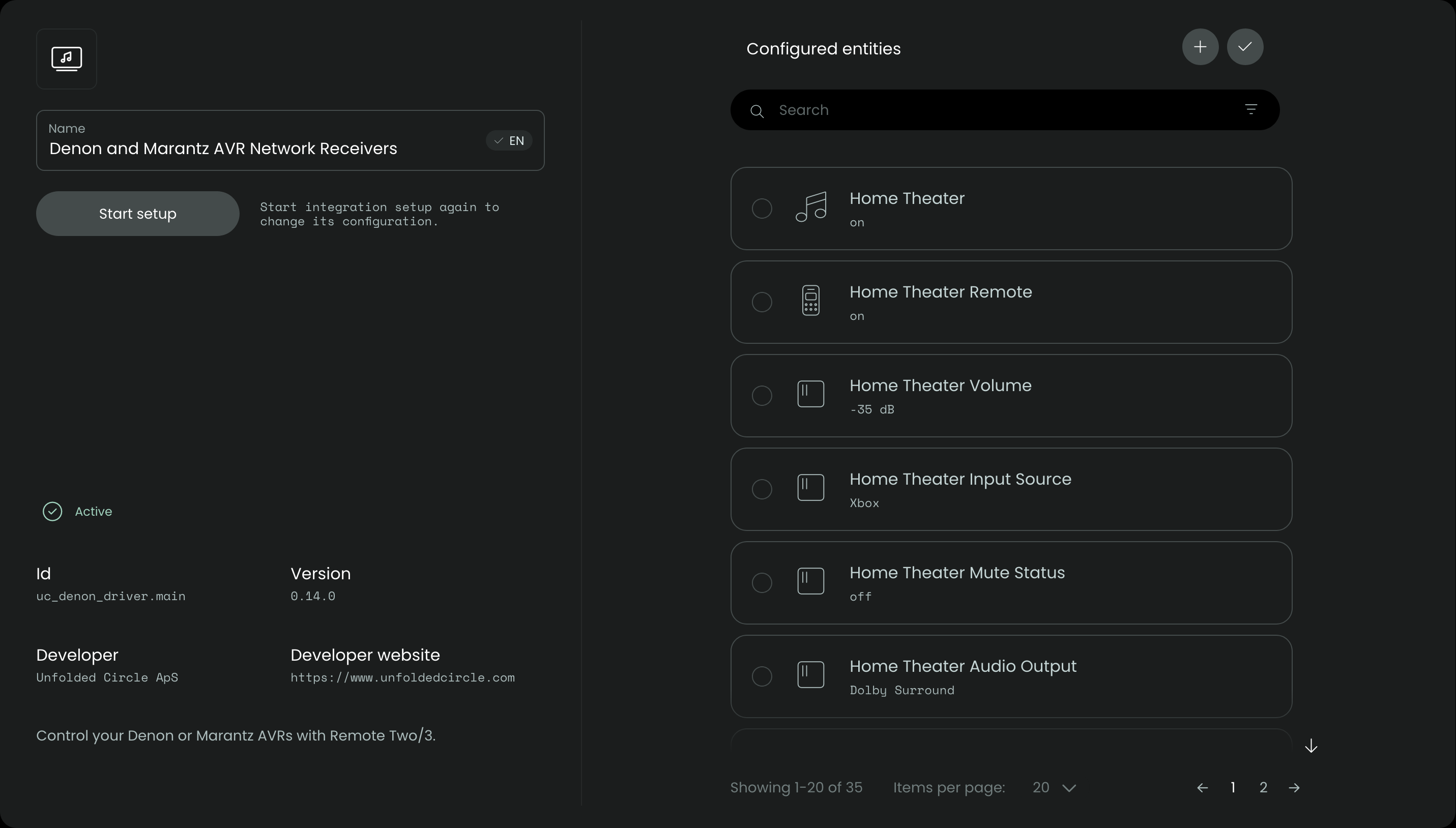

Can you screenshot the integration page for the denon please?
And now everything decided to start working again for some reason. Hopefully it sticks this time.
