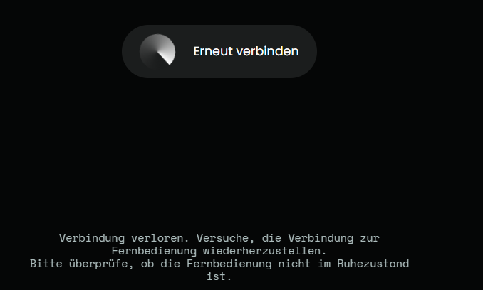

Remote 3 is making me crazy. I now set one accesspoint to Channel 6. The Remote3 is configured to 2,4GHz only. I mapped the Remote to this dedicated accesspoint. And it is nearly impossible to configure the remote via web. The connection gets lost several times within a minute and the browser is just showing:

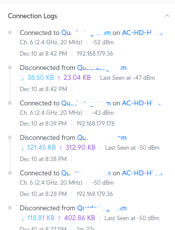

In my Ubiquiti admin-panel I can see it as well: WLAN connection, if connected, is excellent (-48dBm). But still connection is instable:
how do you manage a stable connection?

How can you tell that the connection is dropping? If it’s happening in the web configurator, try temporarily disabling the firewall on that device.
I now have installed the latest beta (2.7.3). The Remote3 now seems to be able to connect to any of my AccessPoints (several Ubiquiti UniFi AC-Pro and AC-HD) - independent to the channel (Remote3 set to 2,4GHz only). Dropping connections seem to be an issue on Windows PC, only. iPad and iPhone are not facing this problem - at least not on such frequency. On a Windows-computer it is impossible to configure the Remote3. I already disabled Firewalls, Virus-scanner, … - no improvement. I tried different browsers as well - Chrome & Edge.
Does anybody have an idea?
How are you accessing the configurator? With the ip or the .local domain? Try to use the IP as this is more stable in most networks.
