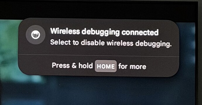

Hey everyone, I recently added the ADBTV integration to be able to switch inputs on my Sony Bravia tv. I’m using the wireless debugging setup which did take me a few tries to setup. It seems to be working for now but on my TV I get this annoying popup quite constantly, maybe every 30 minutes notifying me that “Wireless debugging connected”.
For those of you who also have this setup, do you also have this annoying popup and have you figured out how to get rid of it?

On Discrod I read that the option Wireless Debugging might be rather new. On my devices it is either usb debugging or WiFi debugging and I do not get such message. Among a lot of streaming device I also have a TV (Philips) where I use ADB for input switching. What I saw is some option like time out in developer setting a bit below USB debugging perhaps disable this if present.

I never said anything about USB and dock. Check only settings of developermode again if there is something like time out or similar.

ah, then maybe I don’t understand how usb debugging works since I believe that is what most use. I had though for usb debugging, you needed to be connected via usb physically.
but yes in regards to wireless debugging, I will look for any timeout settings.

USB debugging is what you turn on now. They removed wireless debugging many versions ago, USB debugging covers everything now (outside maybe Bluetooth). Turning on USB debugging and rebooting should bring up a prompt to accept.the wireless connection. This is the same prompt you get regardless if you use ADB from Home Assistant or the community ADB integration. Same peompt.ypu would see if you installed ADB on.a PC. Typically there is a check box to “always trust this device” so it’s a one time thing but I’m not seeing that option, which is why you get it every time something is rebooted.. It also usually shows the certificate number which is very long. Regardless ADB commands won’t work without an active connection. The HA integration just gives confirmation your connected.

USB debugging does not cover all. ADB wireless seems to be quite new and seems not the same as ADB WiFi. I got a box this week where I had to activate ADB Internet to have it wireless.
